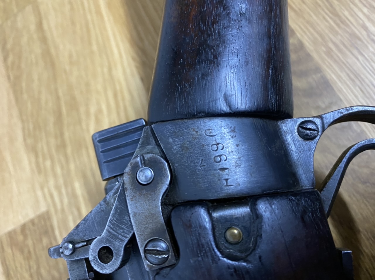

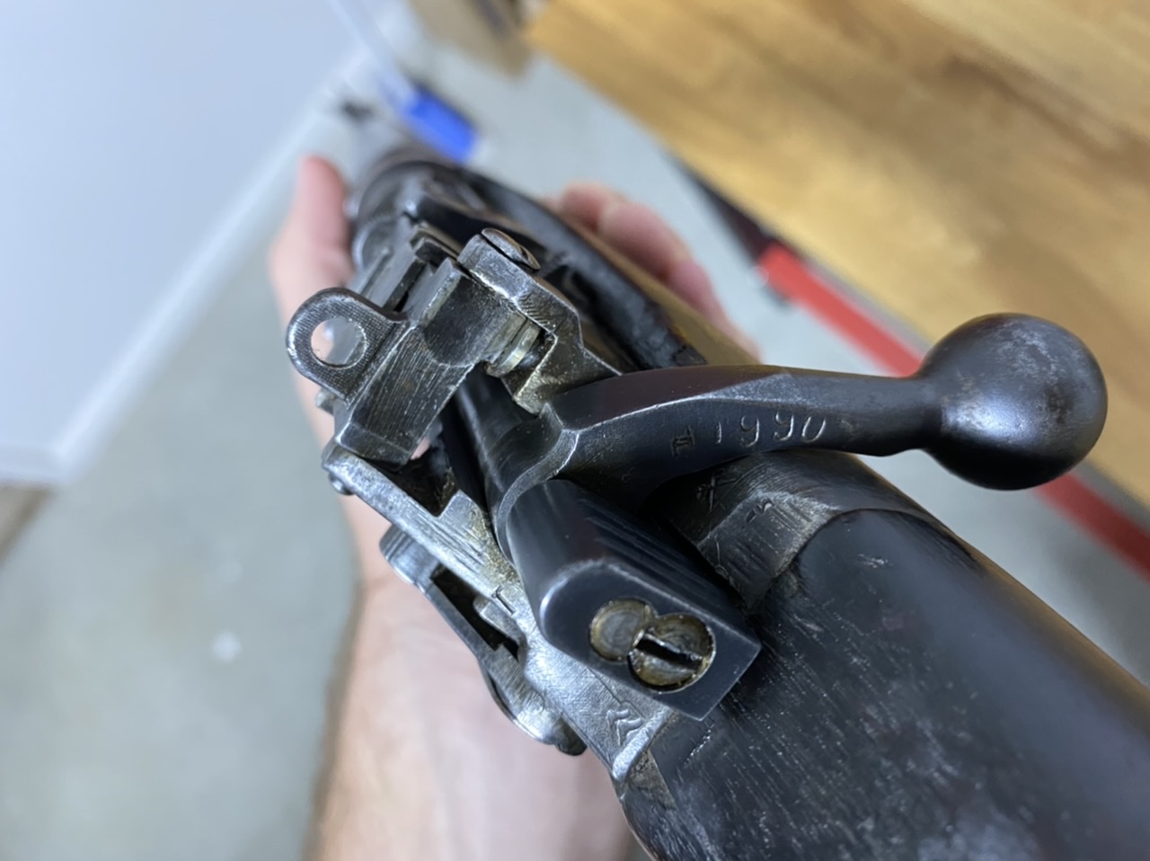

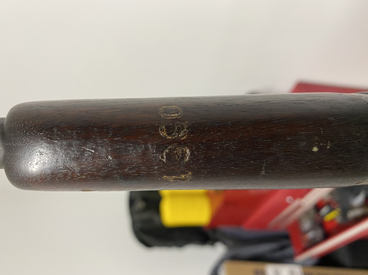

Hey fellas. I’ve finally picked up a Jungle Carbine after wanting one for a very long time. I’m hoping to pick your brain on a few things:
Identification:
I can’t seem to match the serial number H1990 to a production at Fazakerley or Shirley. The usual Enfield identification on the left of the receiver has been scrubbed clean and all I can make out is the very start and end “No.5...........990”. The same serial number is also stamped on the bolt and the stock. The seller seemed to think the rifle may have been used and possibly refurbished in India after WW2. Makes sense to me with the odd serial and missing markings but I’d like to know more. I will attach more photos.
Condition:
Overall very functional condition. Part of me would love to jump straight in and refinish the metal and wood but I know I shouldn’t. The stock is loose, when I hold the rear grip I can wiggle the fore end wood slightly from side to side and up and down. I’ll be doing a tear down soon to give everything a good clean and have planned to space/shim the stock to eliminate the stock moving. Any suggestions on a material that would be good for this? Or if there is a better solution?
Thanks!
JJD

Post by No1Mk3 » 18 Jan 2021, 6:37 pm
G'day JJD,
Re-finishing the metal and woodwork will completely wreck the collectibility and therefore value of your No5. Yours is almost certainly an Ishapore FTR rifle having what appears to be an "Ishy screw" forward of the front trigger guard screw and it is worth carefully examining the butt for Indian stamps. With regard the fore-end, you cannot shim this, the rifles accuracy depends totally on the fit of the action to the socket and body, the draws on your rifle sound like they need replacing and this is a job for someone familiar with the work but if you have good carpentry skills you may try it yourself. It is worth having this rifle repaired, the No5 is great fun and can shoot well when properly stocked up as the so called "wandering zero" does not affect all of them. The wife and I are taking ours to Warnnambool this weekend, as are a few others of the "Order of the No5's" to try our hand against the Mauser fanboys over 500 yards, Any more info/help just ask, I know a few people with No5;s as well as a few ex-armourers, Cheers.
