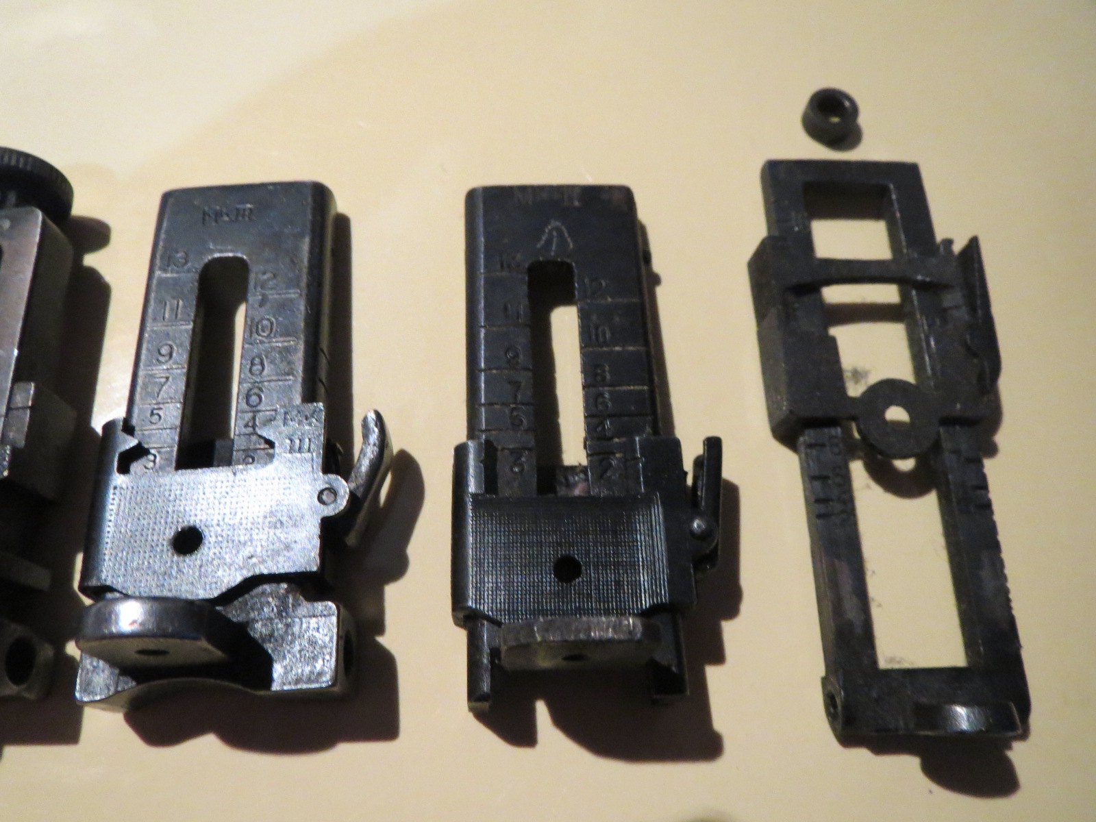

Here are the rear sights but without a Mk2 as I don't have a spare at the moment, plus a variation of the Mk3
The Mk 1, 2,and 4 have 22mm wide bases, whereas the Mk 3, which it sounds like yours is, has a 20mm wide base and a 3mm spacer. the 1st Singer is off aNo5 calibrated to 800 yards and the 2nd is off a No8 calibrated to 100 yards.

Thanks for the pics. And the details. Your right. Definitely sounds like mine is the number 3 with the spacer missing so I just added a custom spacer. So if I have a mark 3 sight , why is my rifle stamped no4 mk 1 ?

British numbering is far from straightforward, the rifles are described by the action type, so your rifle has the Mk1 action which were made in UK, US & Canada, pre-war a Mk1 Singer sight, wartime a Mk2 probably fitted, mid war a Mk3 or Mk4 sight, post war FTR and new production were retro fitted a Mk1 Singer. The same applies to the 4 Mk's of front sight. In Canada and the US a streamlined form of action was developed from 1942 and produced as the Mk2 body and the rifle became the Mk1*, later the trigger mount was moved from the guard to the action body which became the Mk3 body, and the rifle became the Mk2, later the body was streamlined again to become the Mk4, and used on Mk2 rifles from 1955 to 1956. Then we have the No5 Carbine!! I won't muddy the waters further, Cheers.
