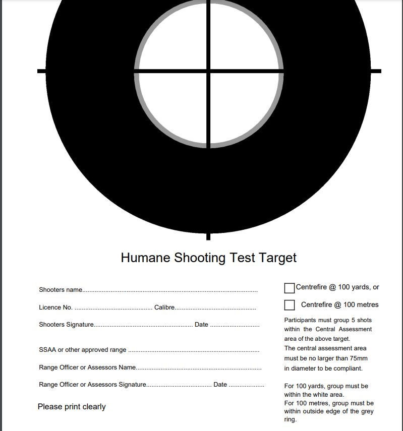

Post by bladeracer » 20 Aug 2021, 3:47 pm
animalpest wrote:Bluehorse - why did you use 6 different rifles to qualify for roo shooting?
He means getting them to shoot sufficiently well to pass the accuracy test.
If I were a roo shooter I'd want to have several of my rifles qualify as well, not just one.
But the roo test is not exactly difficult, virtually any modern rifle should piss it in straight out of the box with factory ammo.
This is the Qld qualifying target at 100 yards or meters, 5rds in 75mm at 100 yards.
Qld Humane target.JPG (69.49 KiB) Viewed 3774 times
https://www.qld.gov.au/__data/assets/pdf_file/0021/68421/humane-shooting-test-target.pdf

It is interesting how many shooters take 2, 3 or more targets to pass the roo shooters test. Inevitably they are using heavy barreled rifles with high magnification scopes.
There is no requirement to have all of your rifles pass the test. Well not in WA anyway. They don't require you to requaulify if you change scope, barrel etc. Note that the QLD target doesn't even list the rifle or calibre.
In WA you are simply required to use the rifle you will use for roo shooting.

I doubt he is suggesting having to re-qualify with different rifles. He just wants to assure himself that the rifles/ammo he might choose to take all qualify for the job.
