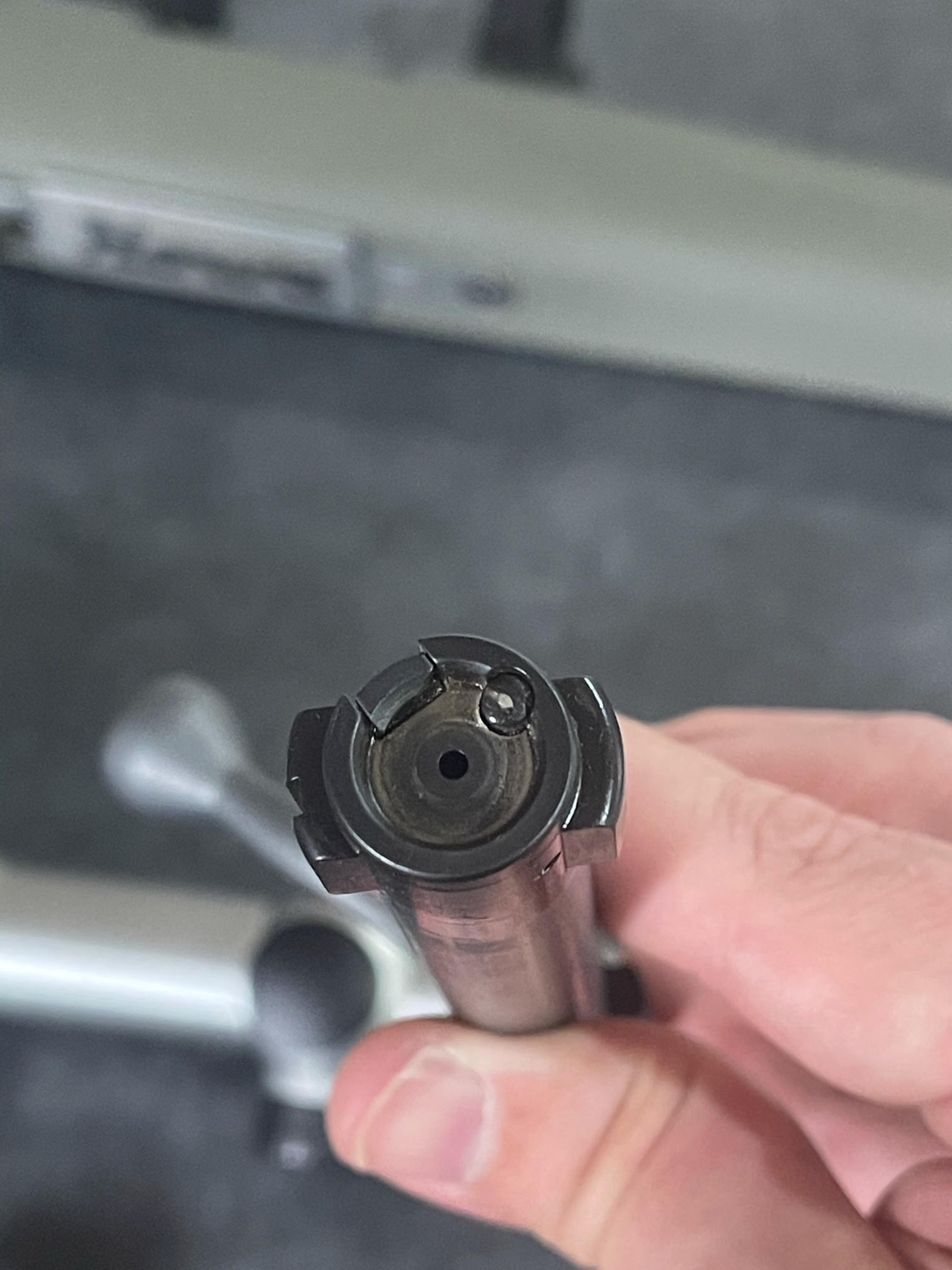

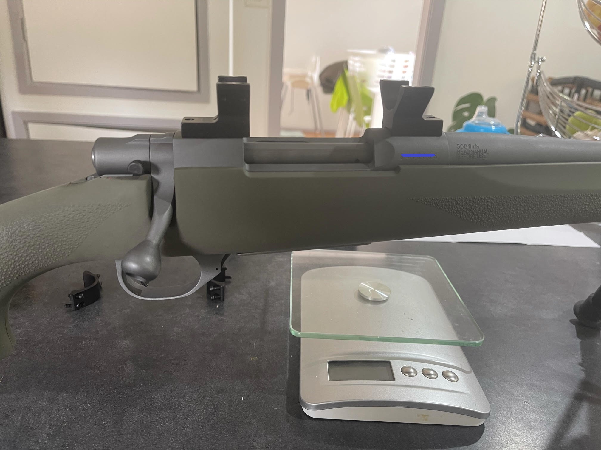

Hi All,
i just bought a pre-loved 308 Howa 1500 - looks ok condition....
I worked the bolt a few times and it was smooth. Dry fired it a few times and now when I work the bolt again it gets very very tight as the end of the bolt/firing pin enters and exits the chamber (see stuck photo). This is all without a round in the chamber.
Is this simply the result of not firing a live round or is there something else amiss?
PS: Anyone have a stab at what model of 1500 this is? It weighs 3kg appears to have a pencil barrel?
Thanks
Rifle
Stuck!

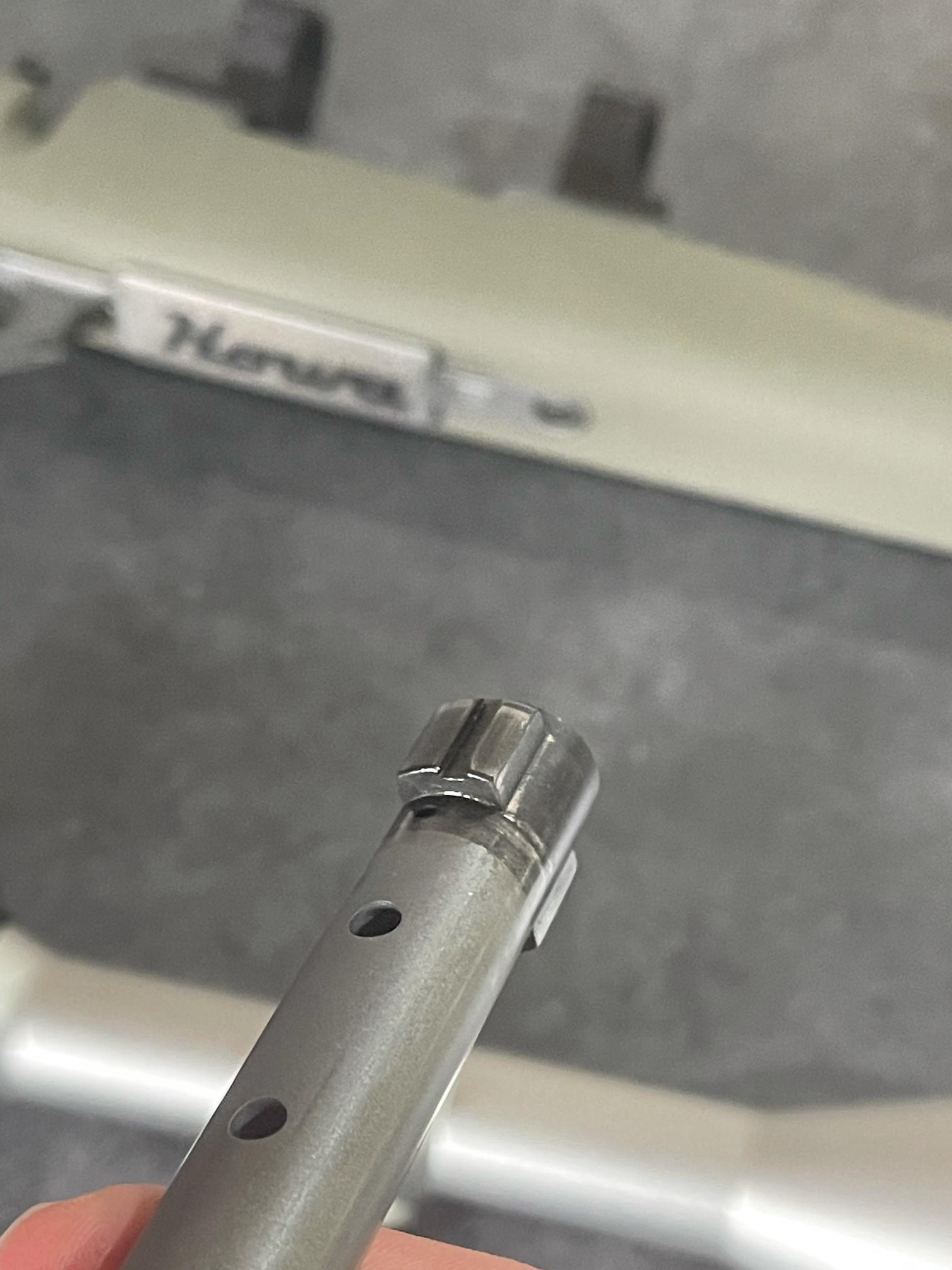

Bolt
unnamed (1).jpg (220.69 KiB) Viewed 9362 times
Bolt / lugs
lugs pin.jpg (218.18 KiB) Viewed 9362 times

Post by Die Judicii » 08 Sep 2021, 7:23 pm
Definitely "used" and quite a few rounds maybe,,, judging by some of those pics.
I've got four HOWAS,,, and never had an issue with bolt tightness as you described it before finding what the problem was.
Except only just the other night,, but that was an individual factory round,,,, and nothing to do with the rifle/chamber or bolt.

Post by Barrettmr » 24 Oct 2021, 4:46 pm
Looks like an ultralite, I have one not the most accurate rifle. The best I did was 1" but generally 1/1/2" at 100m.
By the look of the bolt I recon on about 100 rounds shot, I have shot around 400 and the underside of the bolt is almost silver from the bluing waring off.
Very unpleasant to shoot from bench, but recoil now where near as bad when shooting in the field.
