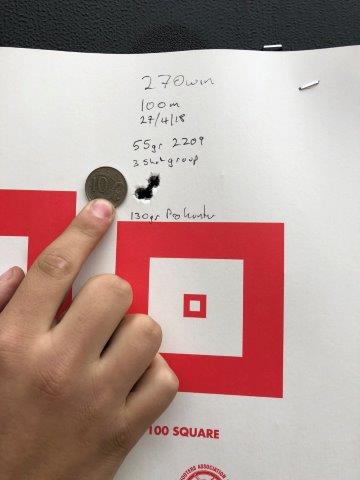

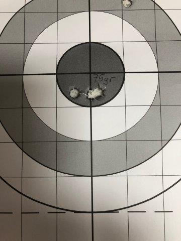

I used to try and get 5 and 10 shot, tight groups, after reading lots of replies on shooting forums. Drove me crazy :crazy:
Most of my larger calibre hunting rifles have lighter barrels, such as the sako Finnlight. I am a hunter, so I need the first shot to constantly hits its mark, maybe a possible second shot.
I now only shoot 2 or three shots and let the barrel cool. Its extremely rare that I get to take a second shot, so MY logic is why shoot 5 to 10 shot strings when in the field I only ever taker one shot.
This is MY experience and MY opinion.
First pic is my 270 at 100 meters
Second pic is one of my 300 Win mag's at 100 meters

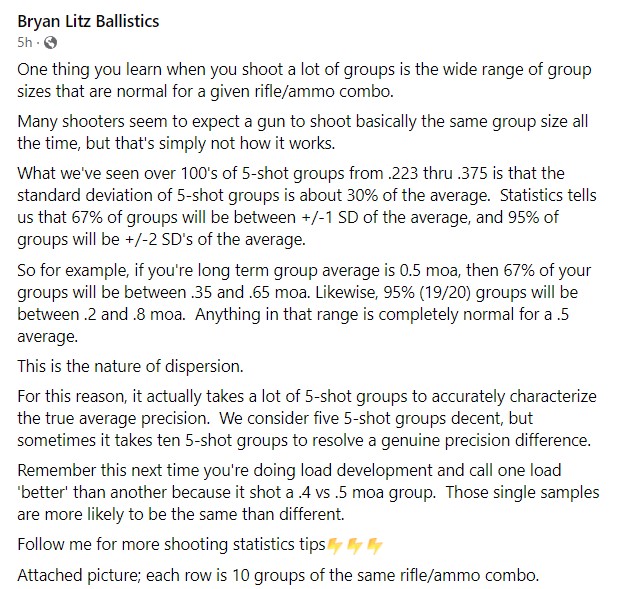

Bryan Litz posted this on FB today, thought it might be relevant here.
Bryan Litz Group Variation.jpg (150.12 KiB) Viewed 5984 times
