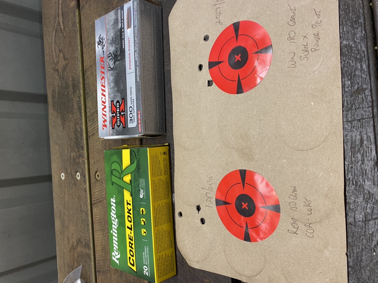

Post by 2 Clicks Up » 19 Jun 2022, 5:05 pm
UPDATE: took this “shot out” beast out for a shoot today. Sighted in with that Remington rubbish on the left. A bit of load development before I write this one off I reckon.

Post by Peterwho » 19 Jun 2022, 11:33 pm
Looks like you might have got a bargain. You see more than a few 300 win mags for sale that haven’t done a great work. Great cartridge but can bite a bit without recoil pad/brake/training.
