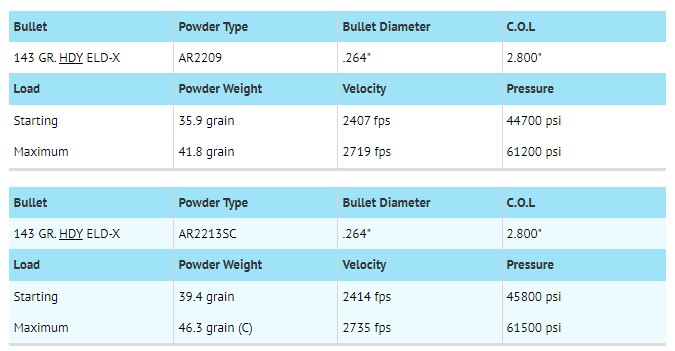

Hi All
I am looking for advice for load data for a 6.5 Creedmore using AR2209 and 143GR ELD-x Projectiles, and advice will be much appreciated.

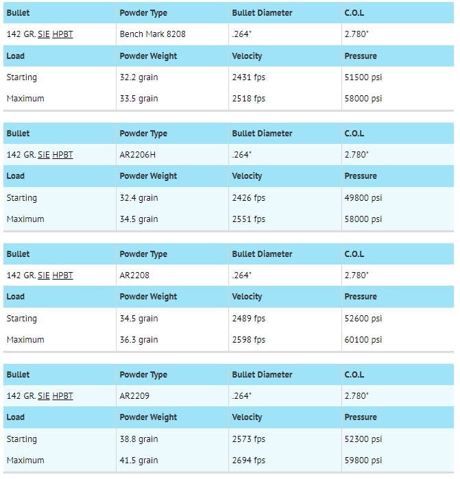

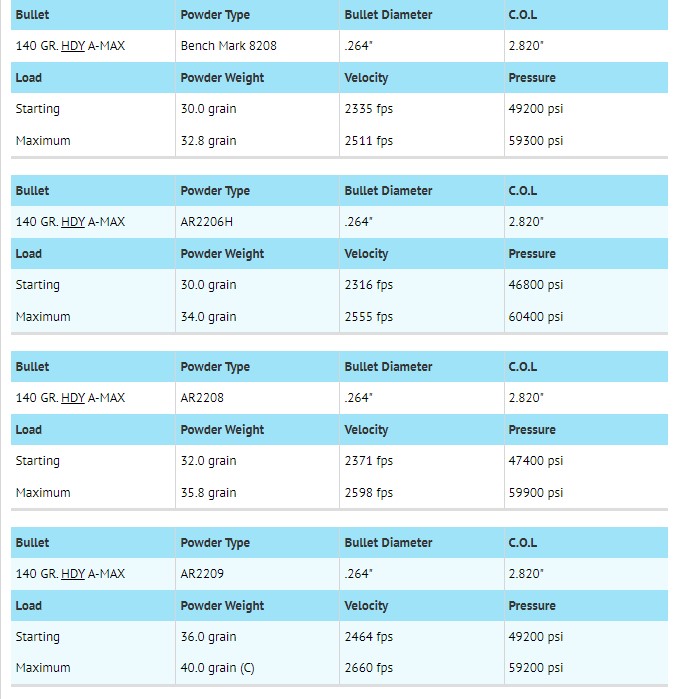

Any data for 140gn jacketed bullets is fine. With AR2209 you'll be working in the 36gn to 42gn realm depending on how long you can seat the bullet. AR2209 is sold in the US as H4350 so there will be lots of data around.
Screenshot 2022-11-19 192139.jpg (100.75 KiB) Viewed 3586 times
Screenshot 2022-11-19 192154.jpg (99.69 KiB) Viewed 3586 times
Screenshot 2022-11-19 192209.jpg (51.52 KiB) Viewed 3586 times

Mate I load these exact projectiles out of my Creedmoor using 41.5 gn of AR2209. I have the projectiles seated at the advertised COAL. Rifle is a Sako A7, load is very accurate.
