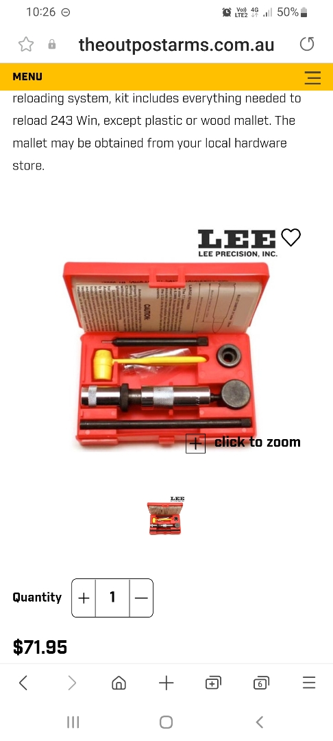

If you aren't set up to reload and don't want to spend a small fortune doing so, you can buy a .243 Lee Loader for around $70, It'll pay for itself pretty dam quick and give you better than factory ammo :thumbsup:

If it's any help, I started out with the lee loader and slowly added a few bits like a beam scale and tools to prep brass. The budget kit enabled me to develop sub .5 moa rounds for both the .243 and the .223
Thousand's of loads later and im still using those little lee loaders to this day, I just haven't found the need to upgrade to a press.
