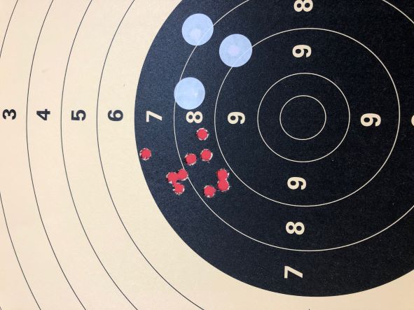

I am interested into one of those AIA Lee Enfields, in particular the one that looks like a No4 in the below picture:
https://www.thefirearmblog.com/blog/wp- ... ressed.jpg
Now, I have owned another AIA in 308w in the past, the M10-B sporter version, and I despite the fact that the rifle was like brand new, I was quite disappointed by a few things:
- heavy weight
- still lots of recoil despite the weight
- terrible trigger (disapointing on a newly made rifle...)
- very average accuracy, the thing was grouping 10 shots in 5 cms at only 50 meters, despite the presence of a good Bushnell scope. (ADI factory rounds).
50m scoped 10 shots - Copy.jpg (44.07 KiB) Viewed 8673 times
Which is disapointing in my books for 50 meters, so It's one of the very few rifles I have ever sold!
I am about to try the AIA experience again but I would like to know if there are some AIA owners here who can talk seriously about their accuracy.
Not interested in the rumours/assumptions, just would like to hear about actual accuracy testings from owners, if any?
Cheers !!

Re: AIA M10 No4 Mk4 in 308W - how accurate? REALLY
Post by bladeracer » 27 Jan 2023, 1:19 am
I agree, that does seem poor with a scope.
Did you try different ammo and bullet weights?
Posts: 14010

Given that you have now sold that rifle, but seem to want to chase another one, I think you should dive in and get one.
When you've got it, spend a great deal of time either testing with all types of commercially available ammo, or develop a hand-load that achieves the group size you want.
Case in point - I have (nearly) finished developing hand-loads for my 1907 M96 swede which is now putting 10-shot groups into 50 mm, from 100 mtr, with my 70 plus year old eyes and "as issued" open/iron sights. The test loads have never benefited from 'scope use.
If you're using a 'scope, you should be able to do at least as good as the swede.
Post by in2anity » 27 Jan 2023, 8:21 am
Sorry but not good enough. A competitive No4, irrespective of chambering, needs to put all shots 2->12 into 1” at 50m. Sighters from cold/clean will often be a bit weird, but yeah she should settle.
Btw I don’t trust those no drill mounts. And presuming you are capable of shooting sub moa front the bagsz
Posts: 3105

Post by in2anity » 27 Jan 2023, 8:44 am
Hate to say it but most Lee Enfields aren’t very consistent. Yes there are diamonds in the rough, they excel above the pack, but most won’t group much better than 3moa, which frankly isn’t good enough to take home the gongs in a service match (that includes an accuracy component). It’s why many good service shooters opt for a Mauser - generally way better accuracy.
Posts: 3105
