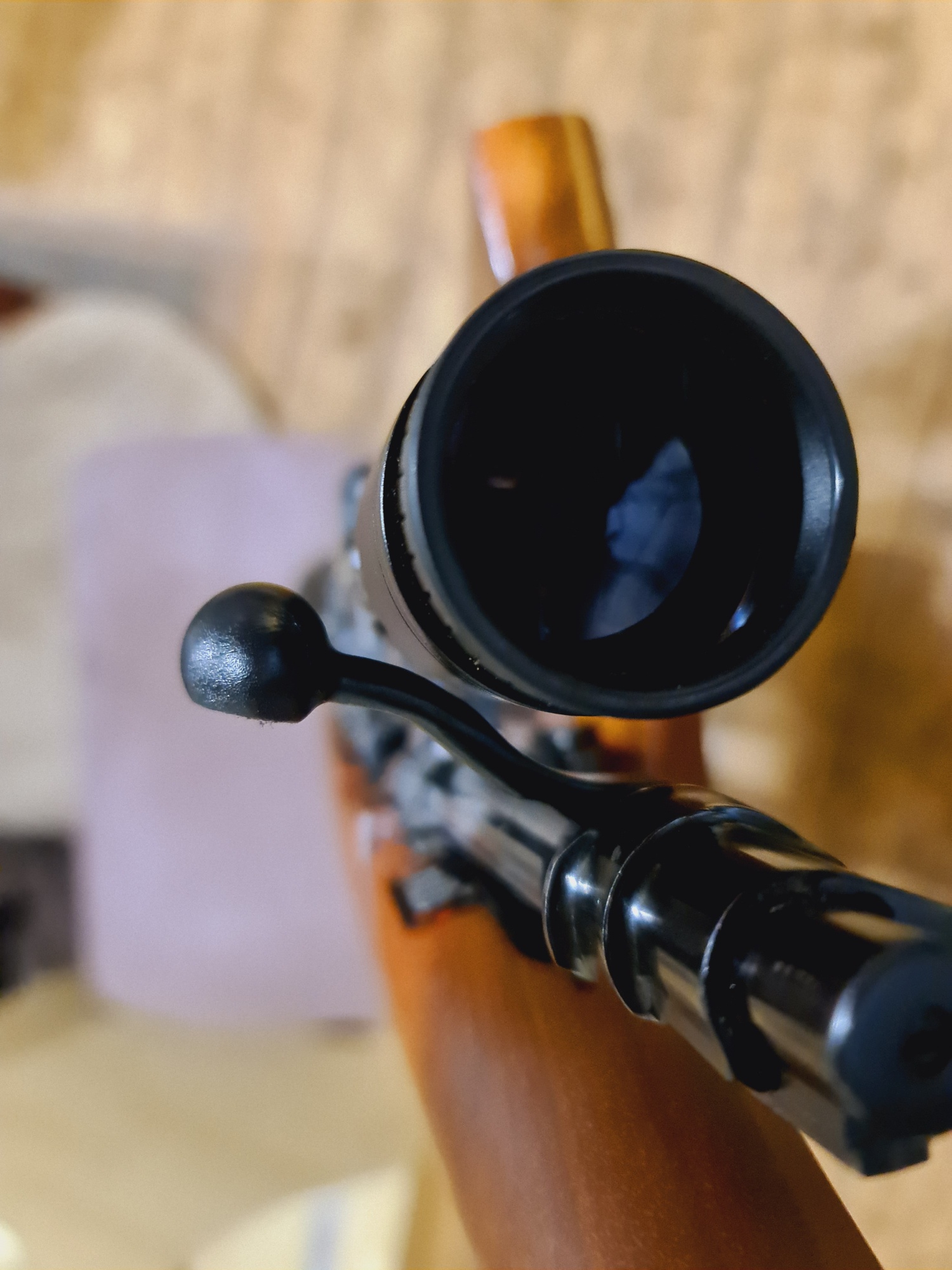

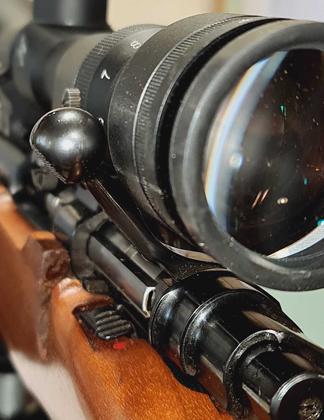

G’day Guys,
I bought a Zastava LKM85 .223 and the bolt only just clears the scope. It’s a pain to operate. Is there a ‘skinny’ scope to create more clearance or has someone modified the lever?

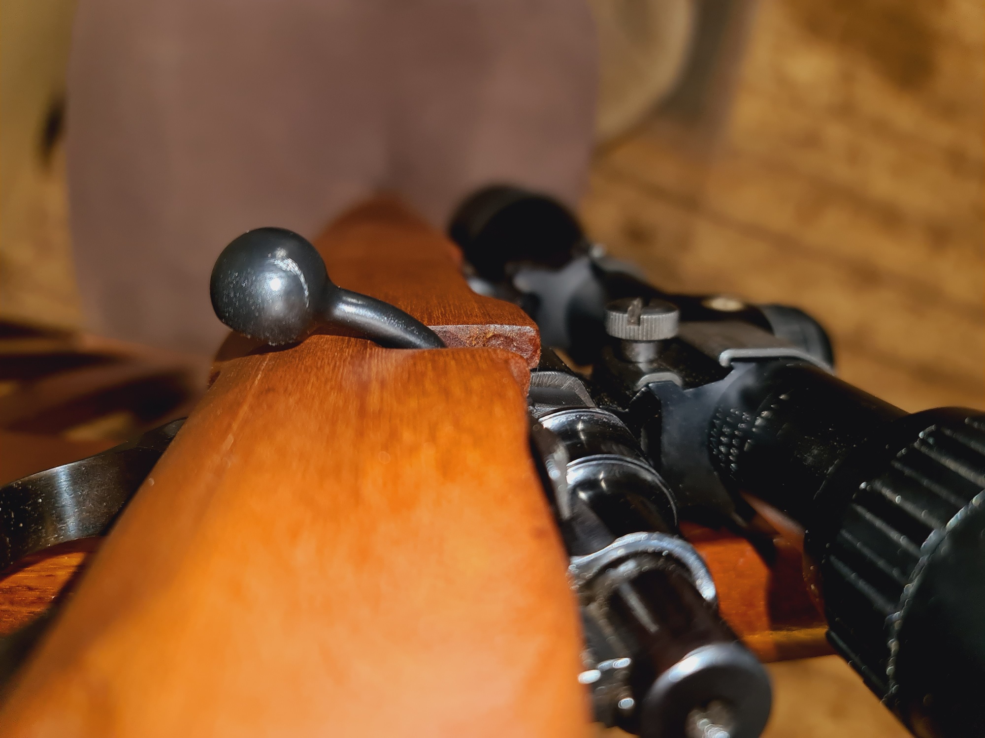

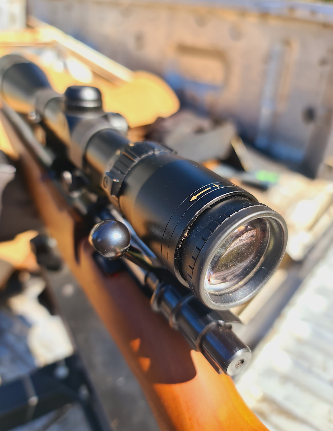

Post by AlHow » 01 Sep 2023, 6:42 pm
I have a Bushnell elite 3200 5-15x40 that was bent. I have managed to straighten this out. Works perfect. It is very slim at 40mm. It has given me more room. I will still have to do a ‘cut n shut’ on the lever.
AlHow
Posts: 52
Re: Zastava M85 bolt lever clearance.
Post by AlHow » 01 Sep 2023, 7:15 pm
in2anity wrote:Taller scopes create problems in other areas if you don’t have a cheek riser solution. Get a machinist onto it i say
Yeah mate, it does have a reasonable cheek weld. It won’t give the clearance required, but thanks for the thought Blade.
AlHow
Posts: 52

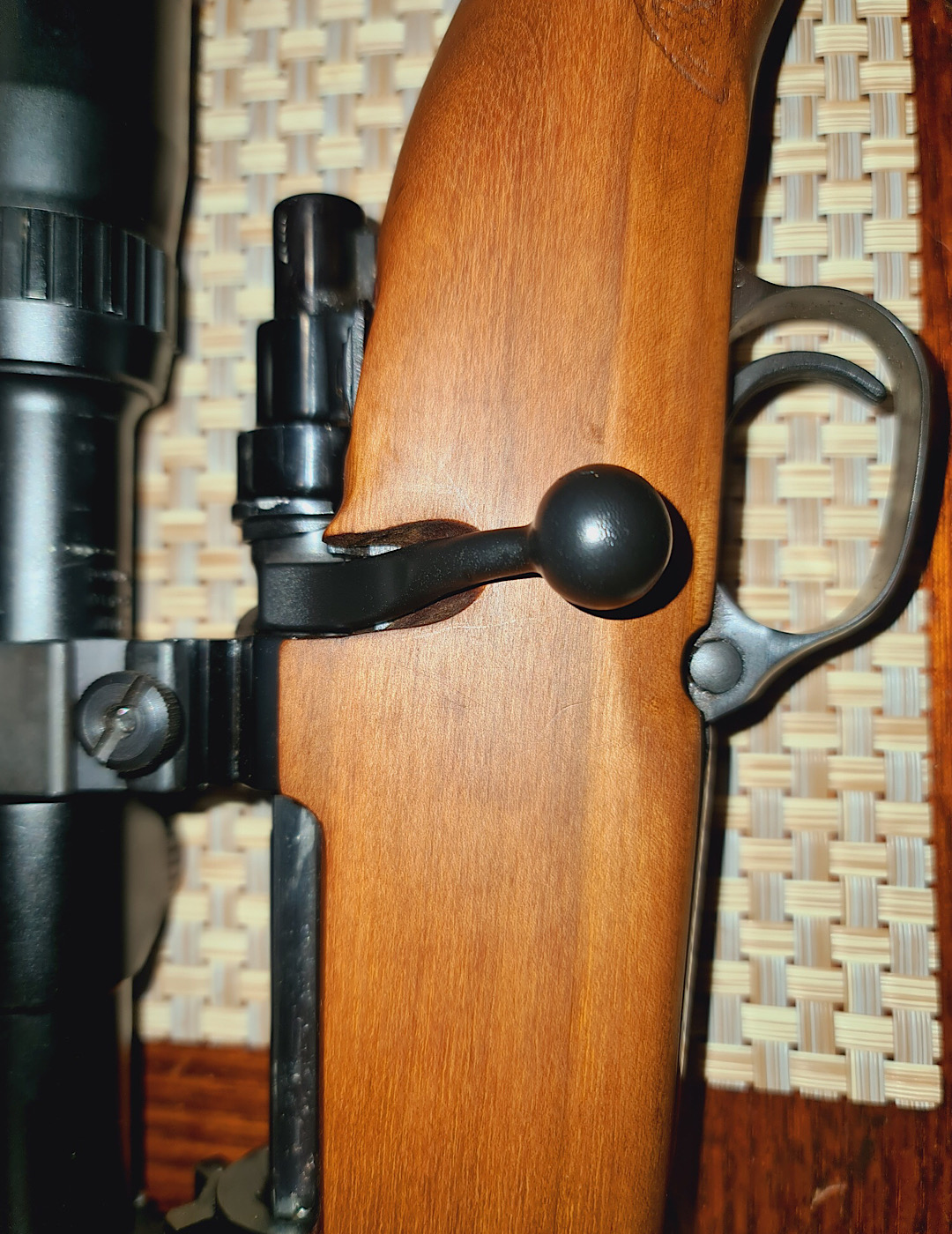

Post by AlHow » 06 Sep 2023, 1:18 pm
Fixdit.
I cut n shut the bolt lever on an angle. Works perfect.
