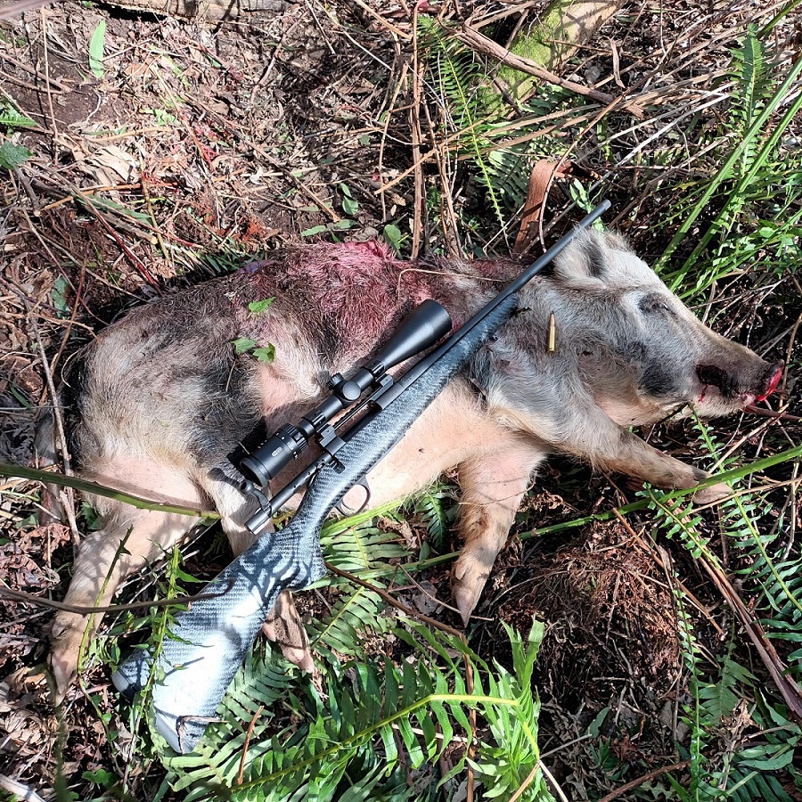

Been hitting my mates small farm when ever I can recently, Almost walked on top of a mob of sows and sucker yesterday.
Managed to stick holes in 3 of the sows, it then took more than 20 mins just to even find 1, the blackberries sure do suck in the gullies. Bonus for the trip the neighbour was pretty impressed with my efforts and has given me access to his place for pigs, fallow and reds.

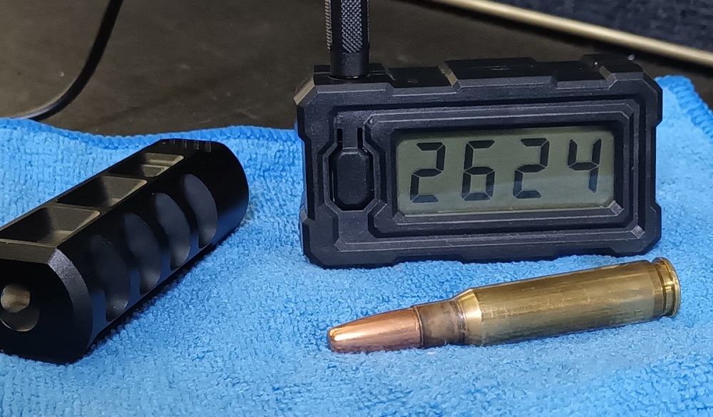

So I wanted to try a muzzle brake on the Super lite to see how it dealt with the rather heavy and brisk recoil and I gotta say it cut about 70% of the recoil and it feels more like a 223, now the noise is another thing :lol:
I also took the opportunity to try a some Leverevolution powder I normally use in my 6mm ARC and boy was I impressed, no pressure signs at this stage and it comfortably pushed the 185gr along at 2624fps, good news is the ES was half what 2208 was producing with this rifle. Found a nice fat accuracy node too, I'll do a bit more fine tuning and throw another 1-2grs in the case as it still has plenty of space.

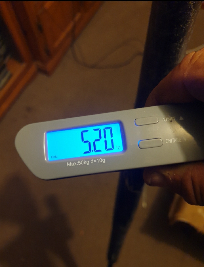

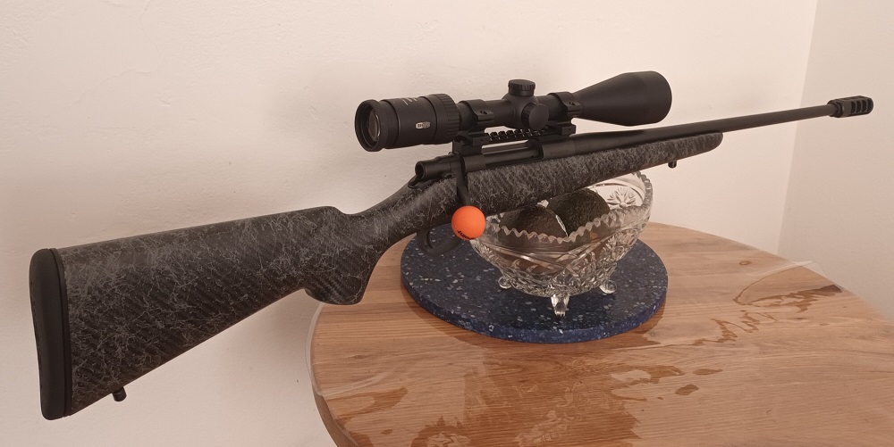

Post by bigpete » 24 Aug 2023, 7:10 pm
Well there ya go.
Howa superlite in 308w, fitted with a Leupold vx1 2-7×33 in Talley 2 piece rings. 5.2lb empty.
Posts: 4175
Re: Howa Supalite 308 Win
Post by Oldbloke » 24 Aug 2023, 7:35 pm
5lb 2oz is excellent. That's about 1.4kg (2lb 14oz)less than my 8lb 30.06. I went on a diet and lost 6kg. Lol Just another way of doing it I guess. Lol.

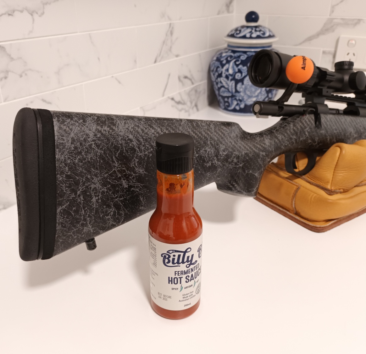

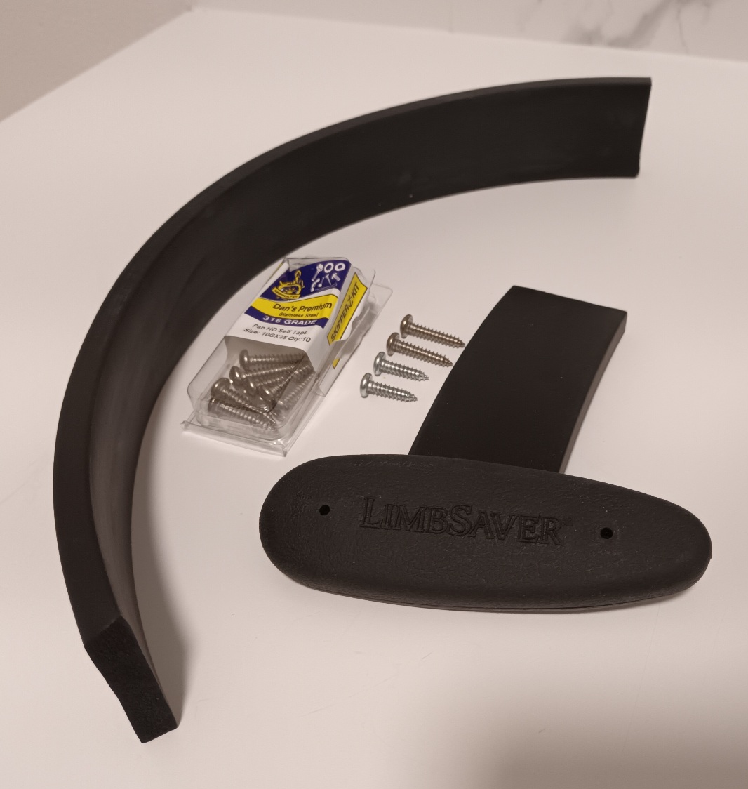

I made a 10mm Recoil pad spacer today for mine, makes the LOP now perfect, used a high density closed cell foam, rated to 130C.
if ya interested I can whip 1 up for you, its basically an aerated rubber product and has some a little extra recoil softening properties.

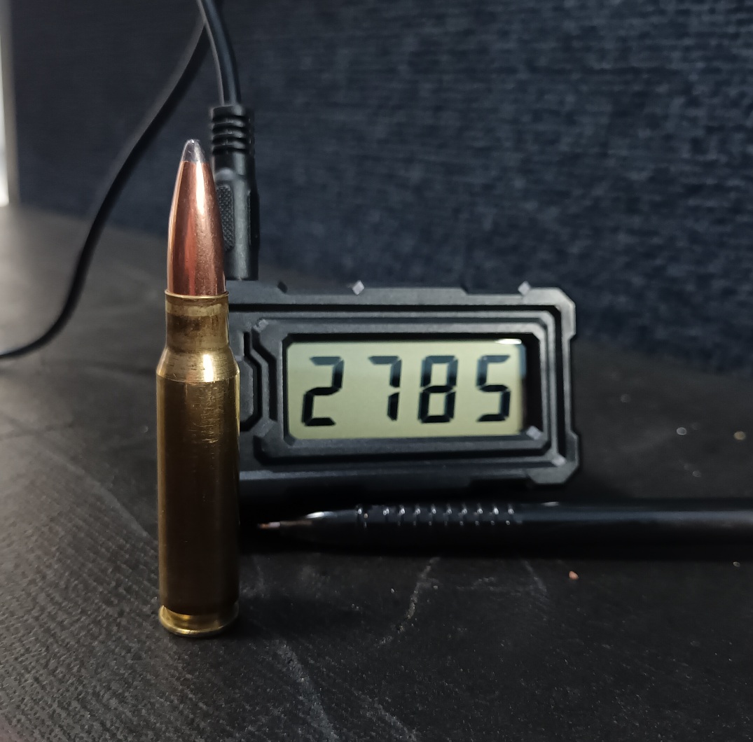

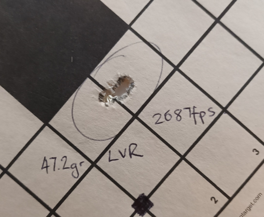

So I put a bit more effort over the weekend into tuning a nice hunting load with the cheap Speer 165gr Hot Cor's, started by using the same loads I used with the 185gr mega's and then I bumped it up another gr or so, still no signs of pressure anywhere ( top speed was a nice 2785fps). :D
Found a nice accuracy node at 47.2gr with 3 bullets going 2688, 2687, 2687fps. With a spread of only 1fps I knew I was onto a good thing. Confirmation once I unstrapped the Magneto speed, not only does the Howa make a very fast barrel but tonnes of accuracy for a such a light profile. :drinks:

2785fps is hooting along ! What powder are you using ?

Post by Billo » 31 Aug 2023, 9:04 am
bigpete wrote:2785fps is hooting along ! What powder are you using ?
Leverevolution,, no longer sold n Oz cause Winchester are retarded, it adds 100-200fps over ADI powders, a progressive spherical powder that tends to favour heavy for calibre bullets, turns the 308 into a 30-06. I
I could have put another grain into the case and cracked 2800fps but I didnt see any point :thumbsup:

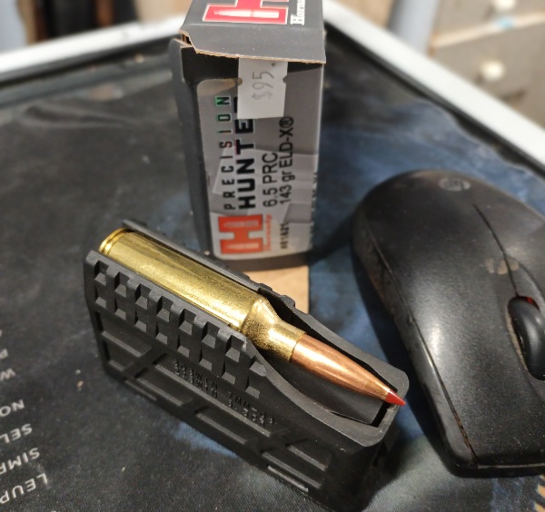

The other option for more power is to ream out the 308W to 300 RCM, which was designed to work with a 20 inch barrel and offer 30-06 performance.
And yes it would work, 6.5 PRC and a 500S&W case below to give you an idea or 3 :lol: . Obviously you would go back to a 2 shot mag.. :thumbsup:

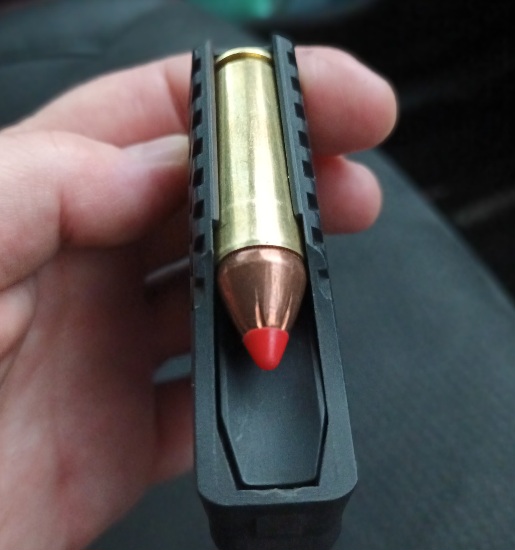

I was sent some Hornady 190gn Sub X projectiles by a mate in Queensland last week. They arrived yesterday,and as I had the day off due to the weather, I loaded them up over 10.5gn of trailboss and gave them a quick test out at my dads farm. Definitely quiet,grouped pretty well ( although it was 3 shots at 40m off the shoulder so can't really be counted ) and are definitely frangible at that speed. Will definitely be getting used for sound sensitive areas and for my son to transition to bigger rifles on.
