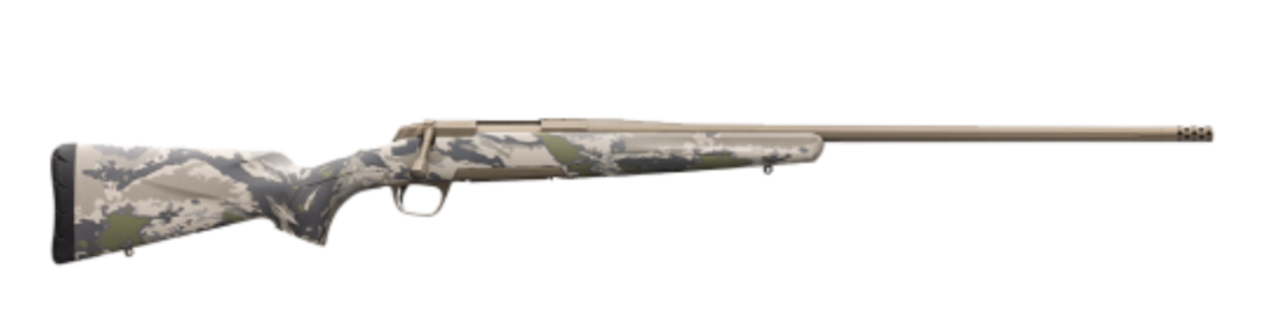

Post by MG5150 » 14 Jun 2025, 1:12 pm
Oldbloke wrote:If you post the brand/model here, perhaps a member has same.
Browning X-Bolt (Speed Ovix)
Screenshot 2025-06-14 at 1.12.13 pm.png (214.84 KiB) Viewed 27 times
