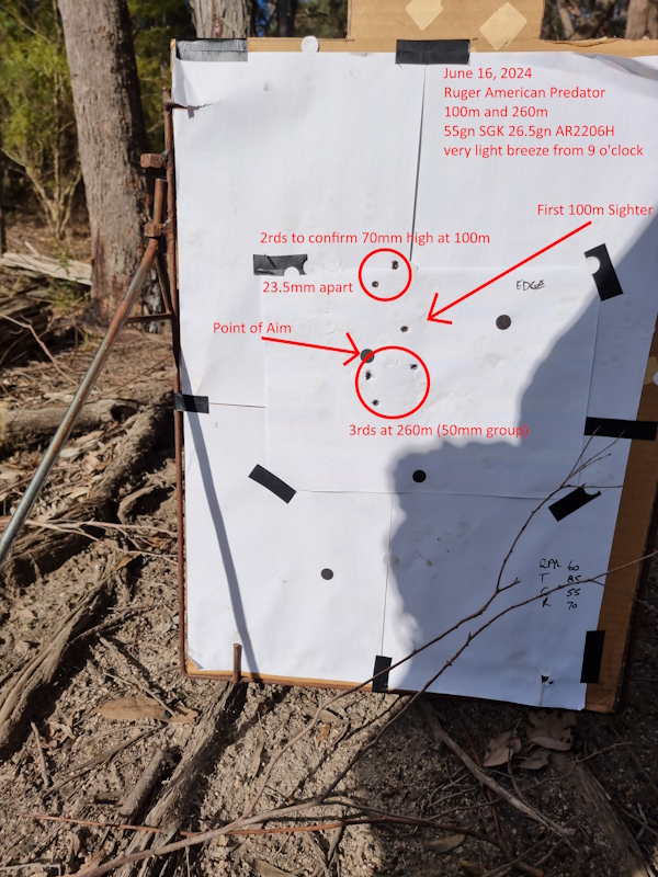

I use the 55gn Gameking, very cheap bullet, especially if you buy Cleaver's bulk specials when they have them. I zero 70mm high at 100m. At 260m it's 30mm low. 26.5gn of AR2206H at 2.290", making 3325fps if full-length sized, or 3235fps if only neck-sizing.
Screenshot 2025-07-08 213405.jpg (78.32 KiB) Viewed 3459 times
