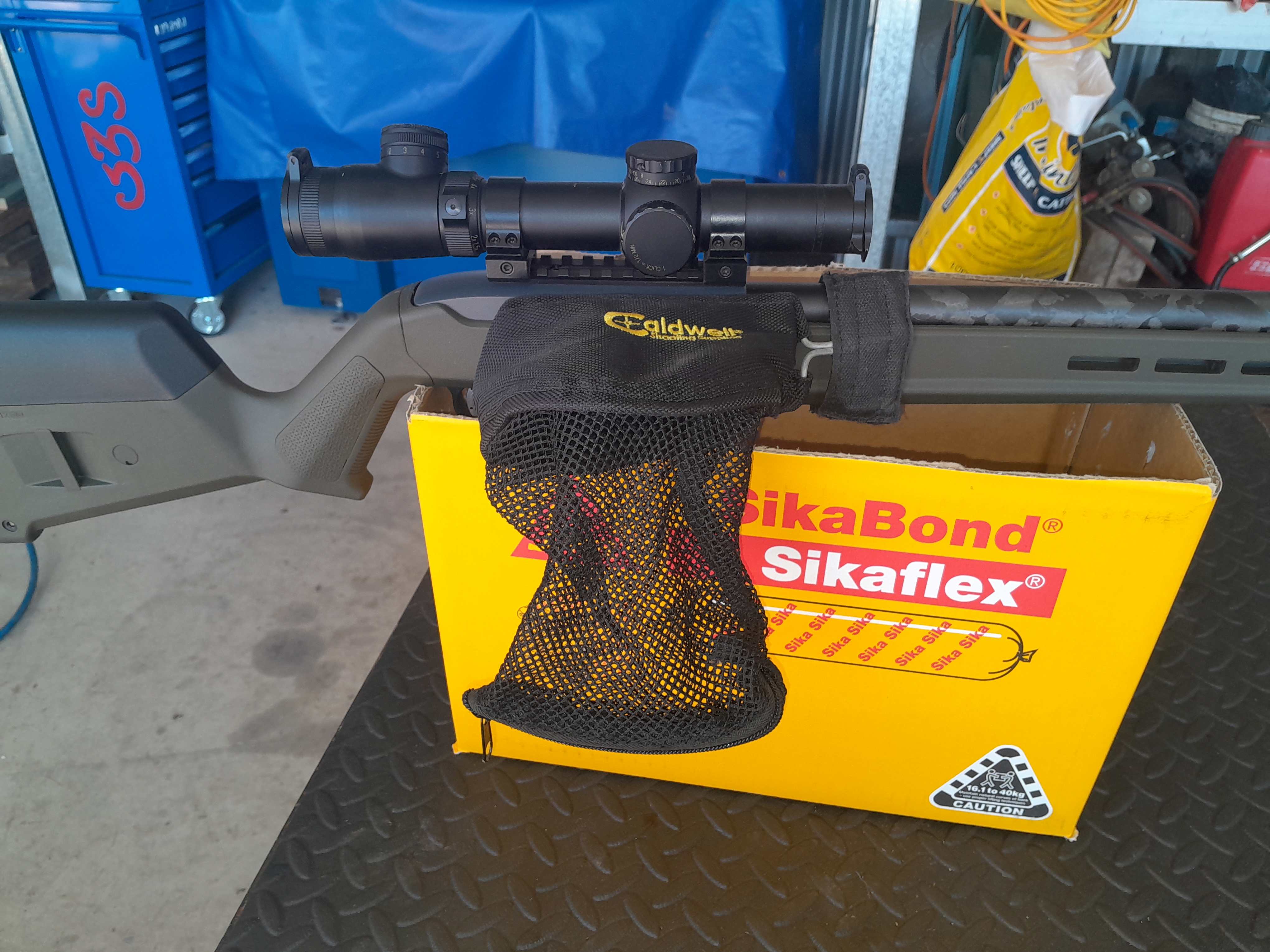

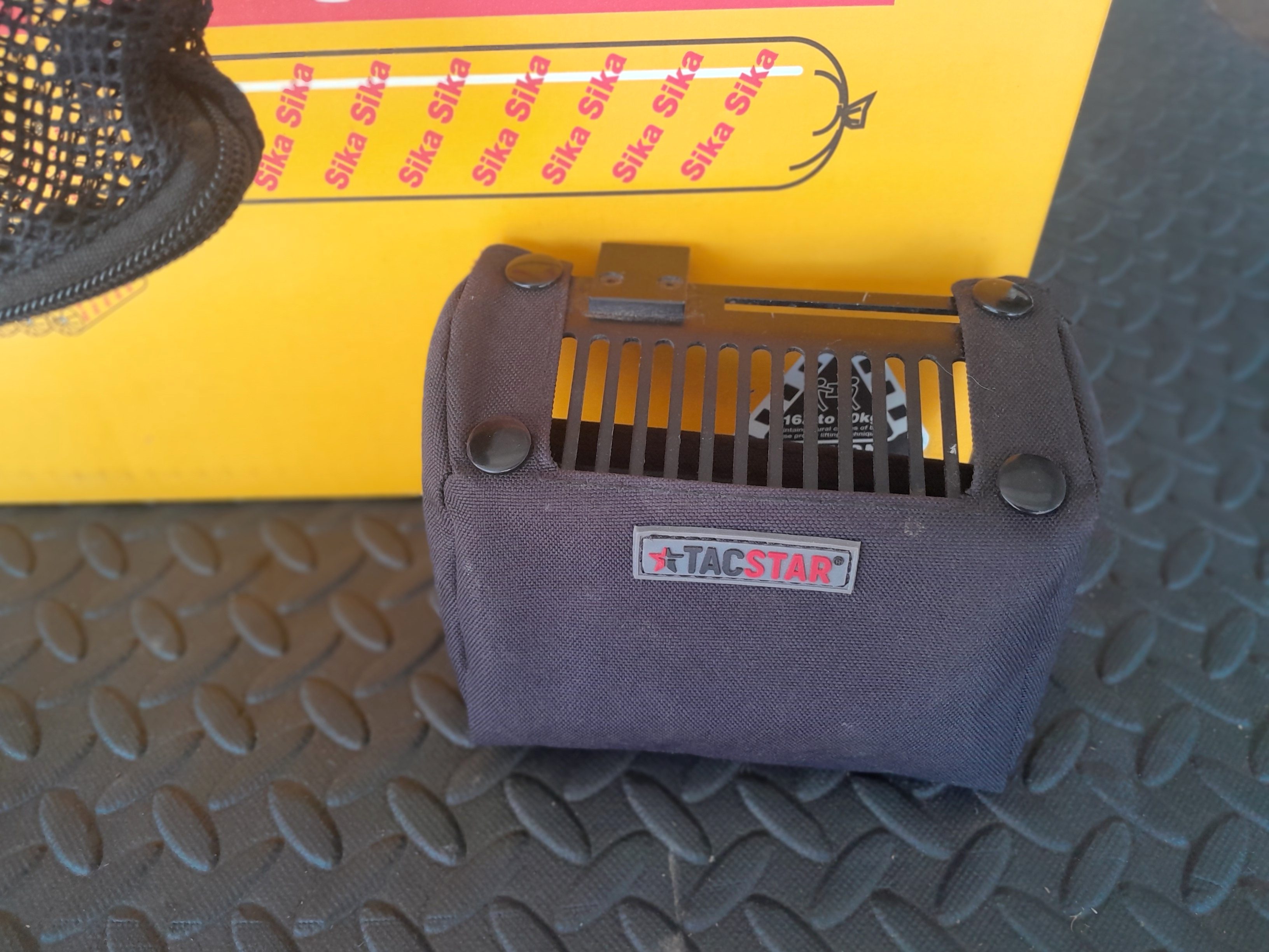

Post by Wapiti » 05 Aug 2025, 8:35 am
Hey DJ, this might work on that VC rifle. I notice you haver a pic rail on top.
This catcher clips on a little mount you screw onto the rail under the scope. Same as the plastic deflector above on the Gel Blaster.
It is supposed to hold 30 223 cases, I've only used it on 308 with up to about 15 shells ejected.
They sit in the bottom and you tip them out.

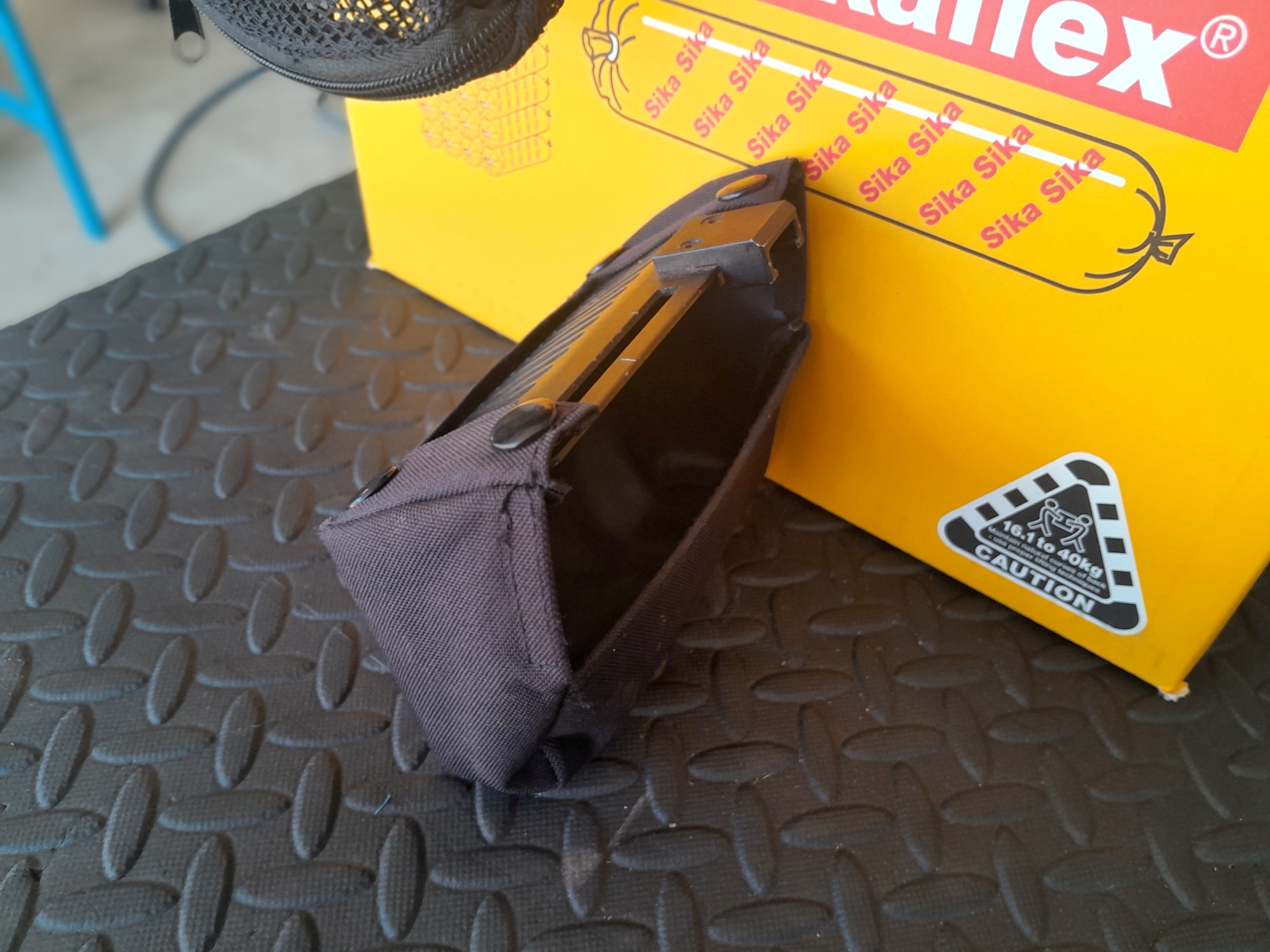

Post by Wapiti » 05 Aug 2025, 8:36 am
This is another view. You can see how it sits.

And here's another kind, also works well. Sure it's on a 22 here, but only as an example. Will fit any rifle.
Straps around the forend/barrel with very strong quality velcro, and has an unbendable wire frame sewn into it.
Has a zip in the bottom.
You can leave it zipped up to catch the brass as you want to, or you can unzip it and the cases fall at your feet.
