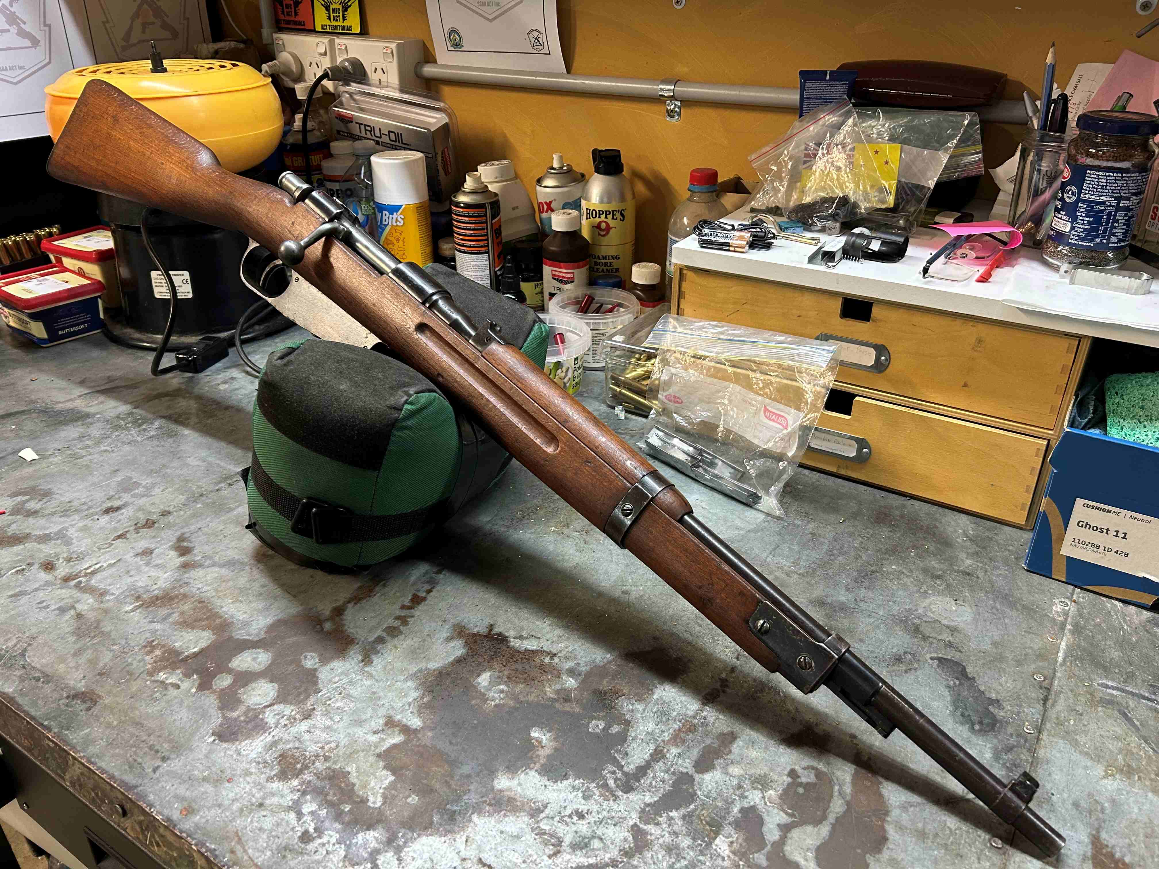

I was never a fan of Carcano, but one such rifle was included litterally for free in a big bundle of stuff that I was purchasing from a seller liquidating his shooting shed before going overseas.
IMG_7400 - Copy.jpg (705.65 KiB) Viewed 4634 times
Now that I have it, I would like to make it shoot correctly.
