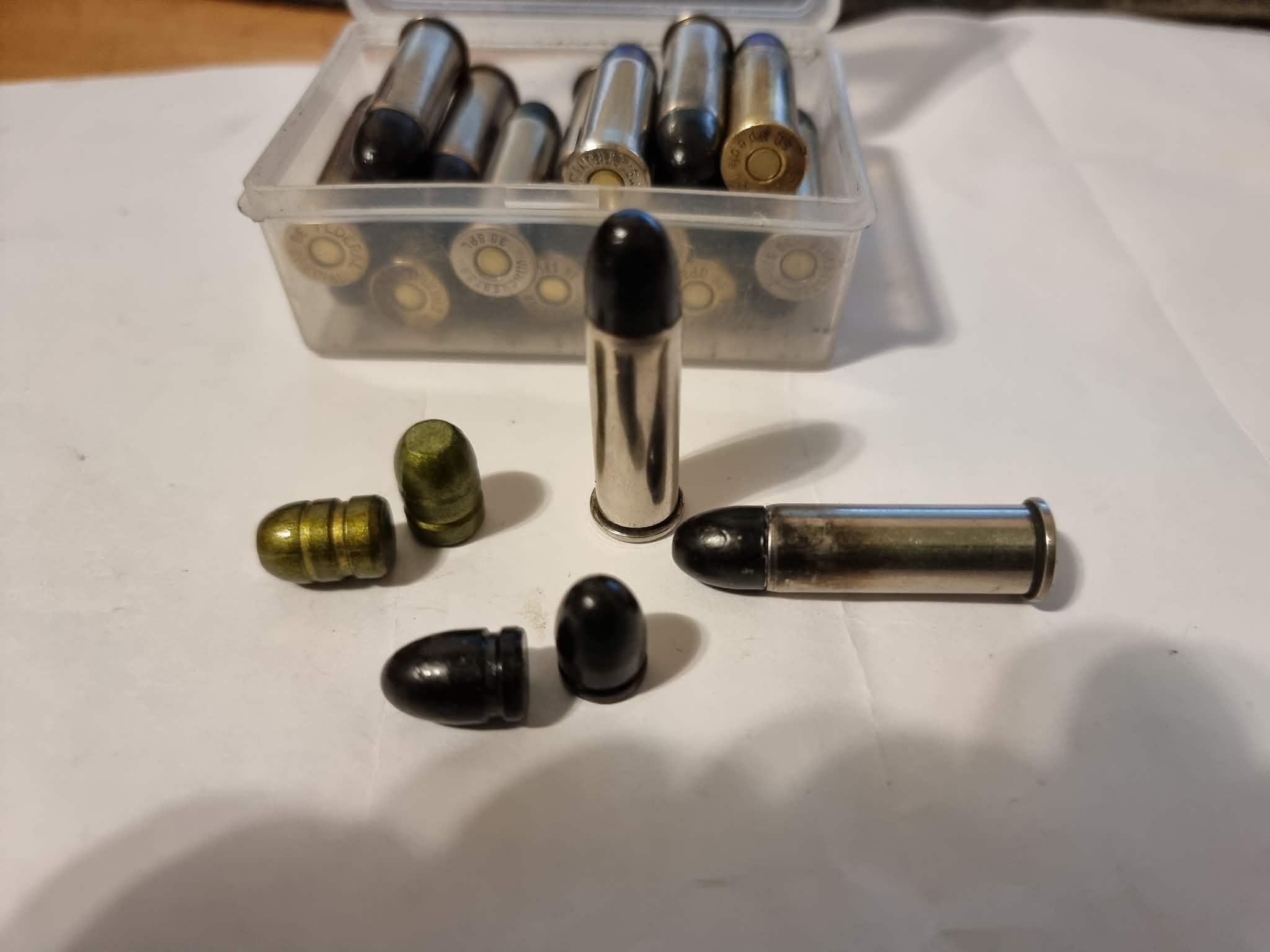

Post by mickb » 17 Apr 2019, 8:31 am
Hi folks , nice forum. I was looking to try out some of the hawkesbury river and westcastings coated 158grain bullets in a rossi 92 lever action. I understand they can be pushed a lot faster than regular cast without gas checks thanks to the coating.
One question is though since no cast bullet data usually goes this fast, do I just work up safely myself? I could start with moderate jacketed bullet data but jackets put a lot more drag on the bore so I am not sure what will be going on if I use these loads for a polycoated cast. I 'think' it should be safe as they will be causing less pressure?
Another question is what sort of speed can they be pushed. I think one of the sites says 1800fps?
The last question is what will these bullets be doing at impact on pigs and so forth? They are 16BHN which is sort of hard, but at such higher speeds I am wondering if they will expand slightly, fragment or maintain shape and zip through?
Could work all this out by trial and error but was interested to know if anyone has already done any of the above before I commit to a purchase. :)

Post by in2anity » 17 Apr 2019, 12:49 pm
There are listed lead loads for the 158s on ADI see http://www.adi-powders.com.au/rifle/357-magnum. 11.5gr AR2205 under a 158gr lead pill listed as 1382fps.
1800 fps is too fast for HRBCs. In my experience HRBCs are good to 1500-1600fps, but you'll have to venture outside of the listed regions to achieve this, and your accuracy may suffer. This is where a chronograph becomes invaluable - work up slowly and watch for bulging primers in the 92 action. You could possibly try and get your hands on some Hodgdons Lil'Gun if you want more speed.
HRBCs do not expand on game - they poke holes, i've personally tried this. Use a modern hunting bullet for hunting.

Post by bladeracer » 17 Apr 2019, 7:19 pm
mickb wrote:Hi folks , nice forum. I was looking to try out some of the hawkesbury river and westcastings coated 158grain bullets in a rossi 92 lever action. I understand they can be pushed a lot faster than regular cast without gas checks thanks to the coating.
Cast your own bullets in soft lead and powder coat them if you want to, but you don't have to if you're keeping the velocities lowish. Hard cast bullets are for drilling holes, okay for small game, but on any live target you need very precise shot placement as with FMJ's -brainstem and cervical spine. I wouldn't expect that level of precision out of an older lever-action.

Post by mickb » 17 Apr 2019, 7:53 pm
Thanks fellas. Was just curious to know what 16BHN does at 1800-2000fps, since some of the yanks claim this velocity. Its a moot point if the useful velocity is a lot lower, they will of course be doing the hardcast thing and zippin through.
Probably wouldn't agree cast bullets only have their place on the range though. Quite a few hunting sports out there that do pretty well with them. Not everything has to perform like high powered jacketed bullets to be ethical or we wipe out the sports of traditional muzzeloading, BP pistol hunting and archery :)

Post by in2anity » 17 Apr 2019, 9:26 pm
mickb wrote:Thanks fellas. Was just curious to know what 16BHN does at 1800-2000fps, since some of the yanks claim this velocity. Its a moot point if the useful velocity is a lot lower, they will of course be doing the hardcast thing
They’re probably gas checked, you can drive em harder with a check. Without a check, depending on the powder, you see obturation issues. And a lot of the HRBCs are beveled base (BB) so uncheckable

Post by mickb » 17 Apr 2019, 9:47 pm
No these are unchecked, eggelston and badman.
Actually they are running some of these over 2200fps, though who knows what accuracy they are getting.

Post by bladeracer » 17 Apr 2019, 10:31 pm
mickb wrote:Thanks fellas. Was just curious to know what 16BHN does at 1800-2000fps, since some of the yanks claim this velocity. Its a moot point if the useful velocity is a lot lower, they will of course be doing the hardcast thing and zippin through.
Black powder generally use soft lead bullets which expand just fine.

Post by bladeracer » 17 Apr 2019, 10:32 pm
Shouldn't need checks if they're coated.

Post by Diamond Jim » 18 Apr 2019, 1:14 am
I use Westcasting Moly-coated projectiles almost exclusively for punching paper and I continue to buy them over and over again. The information from the firm was to use data for equivalent weight copper-cased projectiles. I don't. I'm only trying to make a certain power factor and load accordingly.
I don't use my .357 rifle for hunting often (sometimes it's the go to rifle) but I wouldn't choose cast bullets for game. I'd choose a dedicated and properly constructed flat-nosed or hollow-point projectile for hunting.

Post by mickb » 18 Apr 2019, 9:36 am
Diamond Jim wrote:I use Westcasting Moly-coated projectiles almost exclusively for punching paper and I continue to buy them over and over again. The information from the firm was to use data for equivalent weight copper-cased projectiles. I don't. I'm only trying to make a certain power factor and load accordingly.
Thanks for the tip on loading, I was looking at Westcastings as well. I don't use non-expanding cast either , it works fine but its not my style. Where hardcast is used I'd probably want larger than 357 anyway but the idea is similar to when using big game rifles on very big game with solids or FMJ.
You are using something for which you understand you won't get the same margins of error the expanding bullet can give, but you are happy to sacrifice for extreme penetration. MostAussies the largest thing they shoot is pigs or an occasional deer and I'm not suggesting hardcast will replace anyones softpoints for that.
But as a general subject some of the guys might benefit from checking out castboolits.com or really any pistol or lever forum where they are taking it on large large game or game larger than the gun is usually used for. Hardcast are often the go to where you often dont have a FMJ available in the weight and nose profile you want.

cracker wrote:used softcast in my 44-40 makes a bloody mess of the barrel, never again such a pain in the ass
How did the alloy mess up the barrel?
Leading is usually a result of undersized bullets, not the alloy, especially at .44-40 velocities.
I've shot pure lead bullets in most of my rifles with just Alox lube without any leading problems. Make sure the bullets are fat, and keep velocities reasonable.
Or simply powdercoat them.

Post by in2anity » 18 Apr 2019, 9:26 pm
bladeracer wrote:Shouldn't need checks if they're coated.
So tell me how fast have you successfully driven coated, unchecked lead blade? (without stabilization issues)

Post by bladeracer » 18 Apr 2019, 11:21 pm
Off the top of my head probably not much more than about 1300fps I'd guess. Why would stabilization become an issue at high velocities?
I only started powdercoating early last year so mainly lower-velocity stuff, .38, .44Mag and Trailboss loads in other rifles. I don't personally have any interest in pushing lead fast, I cast for lower-velocities. Recently I've been playing with the 6.5mm milsurps and the 170gn Cruise Missile mould, but I'm only working around the 1300fps region so far, unchecked.
I did send some 161gn uncoated checked hardcast (32% tin) at 2500fps in 8x57mm just to see what it would do, it went through 8mm steel plate at 50m :-)
It leaded the bore horrendously though.
I have plenty of cast stuff though so if you want I could try punching some hard if you like and see how they get on? I've been meaning to do some more cast work with the .223 and .243. Could be fun shooting a bunch of .243 cast down range at increasing velocities. I don't think I have any already coated but I can do a batch pretty quickly. I have a pile of 8mm powder-coated already but they're also checked.
Actually, it just occurred to me that my .223 and .243 are tight-twist rates which will be a limiting factor. And my milsurps are all pretty tight too, I think the slowest is the '03-A3 at 10"-twist. I believe the Win94 .30-30 should be a 12"-twist but haven't checked it. I'm thinking my best bet to find max velocity will be the .44 Magnum.

Post by jezroshevy » 03 May 2026, 12:09 pm
Hi all,
for who ever has a similar question regarding coated bullets using adi powder,
here is my recommended starting load data that i have had great success with
test rifle = Ruger Marlin 94 trapper .357 16" barrel
Projectile: Eminence projectiles 158gr .358 LRN bevel base hard cast coated projectile 15-16BHN
OAL: 1.590"

Is this in .357 brass? I'm running light loads in .38 brass for Cowboy. I was running the 158gn Berry's on 2gn of Trailboss at around 530fps from the Uberti 1866, but I couldn't use them in the 24" Rossi as they stop in the bore. I bought 4500 of the Boyne 125gn RNFP last year when I couldn't get the Berry's - I only have about 70 of the 125gn bullets left now. I've been running them on 3.3gn gn of AS50N making around 900fps in the 20" Uberti 1866, and 15gn of FFFg plus a lubed Wonder Wad and 2gn of polenta also making around 900fps.
I need more .38 bullets now. I've tried HRBC's 100gn SWC on 4.0gn of an old powder and they do run fine in the rifle, but the sharp shoulder on the bullet worries me for reliability. I haven't been shooting IPSC this year at all and have thousands of HRBC's 115gn 9mm RN on the shelf. I already tested them in the Model 19 .357 revolver and they worked fine, but hadn't tried them in the tube-magazine rifles yet. So I loaded 20rds of the 115gn RN .356" into .38 brass with 12.5gn of FFFg and a half-inch wad at 1.550" for testing in the rifle. Crimping into the deep lube groove gives me more faith in the bullet not pushing back into the case under recoil, as the Boyne bullet can do occasionally.
Ten rounds ran just fine this morning, averaging 805fps (a very low 776fps blew the ES out to 62, excluding that one the ES was 40fps). I'll put the other ten onto paper to see whether the bullets are tumbling, but tumbling doesn't matter for Cowboy. Heading for Wodonga in the morning for two-days of Cowboy so probably won't get them tested on paper until next week. If they are stable I'll have to work up a 1400fps load for the long-range shoots.
https://www.youtube.com/watch?v=o5xfTmR8xzQ
Had to go out with the metal detector to find the brass :-)
