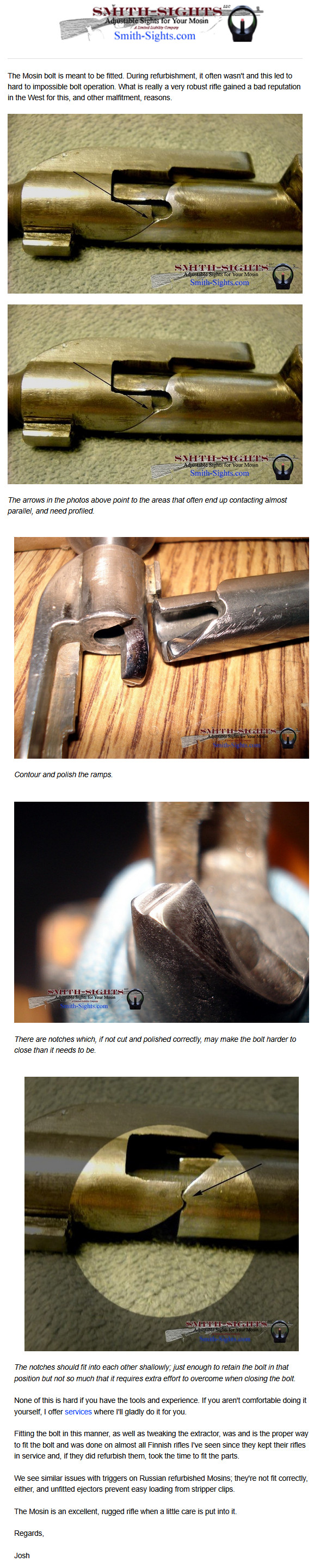

Post by Josh Smith » 11 Jun 2026, 3:29 am
You can right click+save as to keep this JPG.
Smith-Sights Solution Bolt Cocking Ramps.jpg (514.51 KiB) Viewed 77 times

Post by No1_49er » 11 Jun 2026, 5:51 am
Unfortunately, that link doesn't work.

Post by Wapiti » 11 Jun 2026, 7:04 am
Josh, appreciate the time taken to add to the site
It's not many that take the time to add pics and try and put some colour into the place, so good on you mate.
Just click on what Josh has posted, and it will open and drop down and the whole thing is there for you to see what he has taken the trouble to post.
