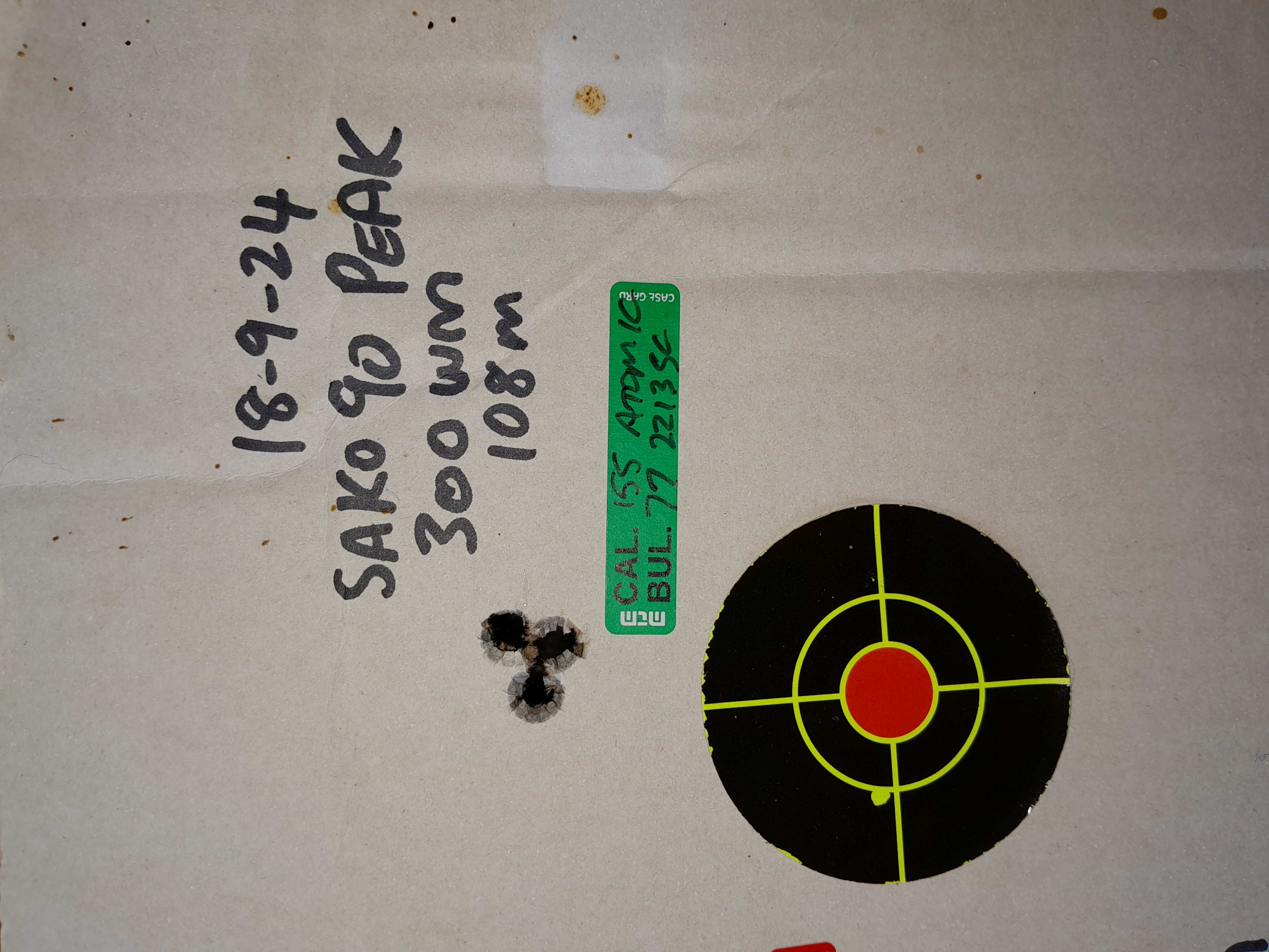

I now use the awesome Atomic 29 175gn copper CNC machined bullets, locally made, cheaper and very consistent.
I can't find any of the 175gn ones in any pics to prove, but this is a result from the 155's,
So I'm going to buy Aussie made premium bullets from now on and have for awhile now for the true hunting stuff, and not get raped by the importers.
