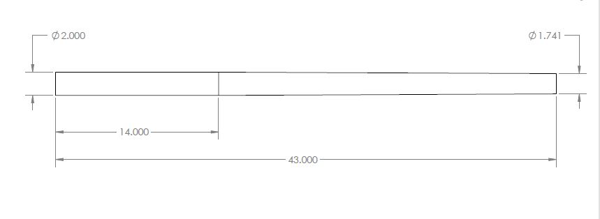

Post by brett1868 » 18 Apr 2016, 3:37 pm
This is the barrel I've got coming for "Project 50"....14.4kg or 31.74Lbs for our metrically challenged brothers :D Will only occasionally be used for hunting :lol:

[quote="brett1868"]This is the barrel I've got coming for "Project 50"....14.4kg or 31.74Lbs for our metrically challenged brothers :D Will only occasionally be used for hunting ::
You are going to need a few gun barres to carry that thing for you.
Reminds me of going on a hunt with a certain African P.H who makes a lot of hunting videos. Great guy and good fun to be in the bush with. He has two poor guys who have to carry his .600 Nitro around the place while he carries his .500 :unknown: posting.php?
