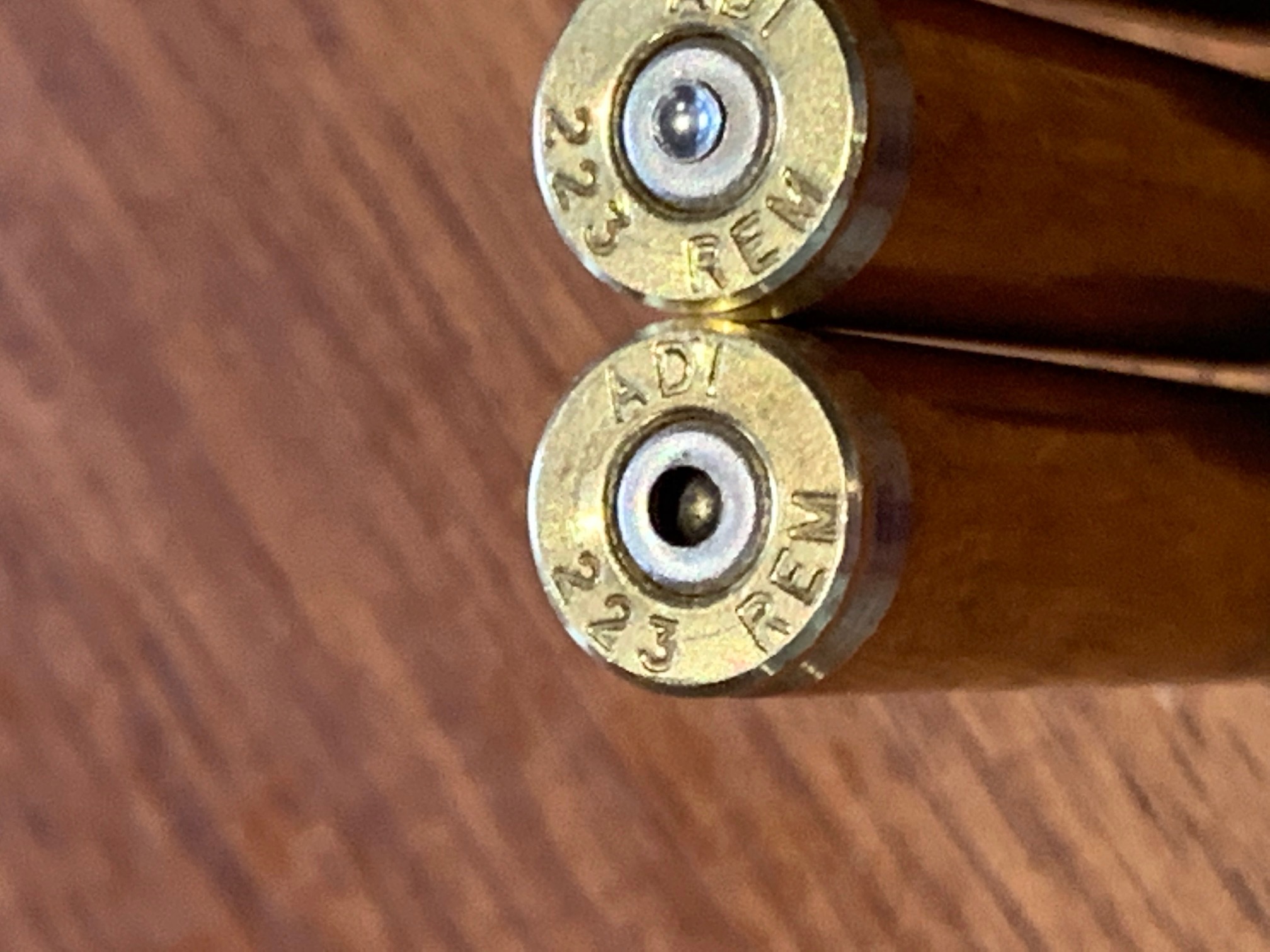

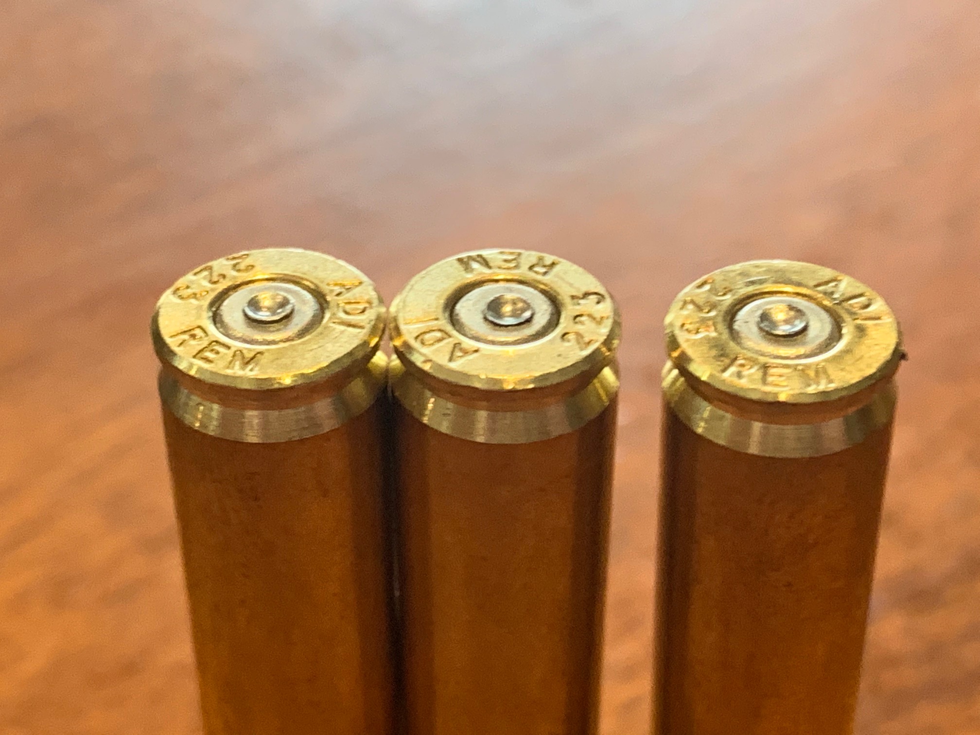

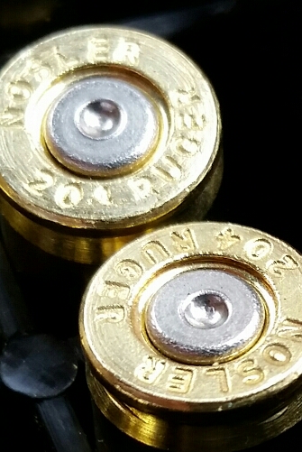

Nevertheless, with the TAP loads I noticed where the firing pin struck, primers were bulging out like a little "tit":
62gr TAP, 25.5gr AR2206H
When I got to the fourth SMK round, alas I suffered a pierced primer (I am now very thankful of the HOWA vented bolt):
69gr SMK, 25.5gr AR2206H
Pierced primer "deeper" than the rest

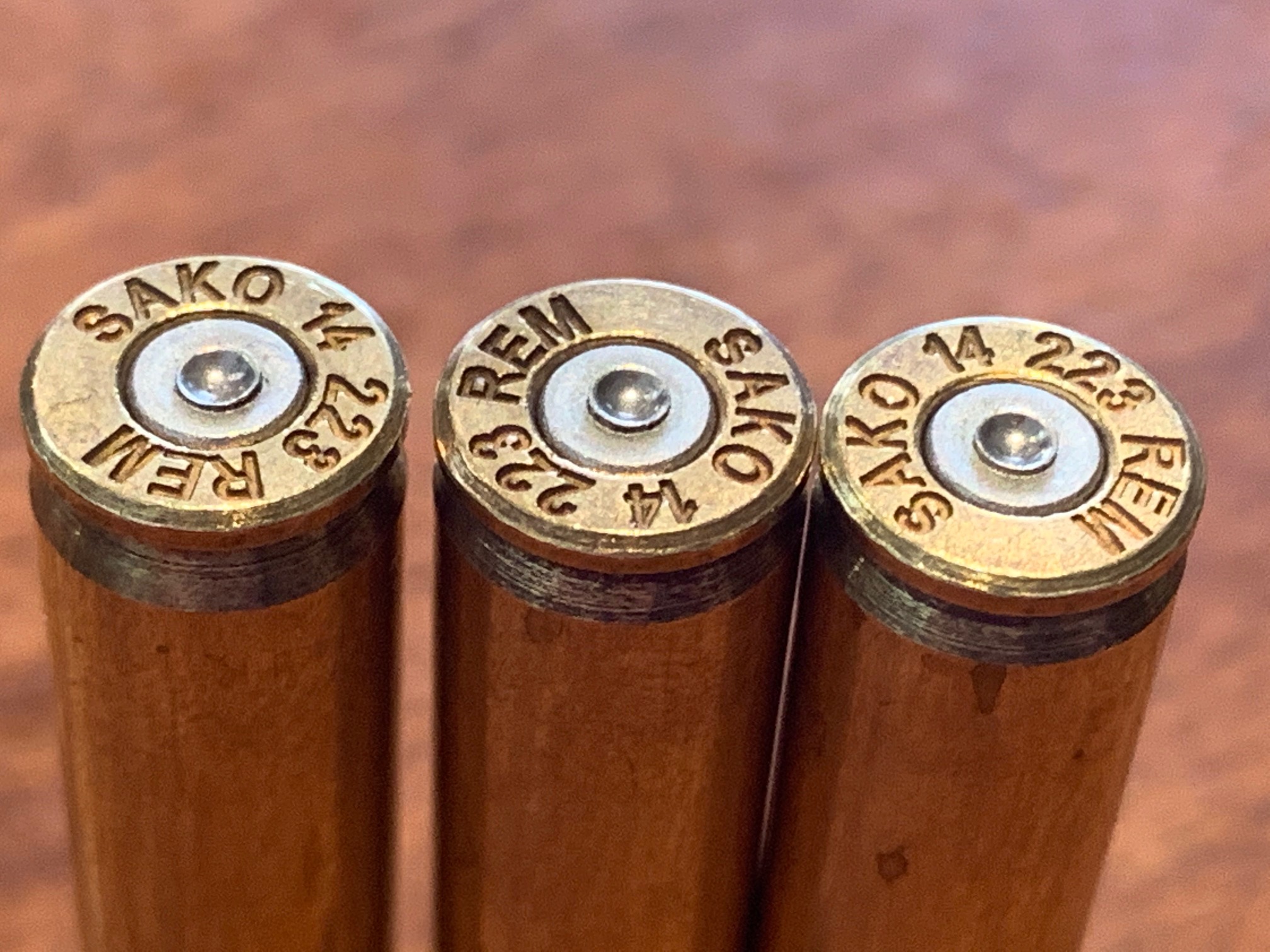

The thought then occured to me as a comparison, I should immediately compare against some factory ammo:
SAKO gamehead factory
So that's what I did, and as you can see the factory SAKO ammo also exhibited the same, cratering primer problem, indiciating the factory is operating at a similar pressure to my handloads.

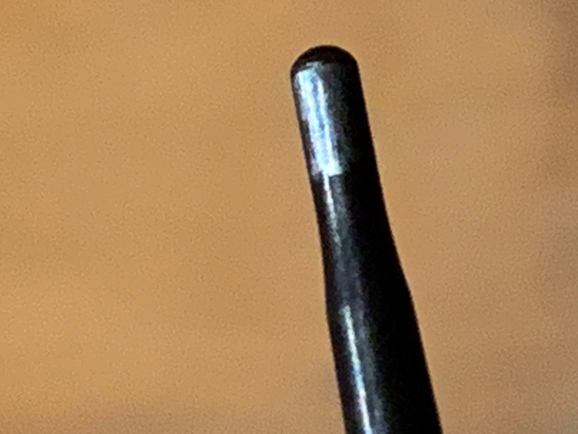

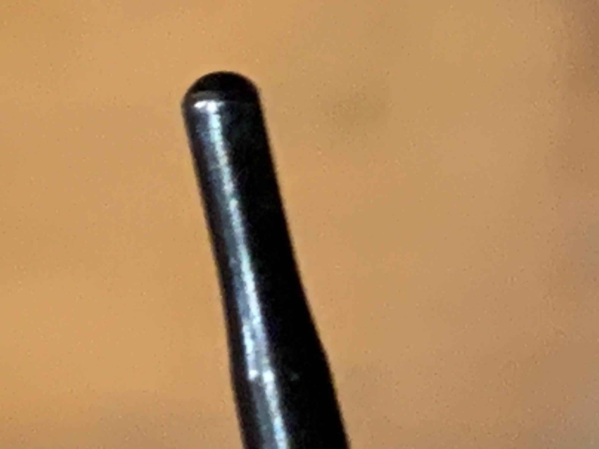

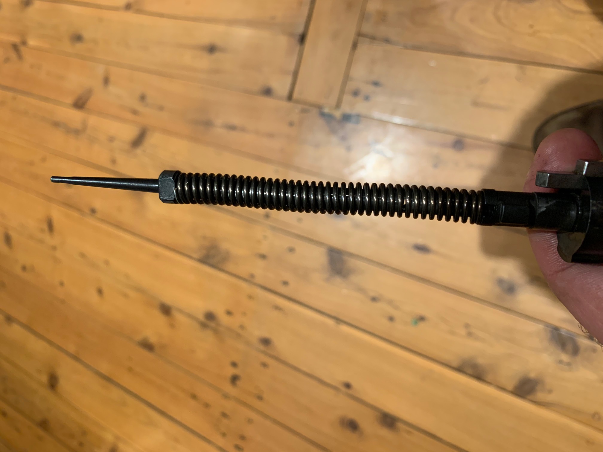

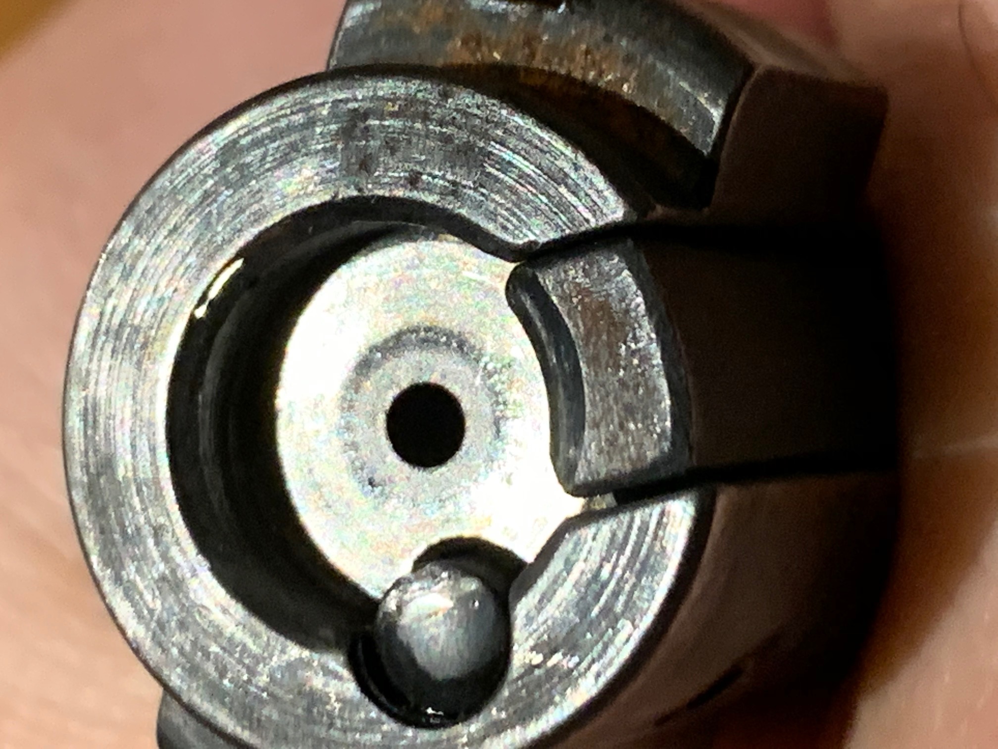

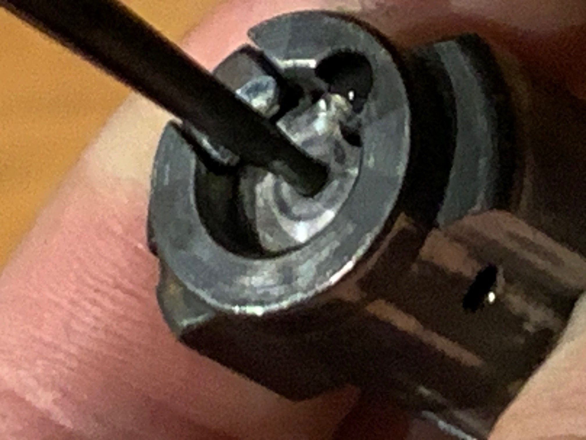

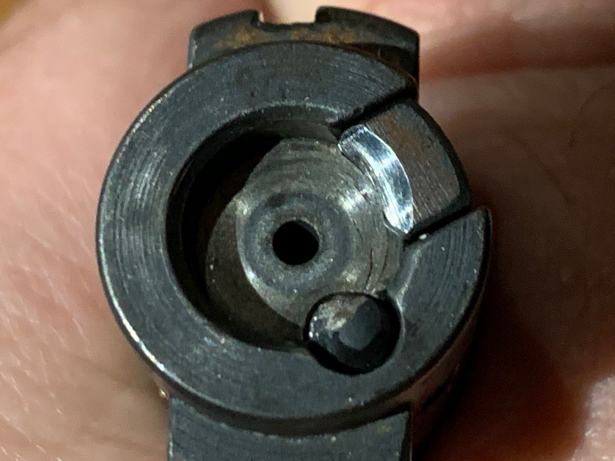

I understand this may be a problem with firing-pin hole slop, or perhaps a weak firing pin spring? So here's some pics of these parts out of the bolt:
One side of the pin is still blued
But the other side is a little "polished"
Tiny bit of wiggle going in, but not hugely...

First of all In2anity i would get the head space checked then the firing pin spring judging from the same thing happening from 2 different lots of ammunition then i'd guess it has something to do with head space or the firing spring

It is also a bit of a known occurrence when using factory firing pins and bolts with small rifle primers. the firing pin is about the same size of the inside of the primer cup.
At first glance I was going to say it looked like firing pin hole slop as the primers still looked rounded in the corners but the pierced primer (correct term Blanked Primer) is not good I would load lighter rounds.
The factory look even more like over pressure the primers have flattened out and you have the same primer flow on the edge of failure. That doesn't surprise me for all the bleeting people go on about at starting at minimum loads most factory are very hot near max loads.
I would load light loads say 24grn 2206H and see how you go with those the difference in velocity will be minimal and not show any real difference other than less primer flow. I would also try some CCI BR4 primers if you get them NSWRA they wont be that much more expensive.

try a harder cup primer, the cci 450 and br4 are both .025" thick and either should fix the problem :drinks:
cookie cutting is another term for "blanking", they are not the same as a pierced primer

The Factory Sako ammo is to warm side. From memory I think it was doing 3300fps with the 55 gr projectiles. So not too slow. I got similar cratering in my rifle.
I would back your reloads down a grain or so and switch to primers with a thicker. CCI BR4 as already mentioned or CCI 450 small rifle magnum or Remington 7 1/2 as I believe they also have the thicker primer cup.
Might also be worth trying a different brand of factory ammo other than the SAKO.

and lowering the load is not a fix if it it not a high pressure load, loads don't have to be over pressure to blank a primer
sloppy bolt head firing pin channel and or improper shape and or protrusion on the firing pin tip
headspace can be the cause of pierced primers
as for the cratering when fired the primer conforms to the firing pin the firing pin spring must be strong enough to hold the pressure in the primer if the spring is weak pressure inside the primer pushes the dent out of the primer it is about this time the dent reverses instead of an 'innie' the dent becomes an 'outtie'
that said l believe using harder cup primers will fix it
your question to "If it were a headspacing issue, wouldn't you expect to see the entire primer backing out?"
the answer is no, a primer backing out is caused by low pressure not headspace
let us know how it goes :drinks:
changing the firing pin would not be a fix, the fix is to get the firing pin hole bushed :thumbsup:

With the bushing of the firing pin hole, goes turning down the firing pin to .062 and sometimes the extractor is damaged and they have to fit a Sako type extractor.

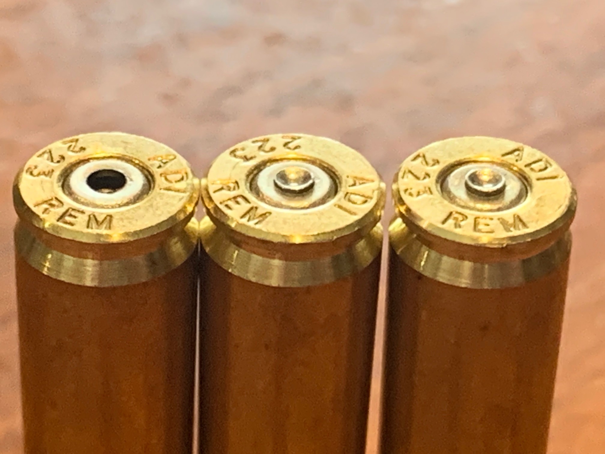

Hey In2...i hope y'all dont mind if i quietly poke my head in here...
I have a similar problem (not as bad) with a new rifle i shot for first time on weekend...
Figured id throw my pic up here rather than start another thread for the same thing--i hope thats ok... :)
(Need an emoji of a meerkat peering over a rise... :lol: )...
So...these are just Federal primers--it's all ive really ever used...
Shot in a Sako 85 VLS...26.9gr of 8208...Hdy 40gr Vmax.
Bit of cratering
2019-12-09 18.16.31.jpg (137.18 KiB) Viewed 13868 times
Had one do this & not fire...but rechambered it & it fired ok second time... ( :unknown: )
Did not fire...
2019-12-09 18.14.05.jpg (48.48 KiB) Viewed 13868 times
Same case-different angle...
2019-12-09 18.14.40.jpg (35.23 KiB) Viewed 13868 times
Dont feel hot loads, & they are not hot according to ADI-well they're getting up near the top of their list--although some of the cases were getting on their way to full as they are new & were FL sized down a fair way so they were all the same...
I shot 34gr Nos shots & 40gr Vmax, & its only the low end of ADI list that dont crater like these...
My other 204 doesnt do it but is only shooting a mild load of 2208...
So...should i just try these CCI primers...or do i need to get this bolt/firing pin assembly checked...?
Again, sorry to butt in...dont want to hijack...i just see it pointless to ask the same thing in a different thread...

Have the same problem with my Howa that's rechambered to 223AI, there are 2 problems with Howas chambered for calibres using Small Rifle primers, the firing pin diameter is too large for small rifle primers and add in too much firing pin clearance results in cratering or blanking ( piercing ) primers. Until I get mine rebarrelled which is when I will have the firing pin sorted I am getting around the problem using CCI BR4's, these and the 450's have thicker cups, still get some cratering but no holes in primers.

That primer does look like it is seated very deep.. Did you recut the primer pockets on this brass?

That primer does look like it is seated very deep.. Did you recut the primer pockets on this brass?[/quote]
Yes...
The detsils & depth i posted in the thread for the new brass...
Ill look it up a wee bit later...
But they are within spec i think... :)

3rd and 4th is light primer strike... could be if they are seated too deep

I am with ya on that one stix, its not a case of powder charge else that primer would be flattened out not just protruding like that.
