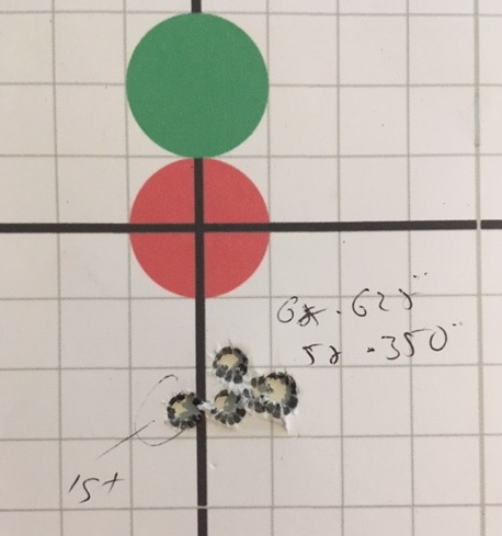

Out on the range, first shot was a fouler. The next five shots went into .350" at 100M and all six (including fouler) went into .625", including three through one hole. That was the start and end of my load development. 8-)
143gr ELD-X, 41.8gr of 2209, Lapua small-primer brass, BR4 primers, 2.850" OAL (0.084" off the lands), chronoed at 2700fps

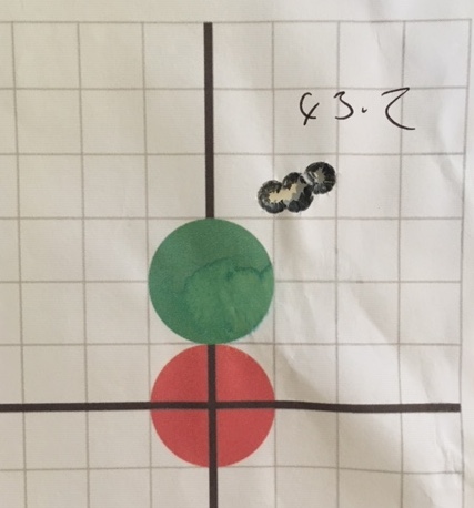

Apart from the 143gr ELD-X, I have a softer target load: 123gr Lapua Scenar; 43.2gr 2209, Lapua small-primer brass, BR4 primers, 2.850" OAL (0.015" off the lands), chronoed at 2835fps.
4x shots at 100m

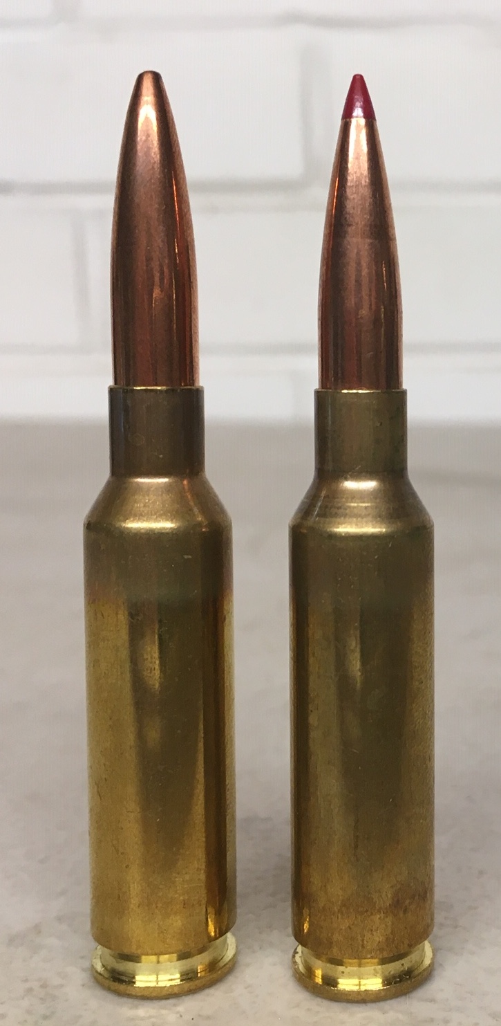

123gr Lapua Scenar vs 143gr Hornady ELD-X, both in Lappy SRP brass

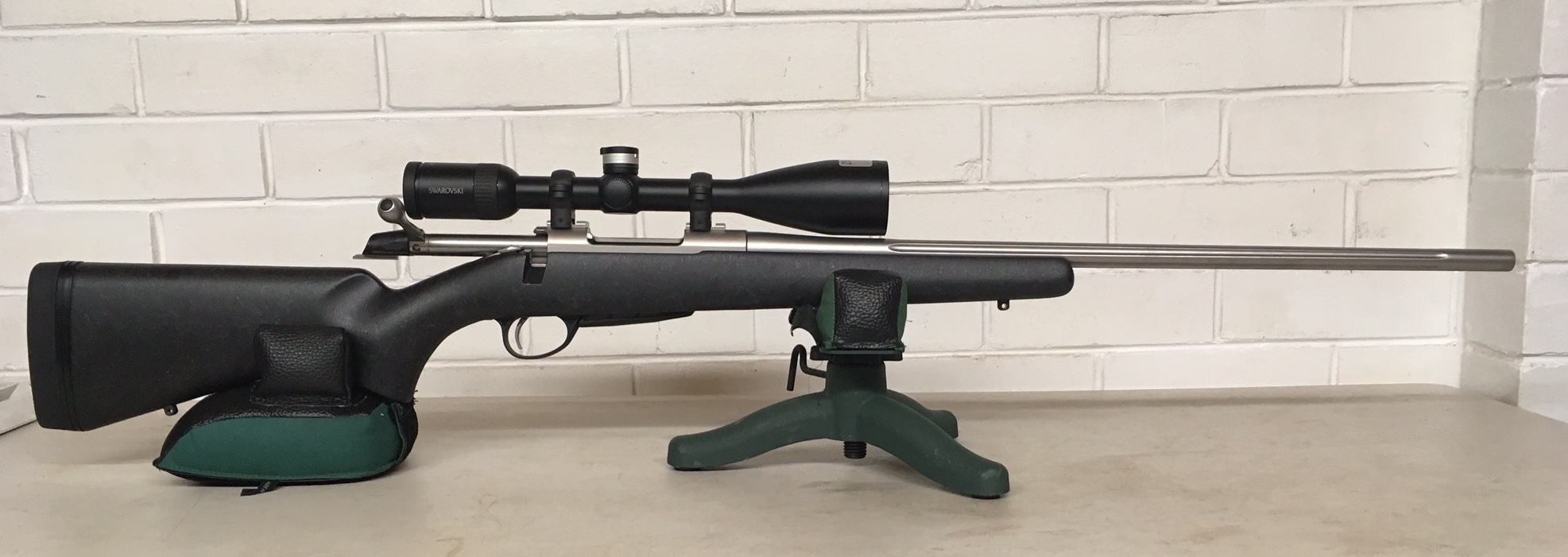

Rig

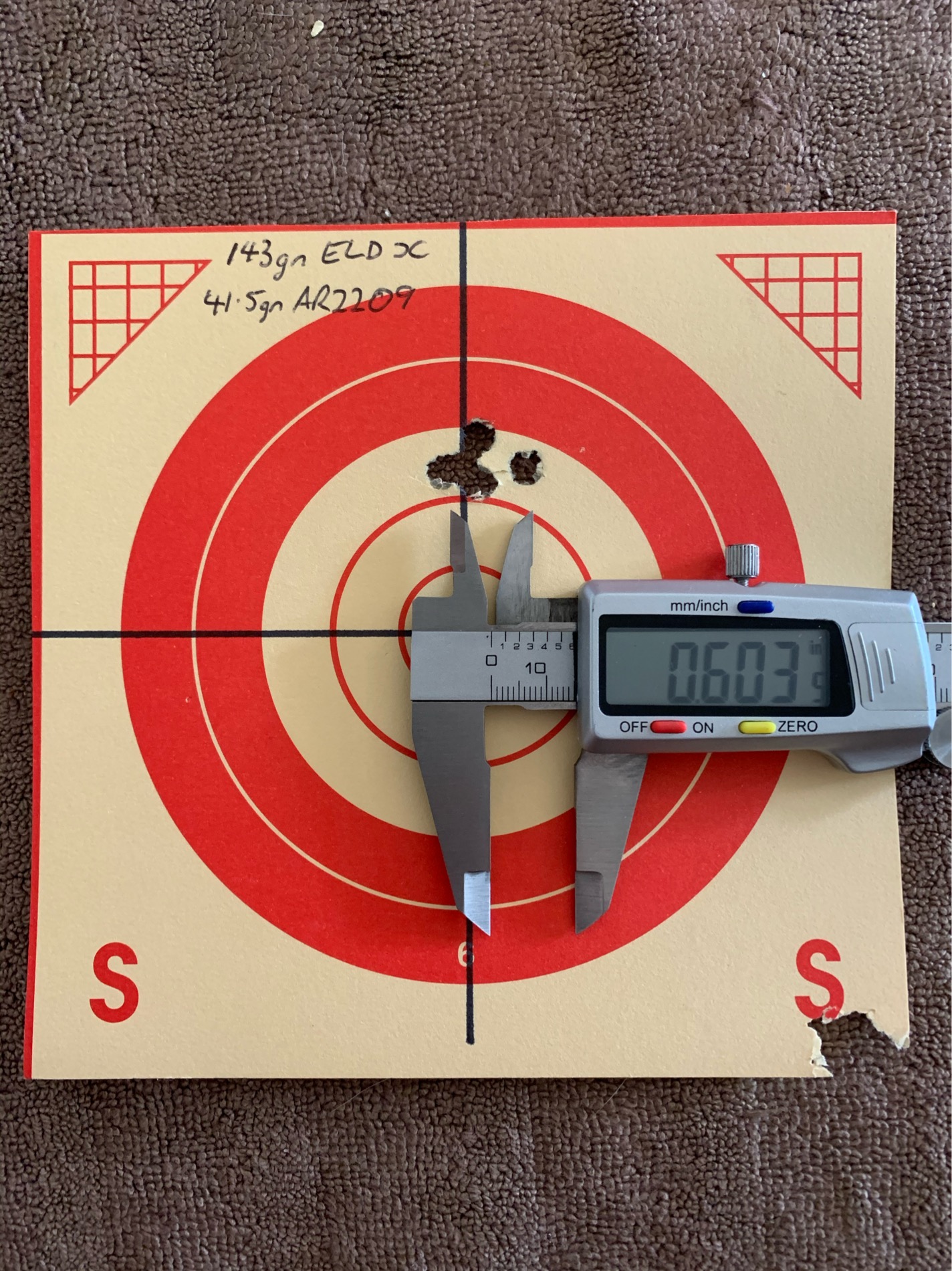

You have a great memory mate. Yep my load for the 143 ELD X is 41.5gr AR2209 and a 2.85” OAL the same as yours mate.
I agree, the Sako A7 is a great rifle. I’d buy another in a heartbeat.
Here is my target, 5 shots at 100m. I also had a flyer at the end, it was me not the rifle otherwise it would have been a cracking group.
Still I am Happy with 0.6” at 100m. Group would have been half that if I was competent. :drinks:
