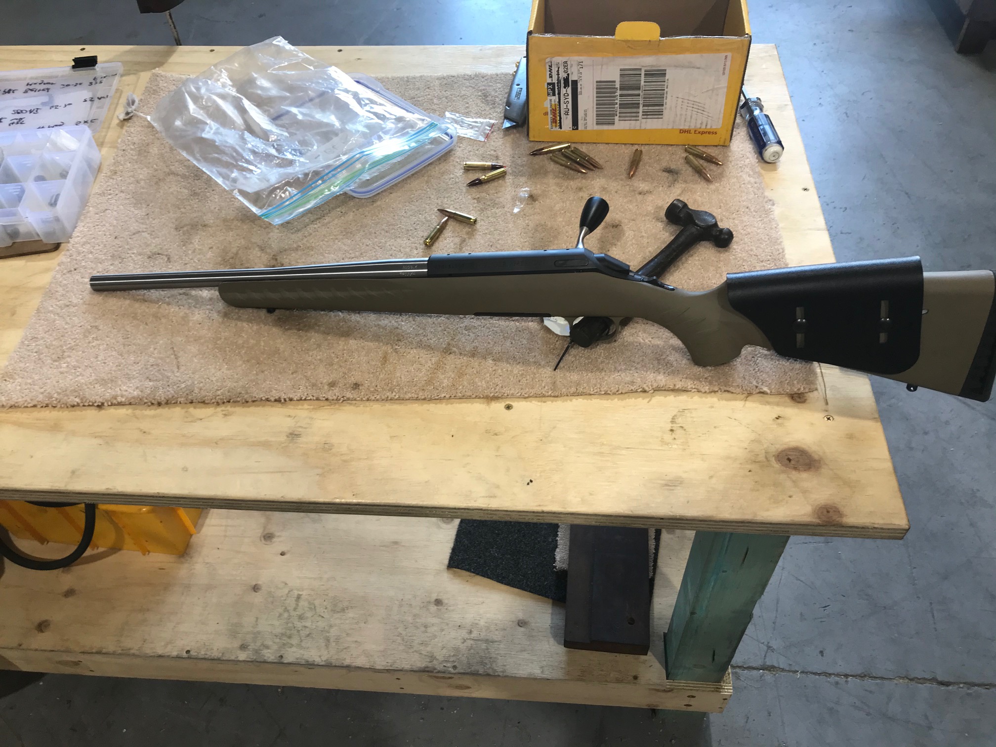

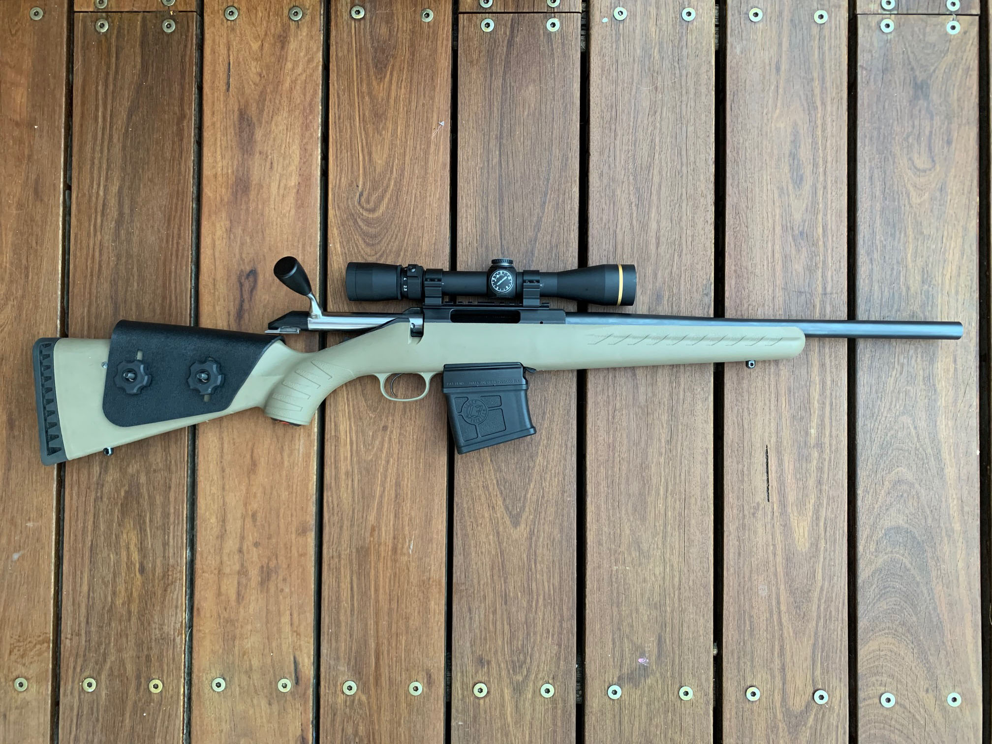

Given those observations, I decided to reconfigure my blackout to suite specifically a 125gr supersonic load. Looking at the specs for the AK-47; it sports a 1:9.45" twist with 16" barrel shooting roughly a 122gr pill. I thought the Ruskies were probably on to something.

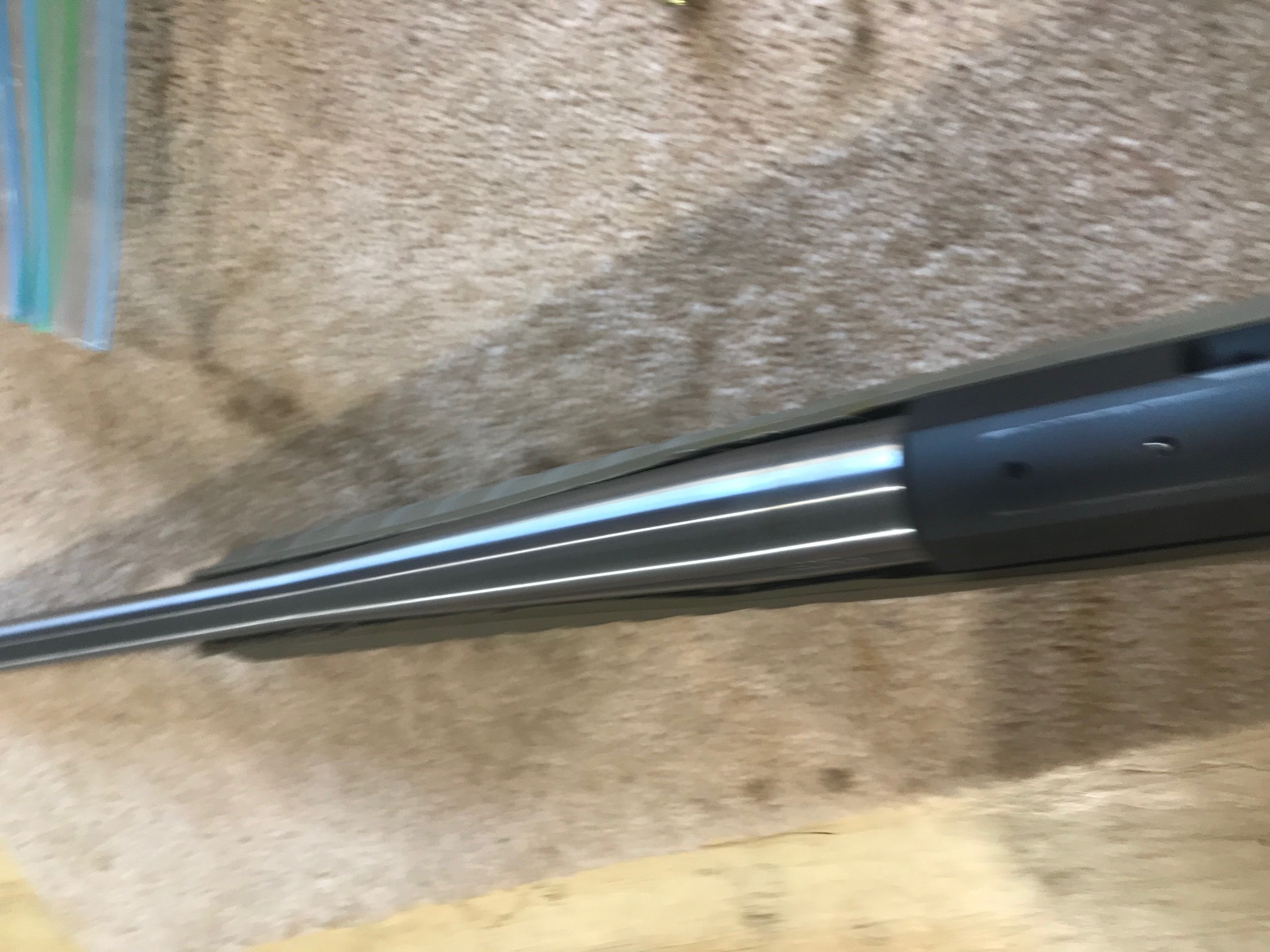

So I ordered a custom barrel from Lothar-Walther to match the existing contour, only with a slower 1:10" twist, and a custom short-throat reamer from Pacific Tool & Gauge to match the 125gr pill.
10 months later (thanks COVID), the project is now complete:
Retrofitted, 1:10" twist 30 cal barrel. Short throated for 2.1" COAL.

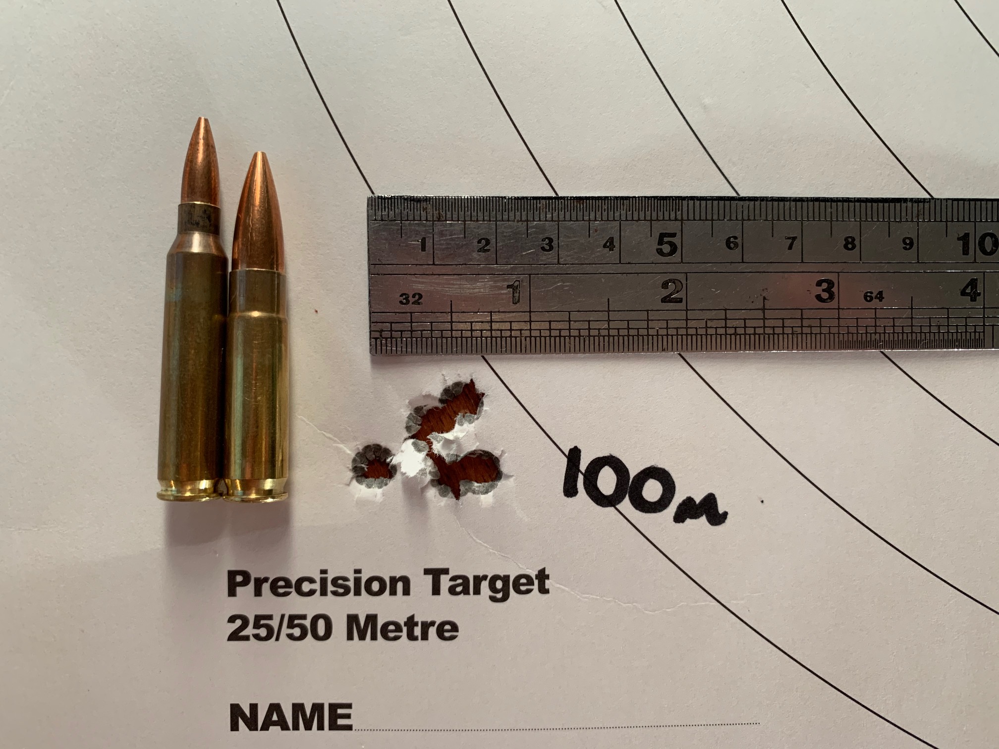

I took it out on Saturday and I shot crimpless FLS handloads on the 100m mound, off the bags, with an INSANE 30-40km/h fishtailing tail-wind (the hardest kind of windage) and here's the result:
Typical 100m group, shot quickly to combat 30-40km/h fishtailing tail-wind
Now that my friends, is a true sub-moa 300 blackout. This little girl will be accompanying me more often to the Telescopic matches, and is my go-to hunting rifle (at 3.7kg fully kitted including sling).

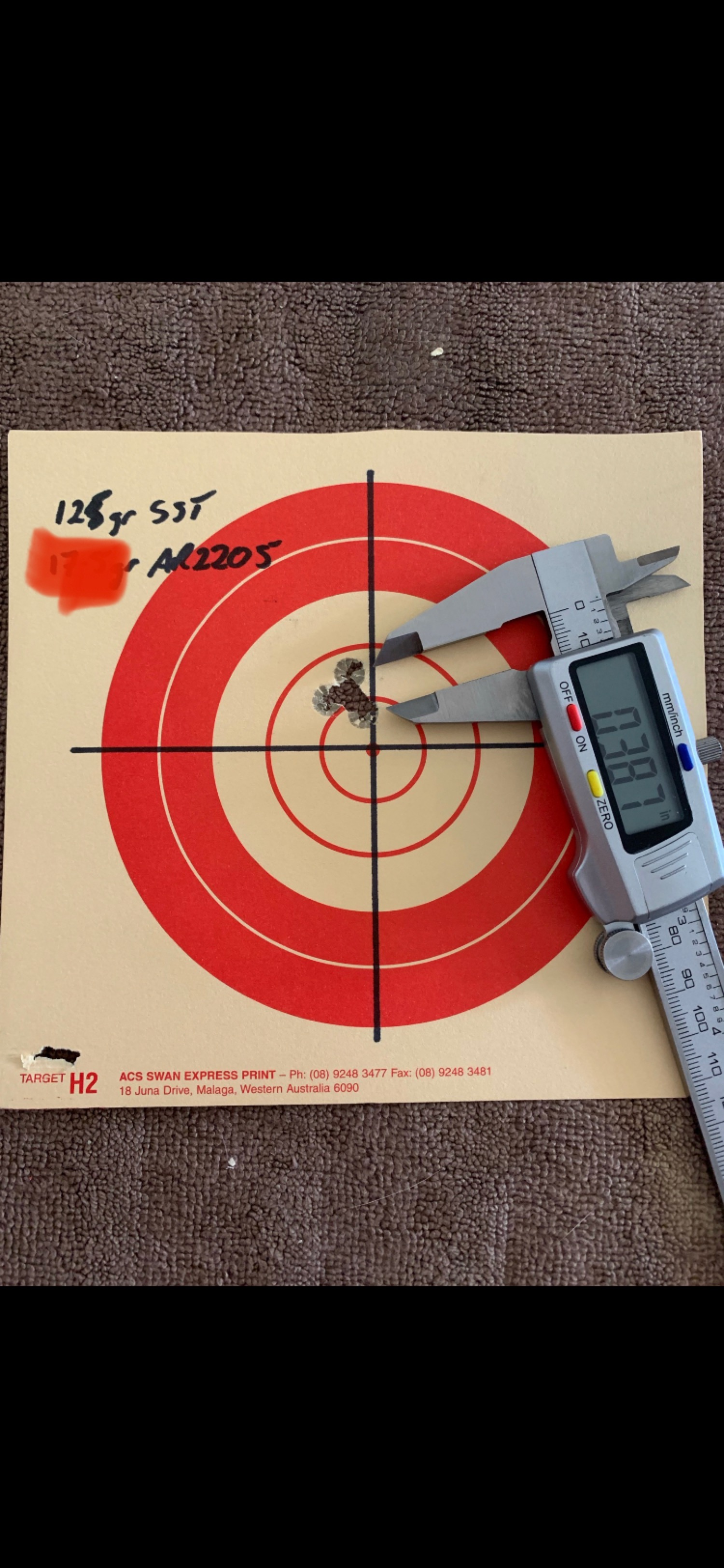

I use a 300 AAC and although know it is designed primarily for the US market in maybe an AR platform for hogs I use it here for closer range pigs. In saying that I have taken them at further distances.
Attached is a 5 round group at 100m hand loaded with 125gn SST and AR2205. Rifle is a Ruger American shot off the bench with a bipod and a rear bag. Believe it not.
Re: The 300 blackout sucks, or does it....
Post by JimTom » 28 Sep 2020, 3:29 pm
Of course I can’t do that every single time however that is what the rifle is capable of. Not bad for a sub $800 rifle that included a scope.
