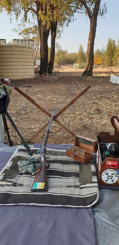

In that case, to get the real traditional feeling for "lobbing heavy lead" you need a single shot black-powder rifle!!!! :lol:
Smoke, noise, recoil and long-range accuracy, what could be better?? :thumbsup:
200m setup.jpg (187.85 KiB) Viewed 7424 times
