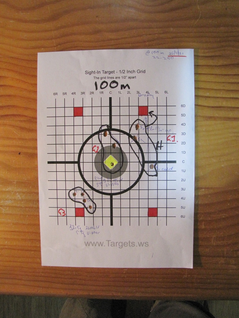

So I left it till the next day to try again, and this is what I got:
T3x 22-250 2.jpg (309.46 KiB) Viewed 12672 times
G1 Hornady. G2, hand load of 32.5 gr 22206H and 55gr V-Max. G3 31.5 gr 2206H.
So none of these is any where near what I would expect from either factory loads or the hand loads in a brand new rifle. I cleaned it between types of ammo also.
So what the hell is going on? I am wondering if the scope is out, or the rife is just a dud. I checked the ring screw tensions with the torque driver etc. It should be shooting way way better than it is so something is not quite right. I am loath to think that it is 'just settling in' coz these rifles are supposed to come with a 1 MOA already shot guarantee.
Any thoughts or suggestions greatly appreciated. I'm thinking I might need to check the scope on another rifle or put another one on the 250. I am not a happy camper at the moment. Ive put pretty well 2 boxes of factory ammo through this thing and its still shooting like a dog. Should have taken 6 shots at most :-(
Any assistance would be greatly appreciated.

Did you clean it for carbon and copper? Did you notice much copper fouling and did it come out easily?
You are getting a lot of vertical at times, are you shooting off a rest?

First things first, obviously is everything all sitting pretty (action in stock, scope attatchments, scope tracking & holds zero etc etc).
Id say by the looks of that the ammo isnt suited to the rifle, or the rifle doesnt like the ammo/any of it.
So having said that, have you tried different ammo...?
I had those very same patterns once out of an old 22-250 of mine--its good to see them gone & posessed someone elses gun for a change... :lol:
Just kidding mate... :)
Try diff ammo/bullets/powder, or vary the powder. Try working up further.
But first, try a different scope if you think its not the ammo.

The verticality suggests a bedding issue to me. Perhaps re-seat it in the stock?

Have you taken the insert out of the stock? That is around the knox area of the barrel
A mates T3x shot Ave groups but not as bad as urs and when he removed the insert it shot alot better. Also check the barrel is free floated with a $5 note right at the forend. If its contacting then it need to be relieved. T3x don't have pillars for the action bolts so don't over torque them.

SCJ429 wrote:Did you clean it for carbon and copper? Did you notice much copper fouling and did it come out easily?
Yes cleaned several times over this short journey.
No,no signs of copper when l cleaned with Sweets.
Yes shooting of a rest - used both a bi-pod and bag. Same results.

Latest attempts....
I did a few of the suggested checks - took the action off and re tightened to suggested tension, checked scope ring tension.
Shot these groups today. Conditions reasonably good. My shooting pretty spot on based on the 22LR warm up.
The top right was with WIN brass V-Max 55gr, top left and bottom right Hornady brass 55gr V-Max. Both these with 32.5gr 2206H. Middle target 55gr Sierra BlitzKing 33.0gr 2208. Bottom left 40gr -Max 35gr 2206H.
So I don't think this rifle likes 55gr, OR I need to run a full set of loads through it as I am wondering if tit just likes stiff a bit faster. Those 40gr Z-Max are coming out at approx 3,800fps. The fact that none of the 55gr projectiles did any good - incl the 50 and 55gr factory loads from previous sighting attempt - is concerning as the 55gr in a 1:14 is the bread and butter weight. So its better, but hell, its taken over 60 shots to get this far. Not happy with that. Should have been much tighter from the get go. Compared to my Tikka T3 Lite in .308, this 22-250 is shooting crap. The 308 shot tight from the 4th or 5th round.......
Thoughts folk?

55gn is at the very top of the length that will stabilise in a 14"-twist, and polymer tips make them even longer. Try a flat-based soft-point, or hollow-point.

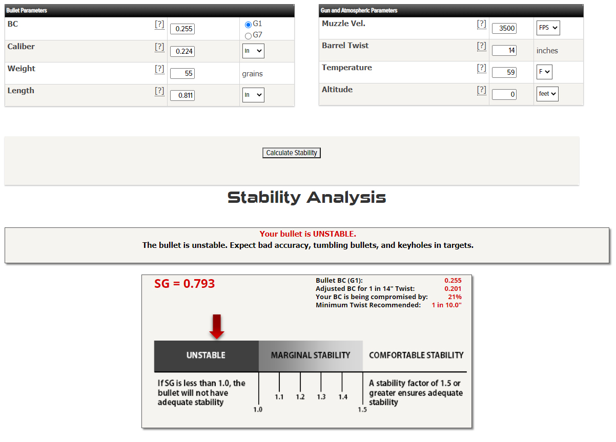

A-HAH! Paul, as Blade alluded to, just crunching some numbers, this is almost certainly a stability issue, because of your slow 1:14". Check this out:
55gr at 3500fps w. 1:14"
Now, look with a bullet of length 0.517 (the 35 gr vmax):
35gr at 4000fps w. 1:14"
With the low stability value as shown, it's not at all surprising the size of those groups.
Can you get some short .224 bullets? Has to basically be under 0.6".

Speer 50gr soft point is only 0.620, I had a quick check and cant seen any 224 pills any shorter, it might be worth trying to grab some and go from there
https://www.jbmballistics.com/ballistic ... gths.shtml

Post by bladeracer » 15 Apr 2021, 6:05 pm
Pull the tips out of five and shoot them.
in2anity wrote:A-HAH! Paul, as Blade alluded to, just crunching some numbers, this is almost certainly a stability issue, because of your slow 1:14". Check this out:
