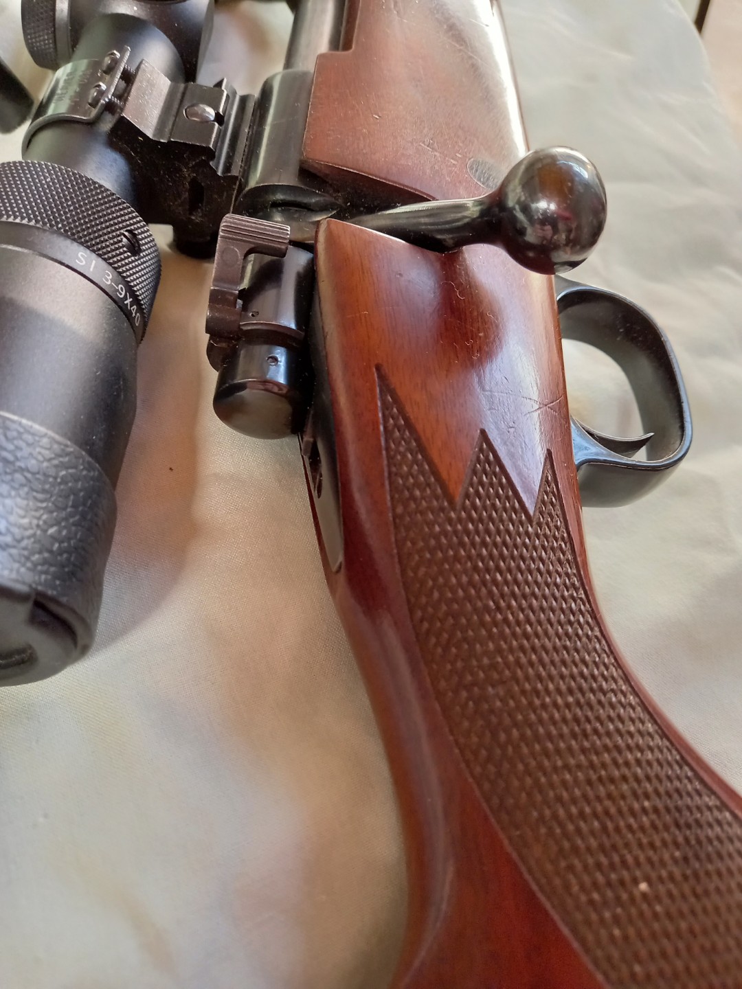

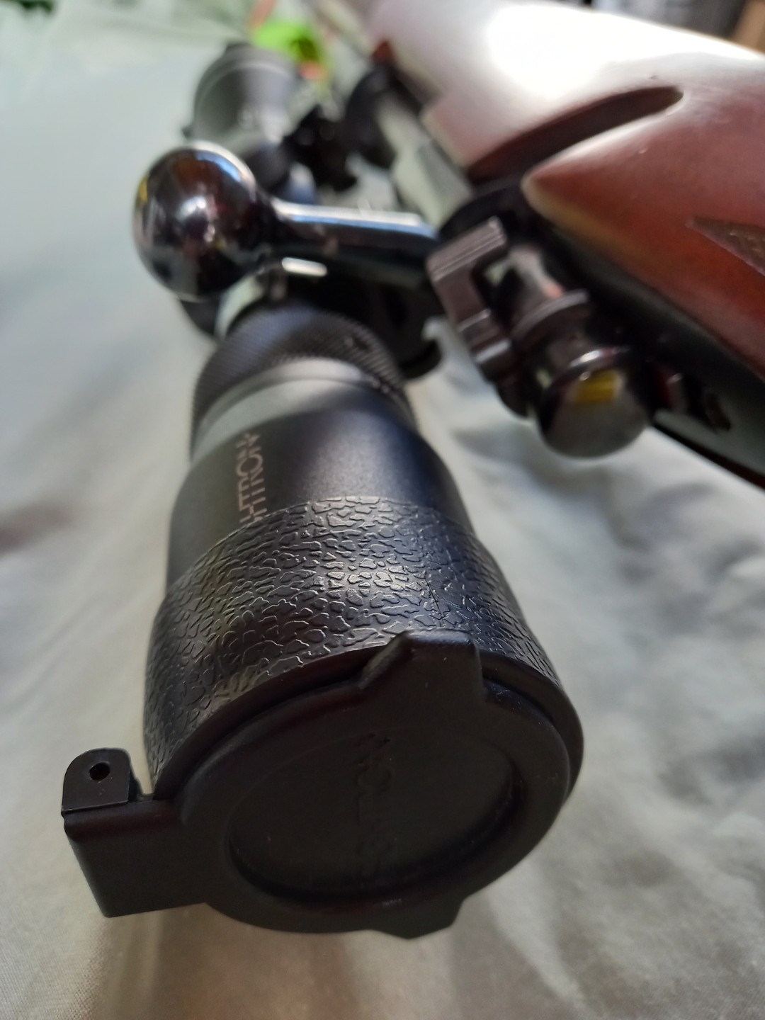

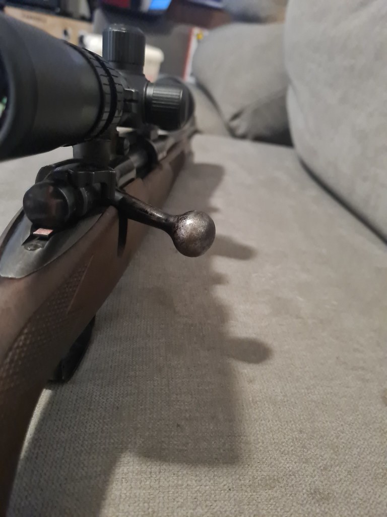

I've just purchased a 1974 winchester model 70 in .222rem off a client and I had a few test shots today.
I chambered a round and the bolt handle didn't drop down to where it would normally and almost sits out horizontal but was definitely closed all the way.
Is this an aftermarket handle or a modified handle that has been heated and bent.

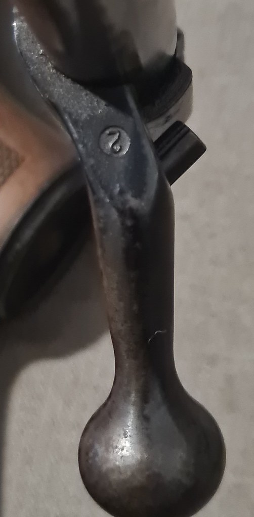

I've also noticed the the handle has a 2 on it. Are there different numbered bolt handles

Re: Winchester model 70 high bolt handle.
Post by Oldbloke » 13 Apr 2021, 9:35 pm
Definitely does not look normal to me. I'll check mine in the morning if it has a number.

Oldbloke wrote:Definitely does not look normal to me. I'll check mine in the morning if it has a number.
That'd be awesome. Every one I've looked at online seems to sit down in the groove.

Post by bigpete » 13 Apr 2021, 9:50 pm
Not normal with mine

Post by LawrenceA » 13 Apr 2021, 9:51 pm
Chances are the 2 is just a mold number for the casting or forging of the handle.
I thought a M70 had a 90 degree bolt swing.
That would put the bolt handle almost vertical and would possibly foul the scope. Also if you look at the bolt handle slot in the woodwork. Basically it is not required.
Looking at this
https://www.youtube.com/watch?v=pBFbDyD7KMo
at 2.41 it does appear to stick out like that
Does it function OK?
From memory the bolt handle is integral or fixed to the bolt body on the Winchester. Not removable like a Tikka T3 or some others.
If it is an issue then I would suggest that you remove the bolt if you can and uncock it.
Then see how the handle would fit in the stock by lining up the cocking piece.

Post by bigrich » 14 Apr 2021, 4:37 am
That bolt is not right. I would take that rifle to a gun smith and get it checked out. Something is off
Posts: 6637
Post by Wm.Traynor » 14 Apr 2021, 9:32 am
For a start, there is no checkering on your bolt-knob, unlike mine. There is no number in that position on mine. My bolt handle goes all the way down to the bottom of the cut-out in the stock, when closed. In pic#1, yours does not go any where near it.

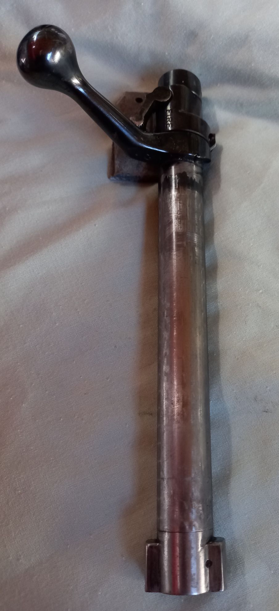

Post by Oldbloke » 14 Apr 2021, 10:46 am
Some pics.
Either it isn't locking all the way.(part only)
Or the bolt handle has been bent.
Handle is fixed to bolt and cannot be removed.

It's certainly not locking correctly. It sits up near the scope like the other photos.
I queried it when I took a few test shots because it didn't feel right and he said it's never locked all the way down.
I'll have a good look over it with a borescope today. May have an obstruction somewhere.

Post by Emberskies » 21 Apr 2021, 5:02 am
Couldn't sleep so I just had a quick look and the front action screw was interfering with the locking lug. I'd say years of tightening has caused the screw seat to be compressed into the timber.
