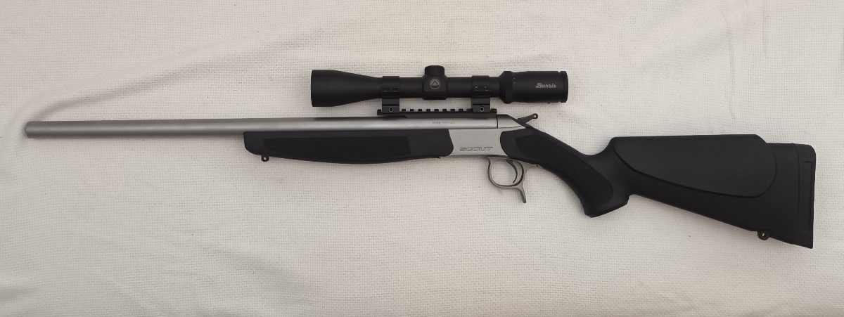

Post by Billo » 27 Jan 2023, 7:06 pm
Not the easiest of rifle to shoot off the bench as the CVA recoil pads are only 20mm thick, starting to find a sweets spot in 1 of the lower lighter loads.
Recoil reminds me a lot like a 45-70 guide gun or 9.3x62 :drinks:
Billo

Post by mickb » 04 Mar 2023, 5:53 pm
Looks interesting mate. so who did the barrel and work for you? And what calibre did the CVA start out as? Thinking here whether a 50AE would be possibe too.
Wondering what else is the action size capable of and at decent pressures. 50-70? 50 Alaskan?

Post by Billo » 05 Mar 2023, 11:16 am
mickb wrote:Looks interesting mate. so who did the barrel and work for you? And what calibre did the CVA start out as? Thinking here whether a 50AE would be possibe too.
The CVA started life as a 44 Magnum, Swan did the work. Anything is possible with these actions if your stupid enough :lol:
It has killed 2 scopes and Ive had to upgrade to a steel rings and rail combo. Oh yeah the plastic forend blew up a week ago but I have since repair it with Loctite and Fibreglass. Ive got it shooting a few inches high at 100yd and it an inch or so down at 200yd. Hoping to put something tasty on the ground in the coming month :thumbsup:
Ive also managed to grab some 700gr casties to test.....

Post by Billo » 07 Mar 2023, 8:15 pm
Hey Mickb Ive been tempted by a Bighorn but they just arent in my price bracket.
I can get Hornady 300gr FTX, 350gr & 500gr XTP locally. I can also get 330gr HRBC but they are leading a little as I'm pushing them over 2200fps. I might do some plinking loads with them and run em at 1100fps, sort of like a bunny round.
Now that I think I've sorted the recoil/scope slipping issue I plan on working towards max loads. Im glad I went with a 22 inch barrel, just a little more speed and it doesnt throw the barrel up like a guide gun does. :thumbsup:

Post by mickb » 08 Mar 2023, 5:09 pm
Why were the scopes slipping/dying mate? 500 is a big calibre but should be no more dramas than a 45-70 or 338 mag etc. Not really at the level of scope killers like a 460wby

Post by Billo » 08 Mar 2023, 7:23 pm
mickb wrote:Why were the scopes slipping/dying mate? 500 is a big calibre but should be no more dramas than a 45-70 or 338 mag etc. Not really at the level of scope killers like a 460wby
So I started by sacrificing a Jap made 2-7x35 Tasco and I discovered the rings and scope were not cutting it. Changed to a Burris FF2 3-9x40 that was spare and it struggled also
New Bergara steel picatinny rail, Warne steel ring and an old scope Loopy 6x was the next upgrade. Scope has survived and no slip detected. Energy is around 36-3800ft lbs, but I would like to bump that up to max.
Corbon have a published 400gr loads doing 2340fps from a 22 inch barrel, thats about 4863 ft-lbs, just a wee bit more than a 45-70 ;) :drinks:
