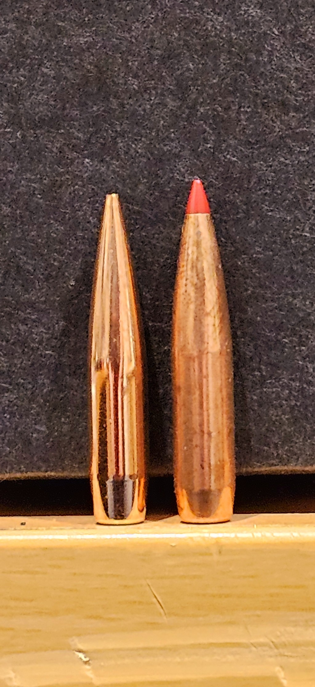

Post by deye243 » 06 Oct 2024, 7:58 pm
He should use these on the left

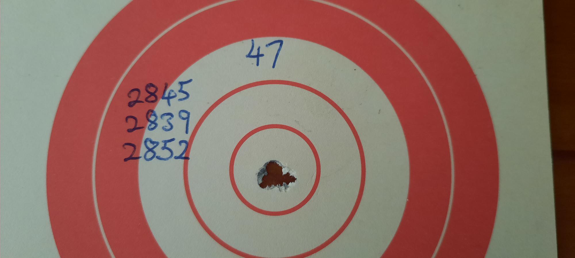

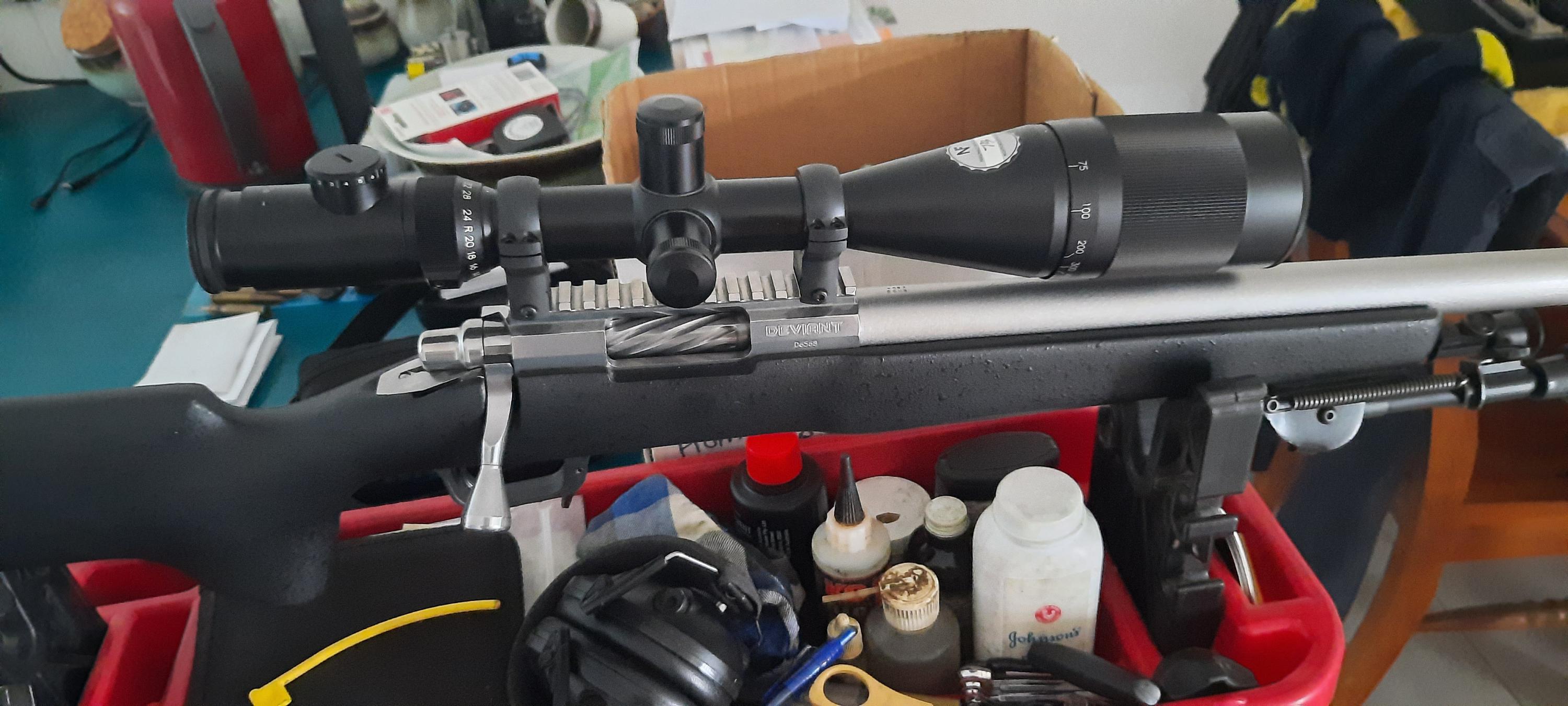

Yep you can remove the binder plate in an AICS magazine and gain more cartridge OAL. But in some actions you will run into feed issues with certain projectiles. Even so that extra length doesn't close the gap from 6.5 Creedmoor to a 6.5 PRC by any significant amount. Still going to be 200 to 300 fps away using ADI powders.
My own 6.5 Creedmoor on a Defiance action with 47 grains of Reloder 26 and 140 ELD M pictured below gets a bit closer. Mild load and can go to 49 grains for over 2900 fps but accuracy drops off. Good but still a long way off the 6.5 PRC. Same gun with magnum bolt in 7 SAUM makes the CM look pedestrian. Both barrels are used in Sporter Hunter open class as it states "all other guns meeting specification but not a commercial factory rifle", or words to that effect. They opened Pandora's box and till the rules say otherwise i will run this rifle.

Post by deye243 » 17 Oct 2024, 11:04 pm
Haha yep ....... I'm sensing a bit ofa challenge here so when the temp gets up a bit I will except as my barrel is marginal in temps under 25*c with the 144 hybrid but the funny thing is it will shoot the 147eldm in temps as low as 15*c go figure .
Posts: 2824
Re: 6.5 PRC how good is this cartridge
Post by Wyliecoyote » 18 Oct 2024, 7:22 am
[quote="deye243"]Haha yep ....... I'm sensing a bit ofa challenge here so when the temp gets up a bit I will except as my barrel is marginal in temps under 25*c with the 144 hybrid but the funny thing is it will shoot the 147eldm in temps as low as 15*c go figure .]/quote]
Add half a grain of powder or screw the tuner out one or two clicks.
