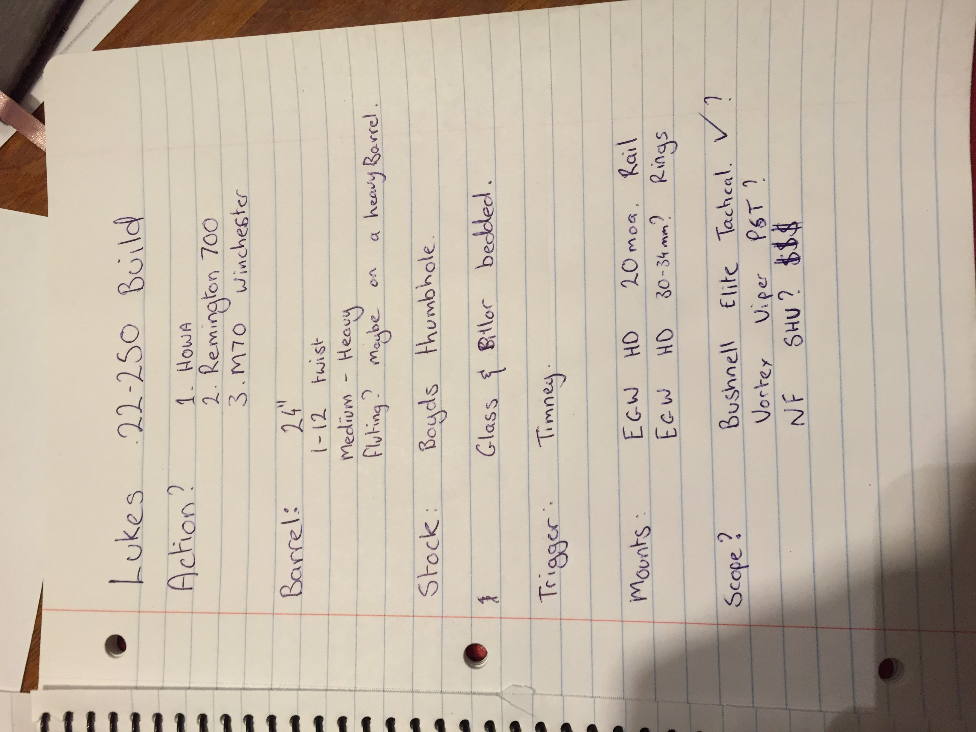

Post by MalleeFarmer » 04 Mar 2016, 7:22 pm
I may consider the .22-250ai but really don't need more velocity than from the .22-250rem.
I have sort of decided on a custom build by a smith.
Here is my current list trying to go on a budget but not "cheap" ok so it may cost me a bit but if I source everything I need over the next 6 months all I'll get the smith to do is install the barrel and crown it and maybe true the action a little bit.
Some Questions if anyone would care to give me some input.
1. Which action of the ones listed and why? I'm leaning toward the howa but finding them is a pain and I don't want to buy a rifle just for the action.
2. What weight barrel. I want accuracy but not a straight barrel. Would a number 5 contour be ok? Or should I be looking at a Remington Varmint style/contour.
3. To flute or not to flute?
4. Which scope of the 3 listed or give me another suggestion.
TIA.
Regards
Luke
MalleeFarmer

Post by brett1868 » 04 Mar 2016, 8:17 pm
I'm about to lodge a B709 to bring in my barrel and action in from the U.S so if you would like a Lilja barrel let me know in the next week and I'll get it added onto my paperwork as it'll save you some $$ on export permits and shipping. I'm thinking to buy several barrels in the one hit over there and sell off the extras when they arrive to assist in recovering some of my costs.
Here's a link to various contours available from Lilja so you can see what's available
http://riflebarrels.com/barrel-contour-data/

Post by Varmtr » 05 Mar 2016, 12:22 am
MalleeFarmer wrote:I may consider the .22-250ai but really don't need more velocity than from the .22-250rem.
TIA.
Regards
Luke
Luke your list is pretty much what my 22-250 is. I also tossed up with a AI or standard and overall the standard would do the only real benifet going AI is slightly better case life.
Mine is a Rem700 been accurized and a TSE fluted Rem varmint 26" S/S barrel with a 1:12.
Scope Vortex PST 6-24x50 SFP MOA with Ken Farrell rings and base.
Rifle basics trigger set to 3oz and David Tubb speed lock kit.
Stock is a laminated thumbhole made by Ken Noye.
So far haven't managed to test any reloads yet but with Hornady Superformance it shoots under a 5cent coin at 100y.
Varmtr

Post by GLS_1956 » 05 Mar 2016, 1:34 am
I'd go for the Remington action, I'm sure you'll have it "Blueprinted", and being a round action it is easy to bed well.
Barrel wise I'd go for a stainless steel with flutes. I'm told the fluting adds stiffness and aids in cooling get the weight or profile you like.
The stock is personal choice, I like wood, laminated of course.
Of the scope brands listed I've only used, have only seen, Bushnell. So I'm not qualified to give advice.
GLS_1956

Post by MalleeFarmer » 05 Mar 2016, 6:32 am
Varmtr what was your reasoning for 26" barrel was there a benefit for incresed velocity? I was thinking of going to 24" for a slightly stiffer barrel and a little less weight. Also how do you like the TSE barrel they are Australian are they not?
GLS I would prefer the howa mainly because of the integral recoil lug and square receiver. I have one already and have bedded it with no issues. But at this stage my Local shop owner recons he can get me a Remmy so ill be happy with that too. I also have bushnell scopes but I keep hearing all the good things people are saying about vortex scopes and thought I might try one out? Also a fluting doesn't really add stiffness from the contour its cut from but decreases weight and aids cooling via more surface area similar to the fins on an air cooled engine.
MalleeFarmer
Posts: 625
Re: Varminter Build or Factory buy
Post by Gwion » 05 Mar 2016, 6:53 am
Personally, I'd go the m70 action, that's why I've been looking at the Montana range. Why? It's like a hybrid of a Rem700 and a Mauser. Easy to bed, easy to work on if ever needed but still controlled feed, excellent safety and extraction.
I'd be inclined to go a varmint weight barrel, wouldn't bother with flutes because all said and done they are more flash than function. There's a whole conversation there but I won't start it. My choice would be Trueflite. Mainly because they are good to deal with, have excellent comp pedigree and are on the money both literally and with their turn around on orders. That said, Brett's offer with the Lilja would be tempting as well.
Also, have long think about splashing out on a GSR stock. Yes, they cost quite a bit more than the Boyds. I've had a Boyds for about 2 years now and a GSR is on my short list of upgraded if the cash is spare anytime soon. Don't discount the benefit of being able to adjust the stock to your shooting position on the fly.
I don't think you need 20moa rail for that rifle between 300-600.
Anyway. Mine's just another of the many 2 bob bits I'm sure you'll be thrown before your build is done. Have fun with it.

Post by MalleeFarmer » 05 Mar 2016, 7:29 am
Cheers for the heads up on the GRS stock Gwion. I will check them out. Also I know fluting is more form than function but it still looks cool and even a slight benefit in cooling in my books is good. Also I agree I don't need a 20moa rail but I may as well have it as I can still zero at 100 and then I have the option of going out much farther I figure they're the same price and no drawbacks in my mind for a 20moa. Also cheers for the heads up on AU BBLs I will see if I get an email back from TSE. I will also check out truflite yea I was in NZ last year they're very Nice people at least in the country areas where I went. I recon we should annex it and adopt their gun laws! If not I'll try to get a confirmation from Brett on the lilja.

Post by <<Genesis93>> » 05 Mar 2016, 8:13 am
Ha.... NZ is already part of Aus... just have a read of s6 of the Constitution . ..
Fluting a given barrel reduces it weight AND its stiffness. Period
Action....consider the maker that offers various port options on sporter or target action.... savage... the action, floating bolt head, round action and switch barrelable too..
<<Genesis93>>

Post by MalleeFarmer » 05 Mar 2016, 10:19 am
No sorry I don't want a savage action and my reasoning is completely.. Well... Unreasonable. I can't get past the name savage it just sounds like it should be rough unrefined and nasty. I know it's just a name and it may be that I don't know what I'm on about. But I just can't do it. I know there are those who swear by them and will defend them to the death but hey if we were all the same what a boring world it would be!

Post by MalleeFarmer » 05 Mar 2016, 12:31 pm
Just an update I have almost completely decided on a howa action as I can buy a second hand rifle Reasonably cheap definately cheaper than a new custom R700 copy or M70 copy.
MalleeFarmer
Posts: 625
Post by Gwion » 05 Mar 2016, 1:34 pm
Nothing wrong with going the Howa option. Get it trued up a bit.
Post by MalleeFarmer » 05 Mar 2016, 5:48 pm
Yes I will get it trued. I have decided I will take my time and save up to build it properly. I looked at those Montana actions they look great. But I don't think I could afford a custom action. I think I will go with those GRS stocks had a look online and they look awesome.
