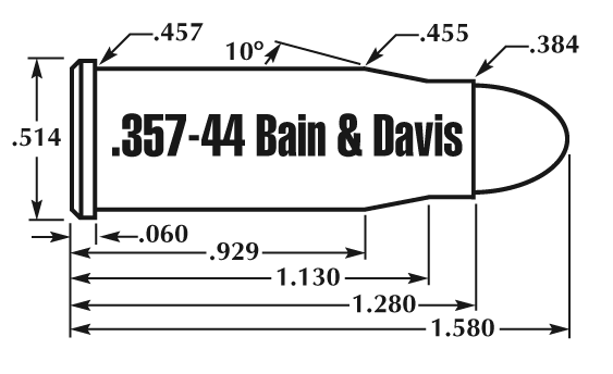

Is this the beast
357-44 Bain & Davis3.gif (11.31 KiB) Viewed 22402 times

andym79 wrote:Is this the beast
That's the one, 44Mag necked down to 357. Common cases, Common projectiles, Making an interesting cartridge without the supply problems of the past.
