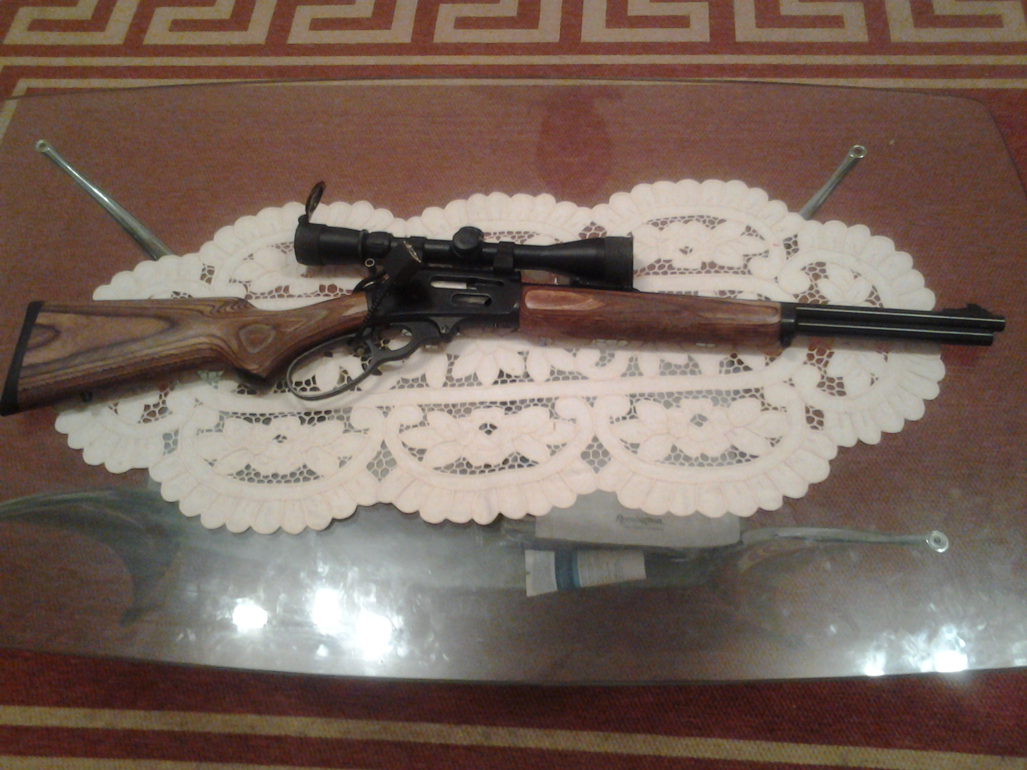

Post by pomemax » 08 Oct 2016, 6:01 pm
i went to the range today so i took 30/30 it has a sitron 3x9x40 fire 5 shots of my elbows on the bench at 50 m with factory ammo bet the goats and piggys dont know i have not played with it
samsung5 028.jpg (901.37 KiB) Viewed 12478 times
3030 (Mobile).jpg (49.57 KiB) Viewed 12478 times
