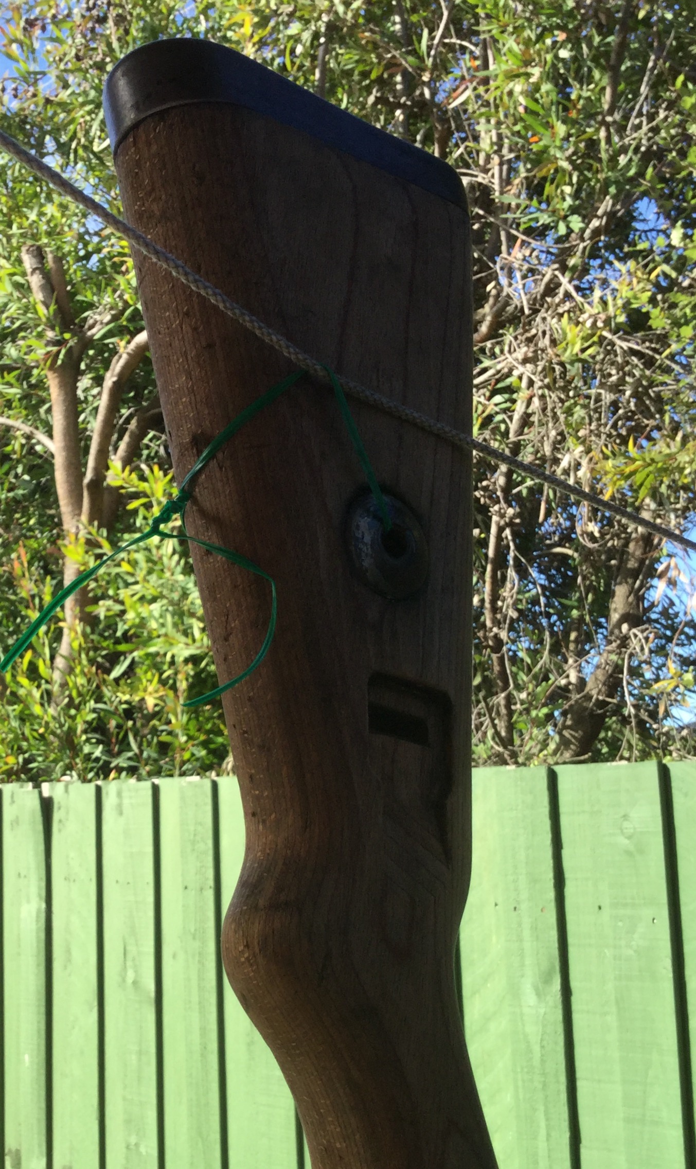

Post by Squiddy » 05 Apr 2016, 1:34 pm
I think its a k98k.
I think I'm going to restore the stock back to original. I'd say the biggest problem is disassembly and reassembly - Not sure if I trust myself to do it.
Especially with the band on the front of the barrel/stock. I wonder how much taking it apart and putting it back together will affect the accuracy??

Post by Squiddy » 09 Apr 2016, 9:20 pm
Soooooo, I had the barrel/action out when I started the stock restoration and started giving the metal work a good clean.
I've got some hoppes bench rest copper solvent, I put through a wet patch, waited 25 mins, and about 30 wet patches later they're still dark blue and green.
I understand this is probably common with ex military rifles, but how many patches is this going to take?
Squiddy

Post by Chronos » 10 Apr 2016, 9:26 am
Is the stock walnut or laminated? If it's laminated I'd avoid acetone as it may weaken the glue in the laminate
I recently cleaned up an Israeli Mauser in a laminated stock. What you might find is the bedding at both the tang and the recoil lug need repair. My stock was cracked from the rear action screw down into the wrist so I wedged open and decreased it all then glued it with epoxy and clamped it all back together.
At the recoil lug what happens is if the action screws come loose the action flogs on the cross bolt and damaged the timber there. I reglued the timber around the cross bolt as well then when it was all set I cleaner it up and sanded the entire stock. Just deciding what to coat it with but stabilising the stock made a big difference to accuracy

Post by Squiddy » 10 Apr 2016, 10:04 am
I think it's a laminate.
It's hung up to dry at the moment, no visible cracks. Lugs and plugs all look good and are not loose.
Going to sand very lightly with 400 grit and steel wool shortly.
What stain do I use?
Also, is tru oil considered a no no? Am I better of doing a stain then a blend of 50-50 acetone and BLO?

Post by Chronos » 10 Apr 2016, 10:05 am
Also about the bore, it'll take weeks of scrubbing to remove all sign of copper from the bore. To be honest I wouldn't bother. The bore is most likely in such poor condition it'll shoot poorly until it coppers up again. When I got mine I had a go at cleaning it. Gave up after a week of letting it soak overnight in Boretech Cu and patching it out before a scrub and another soak
Some guys run moly coated bullets in an attempt to smooth out the bore but it's hardly worth it. Mine shoots A4 sized groups at 300m with iron sights and that's certainly for for purpose for a service rifle
