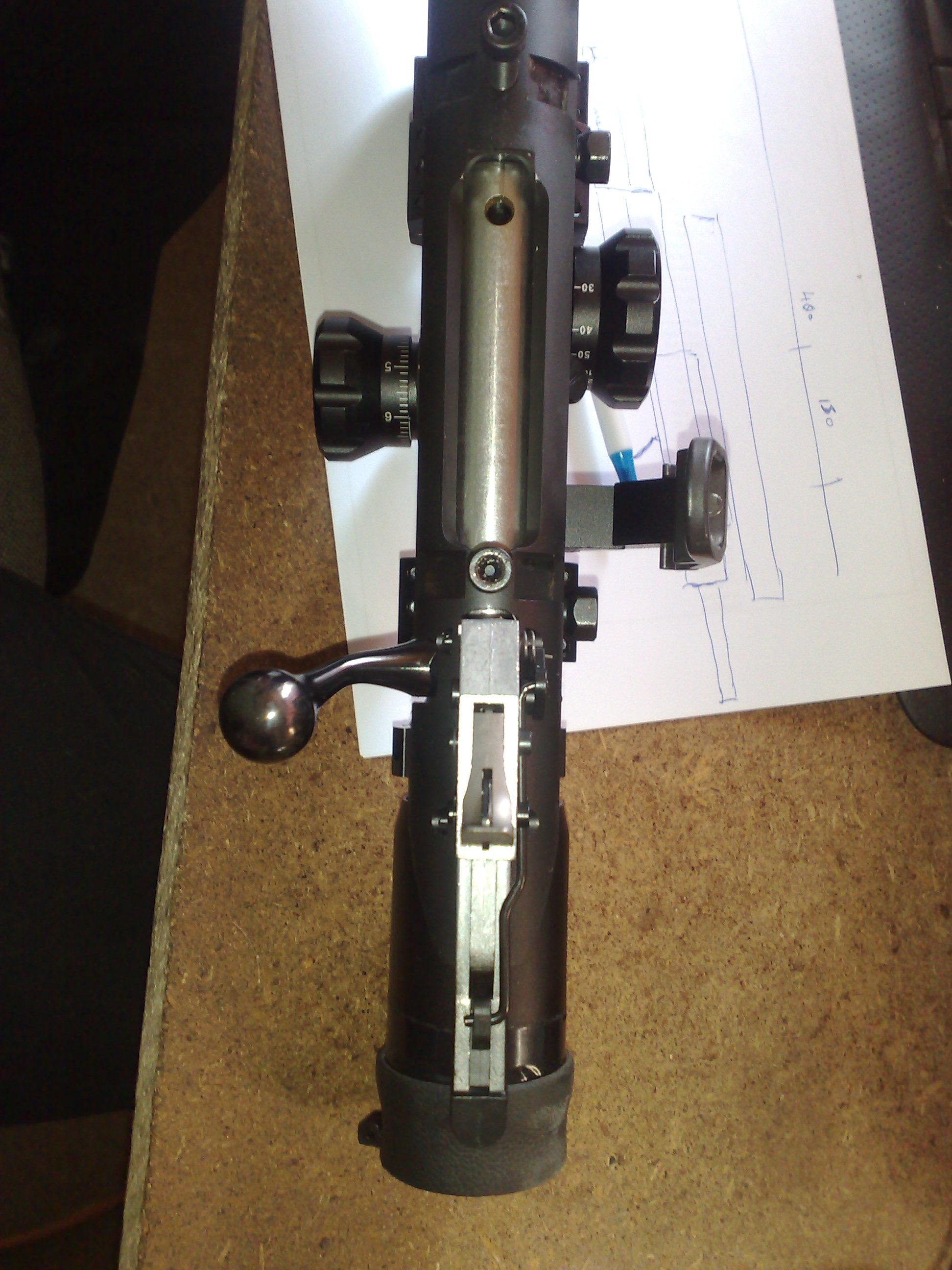

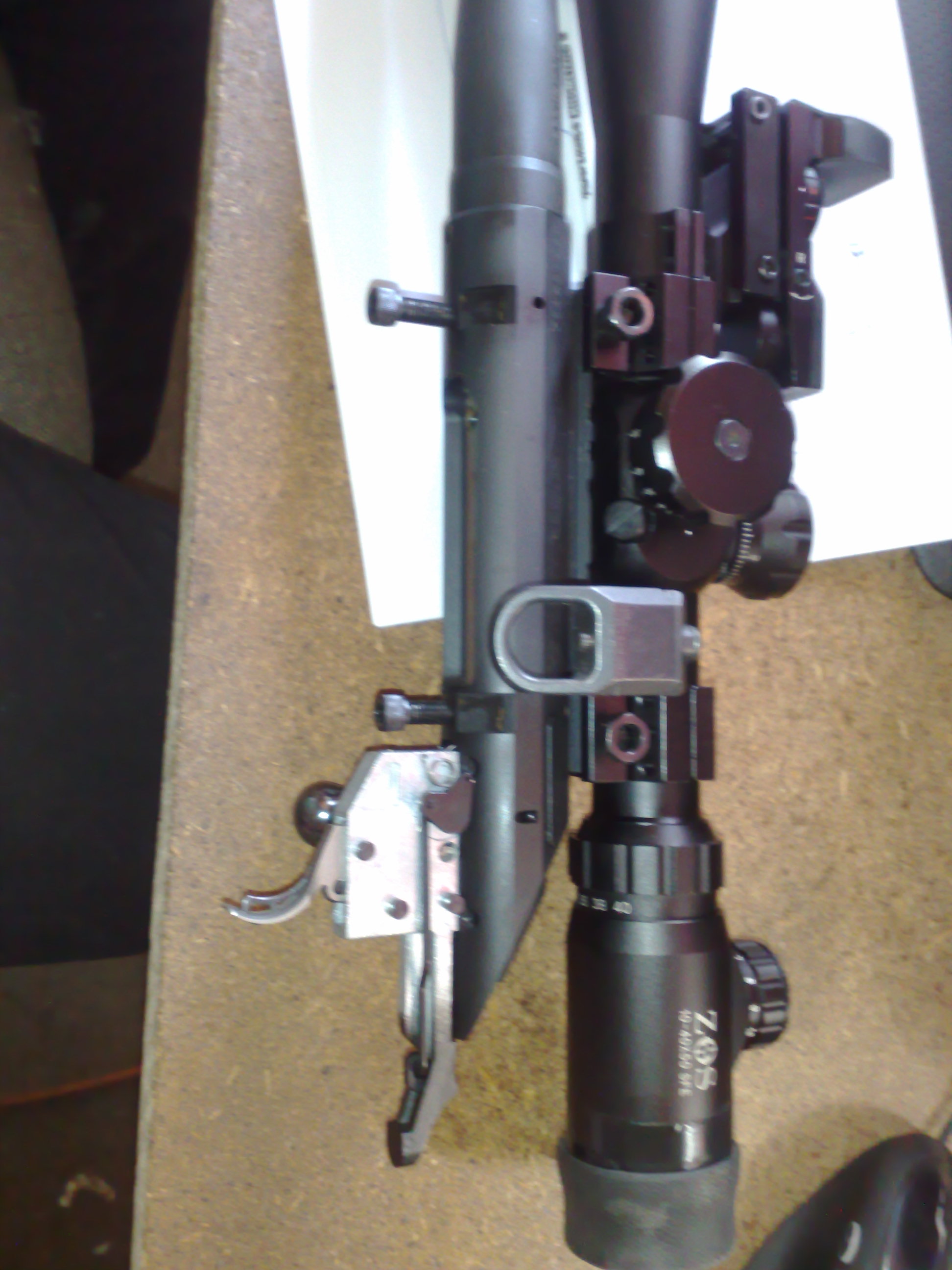

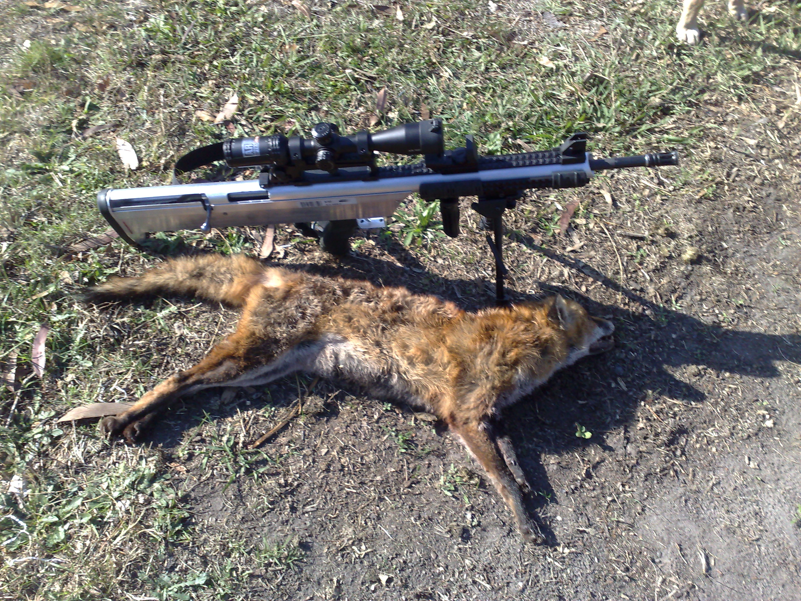

I built my own bullpup chassis for my Ruger Americans. I know it's legal in Victoria but it's illegal in NSW/ACT and probably most other states.
Designing similar for my milsurps as well.

bladeracer wrote:I built my own bullpup chassis for my Ruger Americans. I know it's legal in Victoria but it's illegal in NSW/ACT and probably most other states.
Kudos for the work there, but bullpup not quite what i had in mind either, sorry.

Not sure what you mean, but all my MDT LSS chassis are short action Ruger Americans.

I wasn't actually suggesting it :-)
Just putting it out there that you could simply make exactly what you want rather than wait for somebody else to make something that's close enough.
There was surprisingly little effort involved. I banged it together pretty quickly as a proof of concept rather than put a ton of work into building something that didn't actually work very well, and was very impressed with it.

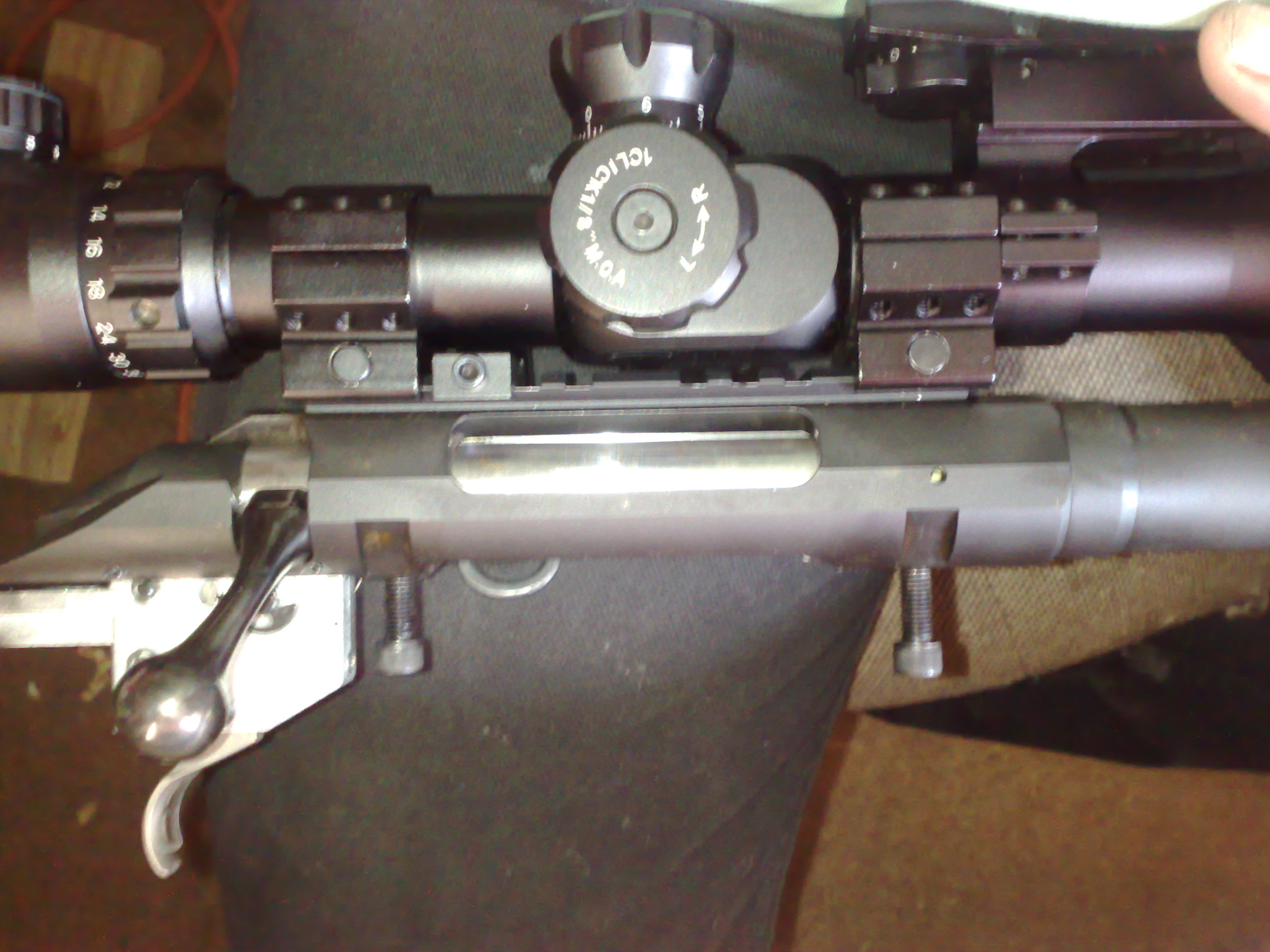

The mounting holes refers to the rail mount under the forend. I didn't bother on my MDT's, I just drilled and tapped standard rails under the forend and on the left side of the receiver.

Mine was made with hand tools, mostly done in my lap with a hacksaw, files, drill bits and taps.
Yeah, i figured that out also when i went back for a second and third read on the site...seems the LSS is the only chassis they make suitable...

The Ruger American receiver is a tube with cut outs that lock over two removable recoil lugs that fit into the stock and the receiver simply rests on those as the only contact points between the action and the stock - even the trigger pack does not contact the stock and the magazine does not contact the receiver. MDT supply two recoil lugs for their chassis. The CZ527 is similar to an old-school military action with a bottom plate. That makes it much harder to fit to a chassis, but certainly not impossible. I'm designing a bullpup chassis for the Mosin Nagant M91/30 currently which is a similar design. It is far more complicated than the Ruger and I'm bouncing several different ideas around to simplify it.
