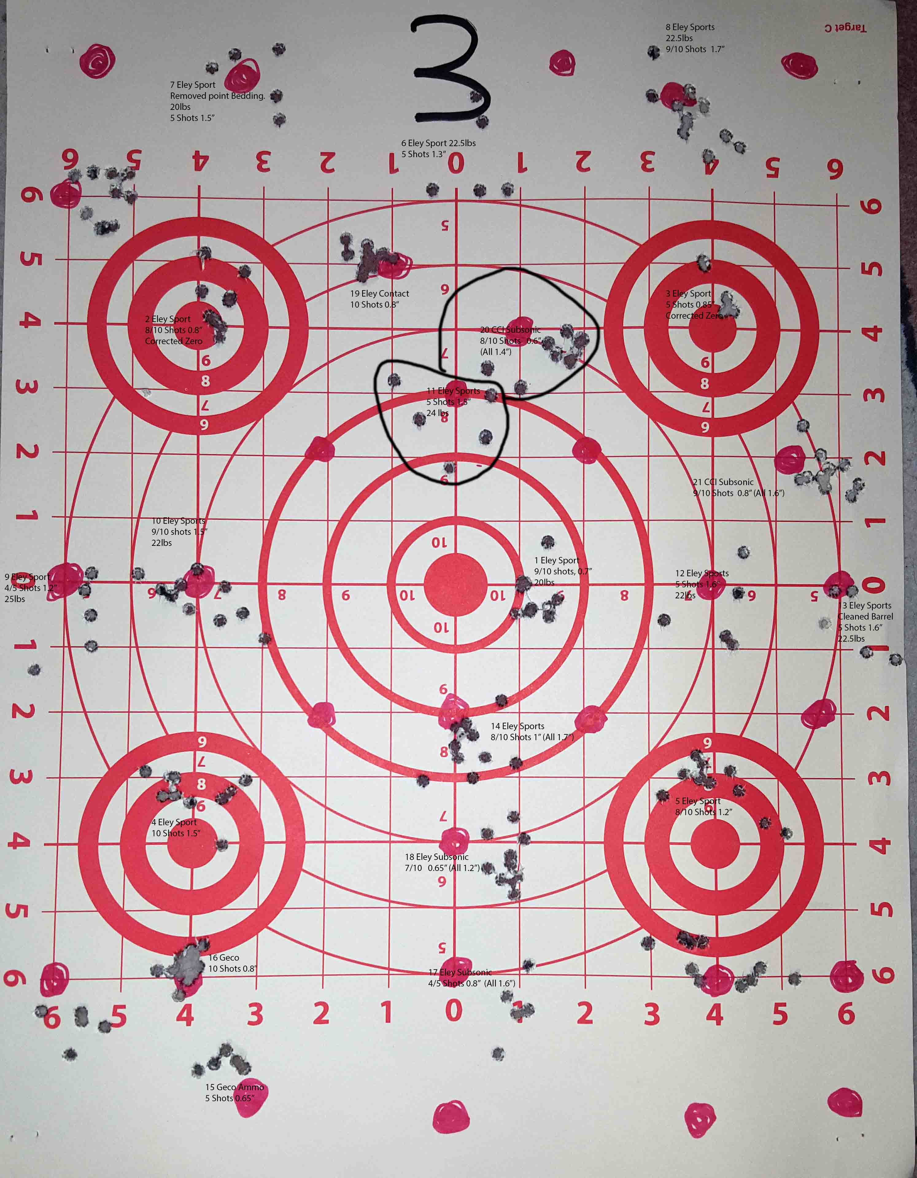

It'd be good to know what about my large groups implies technique. I seem to get good groups fine when switching to some ammo, but the general trend is for a spread to develop after ~2 mags. The best being my 0.4inch with CCI subsonics. This is something I can't find any info on. It sees like warming up should increase accuracy but it's been like 6 times in a row now that I've always had the reverse.

Here you go! Start from the middle and then work clockwise from the top left.. roughtly.
Link works now too:
http://metneia.com/wp-content/uploads/2016/12/20161211-Target-1.jpg

This "dime size groups all day" is something I've heard from many CZ people who boast about their fingernail sized groups. I feel that mine is inconsistent and perhaps on the knife edge of acceptable. Maybe your's is on the edge of good / good enough. But many people get great results all day too.
I''d live to know why I get these fantastic groups in the first few 1-2 magazines with 3 ammo types, and then can't replicate the result for the next 5 hours? The barrel doesn't get hot, or even much above cold, but perhaps it only works well stone cold? lol fortuantely, the Gecco ammo seems to work pretty good. Eley Subsonic is alright as well with 20%+ fliers.
But if I got those great Gecco groups with my warm barrrel.. I should try shoot them first next time! I could go competitive with some cheap Gecco ammo and icepacks for the barrel :P

Are you sure it is not you that is the main influencing factor in those groups? I do not know where you shoot or if you have access to a range on a daily basis. Go to the range and shoot your 2-3 "good" mags and then go home do not modify the rifle in any way and just run a slightly oiled patch through through the bore. Next time you go to the range wipe the bore and just shoot your 2-3 mags again. Is there a difference?
Shooting 100's of rounds in a sitting is not necessarily good medicine for the body. You get tired and do not even notice it. Accuracy can suffer. We all look for some reason; more often than not it is the operator and not the machine. When shooting off the bench, just like out in the field, consistency matters. I find the bench more so, and if you keep changing you technique to shoot better you will be just chasing your groups. Think about each shot and check that you are sitting in the same position, eye relief , hold etc, they all count. I seldomly shoot off a bench and I have trouble being consistent over multiple groups. My first groups are fine my rifle is zeroed and then I know everything works. I go up to the house and call it quits. Out in the paddock I may shoot a hundred rounds a night but they are in ones and twos and so no long concentration periods. No dramas. I am no paper shooter and do not want to be. More power to them. It is hard work to be consistent.

Yeah I'm pretty sure it's not me and there's a few reasons.
1. I shouldn't get tired after 2 mags. I don't feel tired
2. I feel very stable in my aim and gentle trigger pulls. I have a 24x zoom with no paralax so I can see my target and movement well.
3. When switching with my gf, I could suddenly get great groups with her range rifle and good ammo, and she suddenly couldn't with mine.
4. The Gecco ammo worked great after my spread from <1" to well above 1". Spread went back out to above 1" after that. This is with the Eley Sport ammo that the shop said was great and that I got small groups with initially.
5. Other shooters at the range group just as well as me with my rifle and worse (3 experienced shooters so far).

Tomek. AS i said above, you are adding too many variables into too small a sample to get any definitive answers as to what you and your rifle are capable of.
The pics you posted first off showed what seemed to be double grouping. The pics you most recently posted showed no signs of double grouping. What they did show were some classic signs of varying grip, scope relief, etc, etc. These things you will be too inexperienced to notice; particularly when you are constantly changing everything during a session; and you don't have to "feel tired" for them to be creeping in quickly. Slight changes in forearm grip, trigger approach, head position, breathing/timing, etc. can all lead to variations in group size. Your scope may also be set up poorly: slightly off square, too far back, etc, etc.. Don't assume that because someone at a gunshop set it up that it is right for you. This could also count for others having issues with the rifle. Not saying it is so, just that it is a possibility.
Until you learn some patience and just take one type of ammo to the range, have your rifle set up in one way and concentrate on consistent technique while shooting at least one whole box of the SAME ammo, you will not get anywhere. In a recent post you said, "i want to get the most out of the outing". I was trying to hint that changing everything will not give you the "most".
My final suggestion to you is to bed the rifle (because the easier bolt cycle and a lack of double grouping tells me that there IS some form of bedding issue there and it is having an effect on the rifle AND you, ie: putting you off), pick what you think is the best ammo so far and shoot the b'jeezuz out of the rifle while concentrating on FORM. One session concentrate on trigger pull, etc., etc.. After a couple of thousand rounds over a month or so, you will find that you are a lot better than you are now.

Yes I got a new scope actually and it seems the same. It can't be me as when I switch rifles with my gf (range rifle) on the range, the good/bad groupings stay with the rifle, not the shooter. This Geco ammo looks promising as well so I will check that out too. Also, I've had 3 other experienced shooters try it while it's in spray mode and they were just as bad / worse than me. All walked away sheepishly saying its a fussy rifle, not used to trigger etc.etc. People hate blaming CZs... but scoff when I offer to sell it to them!
Anyway, I will focus on the Geco, Eley Subsonic HP and CCI subsonic HP next time. If it shoots ok I may just stick with it. The dilemma for hunting is.. do I shoot with a round nosed accurate round, or a less accurate hollowpoint? I'd be aiming for headshots..

The trouble with the expectations is that I go get those tight groups initially and then they spread out. Could actually be a good thing compared to the opposite. What would be the use of a hunting rifle that takes 5-10 shots before it shoots straight?
Actually when it comes to fast centerfire, it's recommended to fire a couple of fouling shots before a hunting trip - this is also somewhat of the purpose of your sighters before a match. After a thorough cleaning, most cartridges/rifles throw a couple of flyers before they really settle down. This is due to the barrel needing to be being lined to help with obturation. And if I'm shooting lead silhouette loads through my lever, I basically don't clean my barrel (rather just bore snake then an oil patch); it hates being cleaned and groups the tightest without much cleaning at all.
Now speaking 22 rimfire; the 22lr arguably may also fall into the category of "don't clean it". The wax coating shields from leading and also helps with obturation/stabilization (once the barrel is lubed up). For a 22 If anything groups should tighten up after a clean. That's how I run my 22 anyway, and I know many others follow this regime for 22s.
So getting back to your rifle - yes it is quite unusual that your 22 starts accurate and then quickly degrades. Quite the pickle indeed... almost reminds me of the 17hmr (which I believe needs regular and rigorous cleaning to keep it tight).
All that said, heck if you have the budget for it, I say trade it in get yourself a 54 Annie (wipes drool away).
