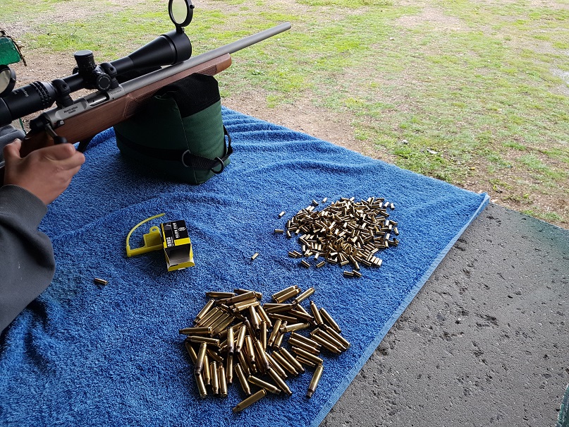

Post by rsj223 » 21 Jun 2016, 9:59 pm
Spent Sunday at the range and went through over 400 rounds, adjusted the magazines before we left home they went ok for 50-70 then started hitting the chamber just a bit to high, re adjusted went ok for 50 + then on only the last 2 rounds the bolt would go straight over all up I adjusted them twice at the range.
Before adjustments were made I traced around the follower so I knew where they started.
Out of a box of 50 there was no pattern, this 5 would all work fine then the next 5 1 or 2 would be crap
I have spent hundreds on ammo and I've had enough and will just sell it I think.
On a lighter note the Howa lite mini action in .223 was shooting under an inch @100 all day.
.22 and .223.jpg (361.15 KiB) Viewed 11034 times

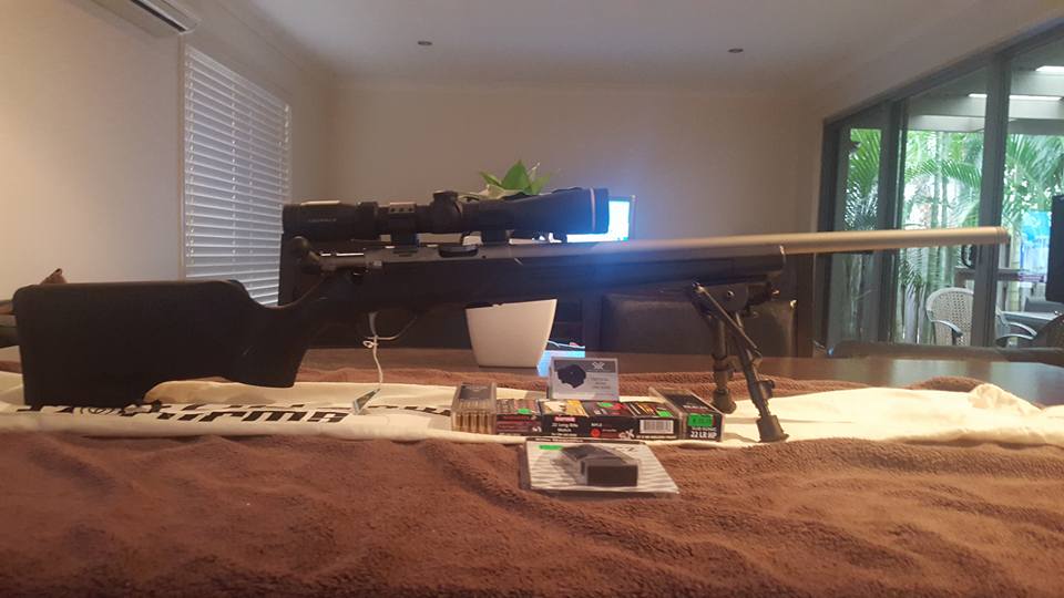

Re: Lithgow LA101 CrossOver
Post by Matt77 » 09 Jul 2016, 5:23 pm
Picked up my new crossover in 17hmr today , leupold vx1 3-9x40 with leupold rings and Harris BRMS BI-pod really happy with it, fit and finish is great,also picked up a CZ 10 round magazine for it hoping to avoid the feeding issues that the 22lr has, so fingers crossed.
Matt77
Posts: 3

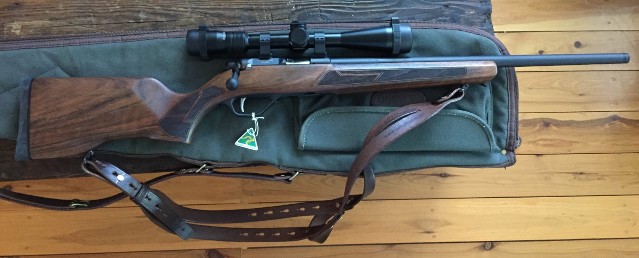

Post by in2anity » 01 Aug 2016, 7:48 am
Given the amount of Lithgow-bashing that's been going on, I thought I'd throw in my 5c. After a one month wait, my walnut black arrived:
walnut black cerakote
This rifle exceeded my expectations. I was able to cut strings at 50m with it, and it shoots superbly offhand. It really demands pairing with some quality glass.
I had one stove-pipe out of 150 rounds - call me old fashioned but given the quality of the rest of this kit, this doesn't phase me one bit. A truly sub-moa 22lr for $1000 is very hard to beat IMO.
Post by wade06 » 01 Aug 2016, 12:01 pm
in2anity wrote:Given the amount of Lithgow-bashing that's been going on, I thought I'd throw in my 5c. After a one month wait, my walnut black arrived
Very nice rifle in2anity, what ammo works best for you?
What scope is that? I ended up getting a Vortex Diamondback HP 3-12x42.
I will be picking up my Walnut/Titanium Lithgow later this week, have seen it in the shop and the stock looks awesome.
The Lithgows look great, shoot well and seem to be really high quality apart from the odd problem with the magazine feed which can be fixed.
I don't mind spending a bit more to support an Australian manufacturer either.
Post by in2anity » 01 Aug 2016, 1:30 pm
wade06 wrote:Very nice rifle in2anity, what ammo works best for you?
I've been mainly feeding it Eley Club - these are consistently sub-moa. They come in at around $12/box.
wade06 wrote:What scope is that? I ended up getting a Vortex Diamondback HP 3-12x42.
I put my Vanguard Endeavor RS 4-12x40; it has a BDC reticle for those longer hold-over shots. Vanguard have only recently entered the market, and they are targeting that rather empty middle-area in the optics market. They make quality scopes that don't hurt the hip pocket so much. I mostly set it to x4 for offhand shooting.
wade06 wrote:.. apart from the odd problem with the magazine feed which can be fixed ...
Precisely my thoughts - this is a problem with the mag, not the rifle, and with minimal effort this can be self rectified. TBPH I'm rather shocked at how customers have responded to this...
