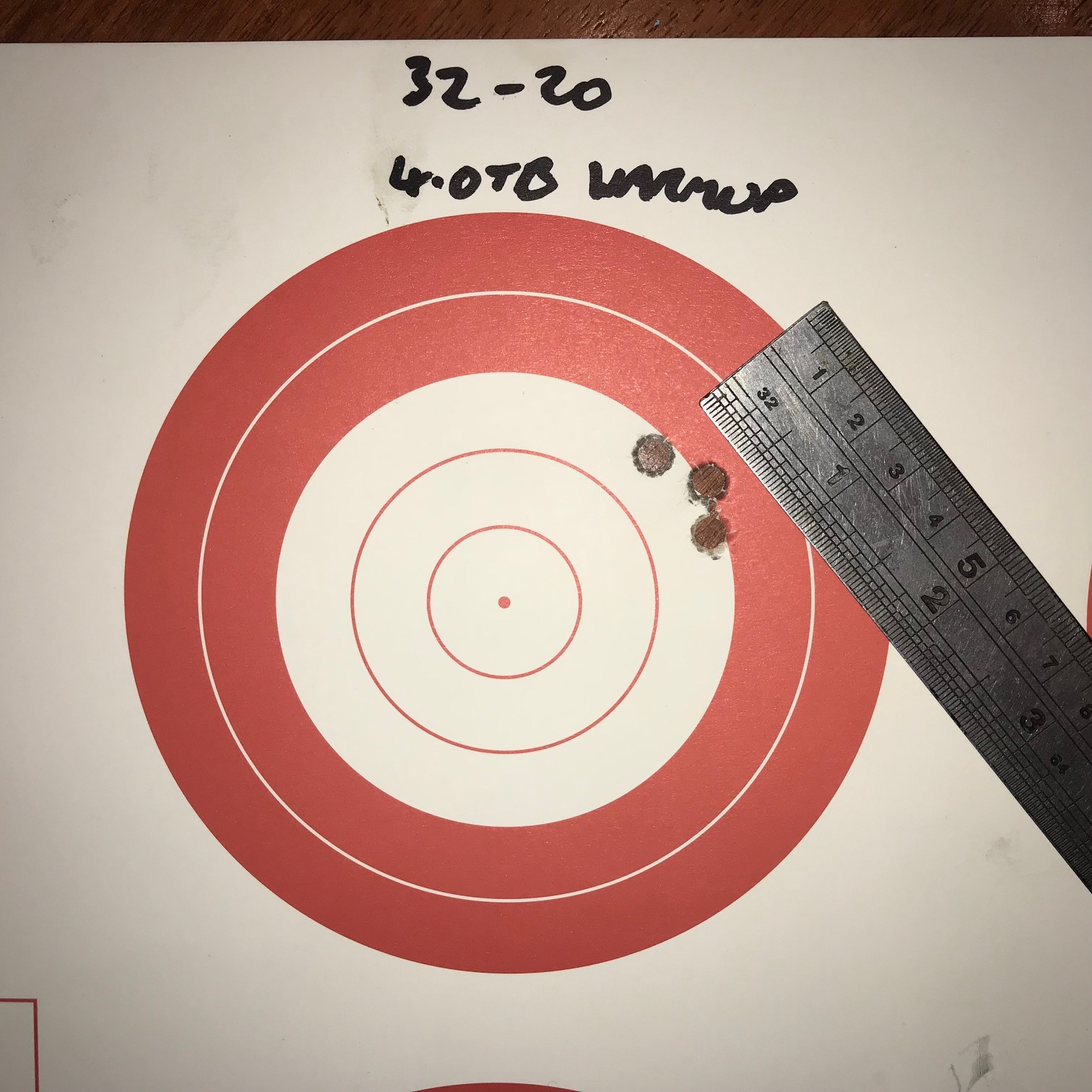

Shot some iron-sighted (front tunnel) 50m groups with a variety of powders, starting with a Trail Boss control group. As much as I'd like to claim it, this 3-shot flouling/warmup group is not indicative of long-string, hot-barrel accuracy:
50m cold clean barrel

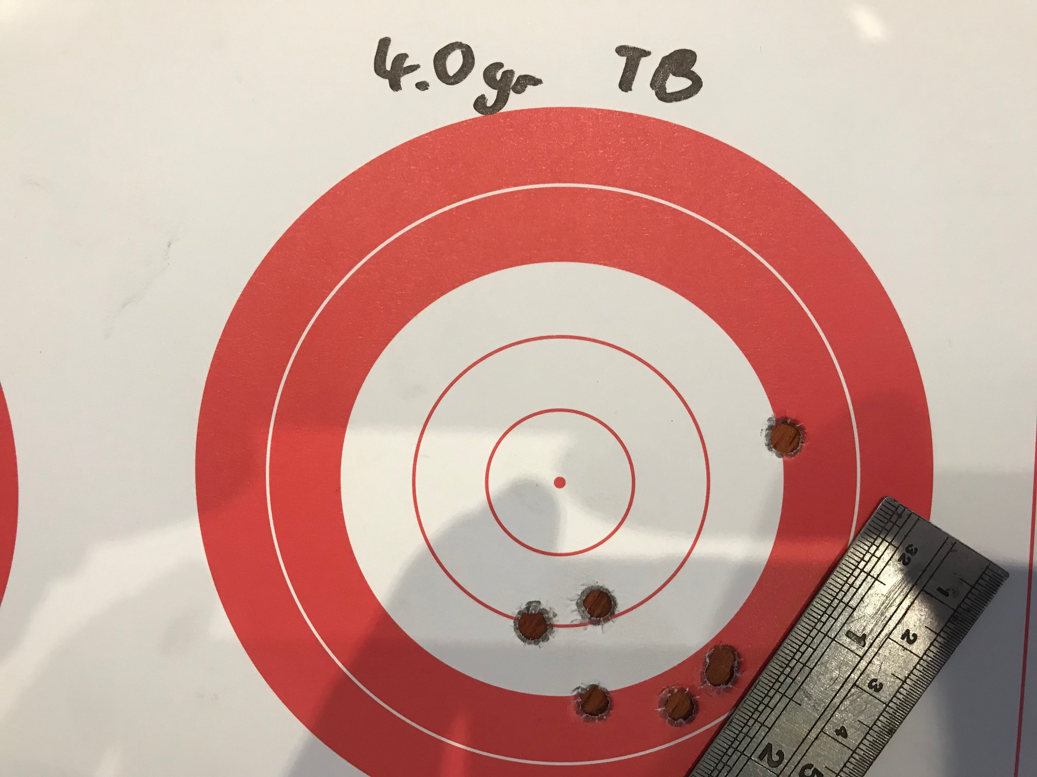

Adjusted my sights: no denying it likes TB loads - as you can see, this group would have been much tighter had it not have been for that pesky flyer.
50m

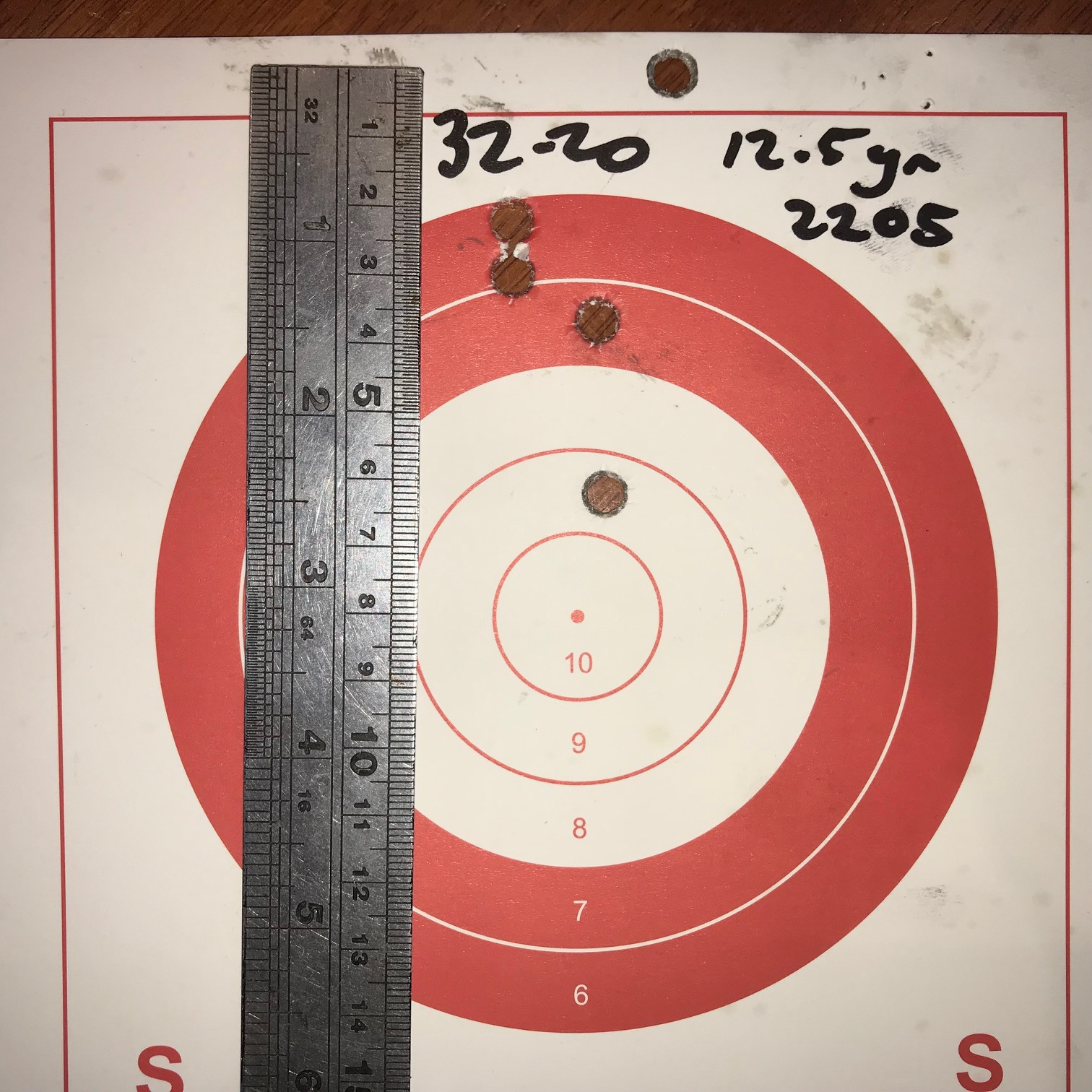

Then I moved on to some AR2205. 2205 didn't shoot as well as TB or AP70N.
50m

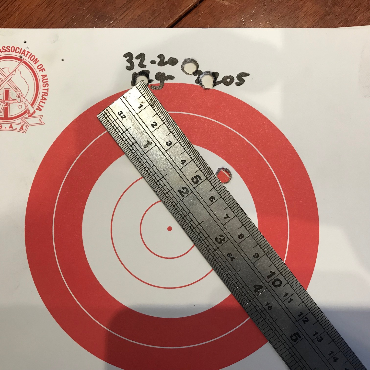

This is actually a 5-shot group - one of the shots is completely high and off the paper... :?
50m

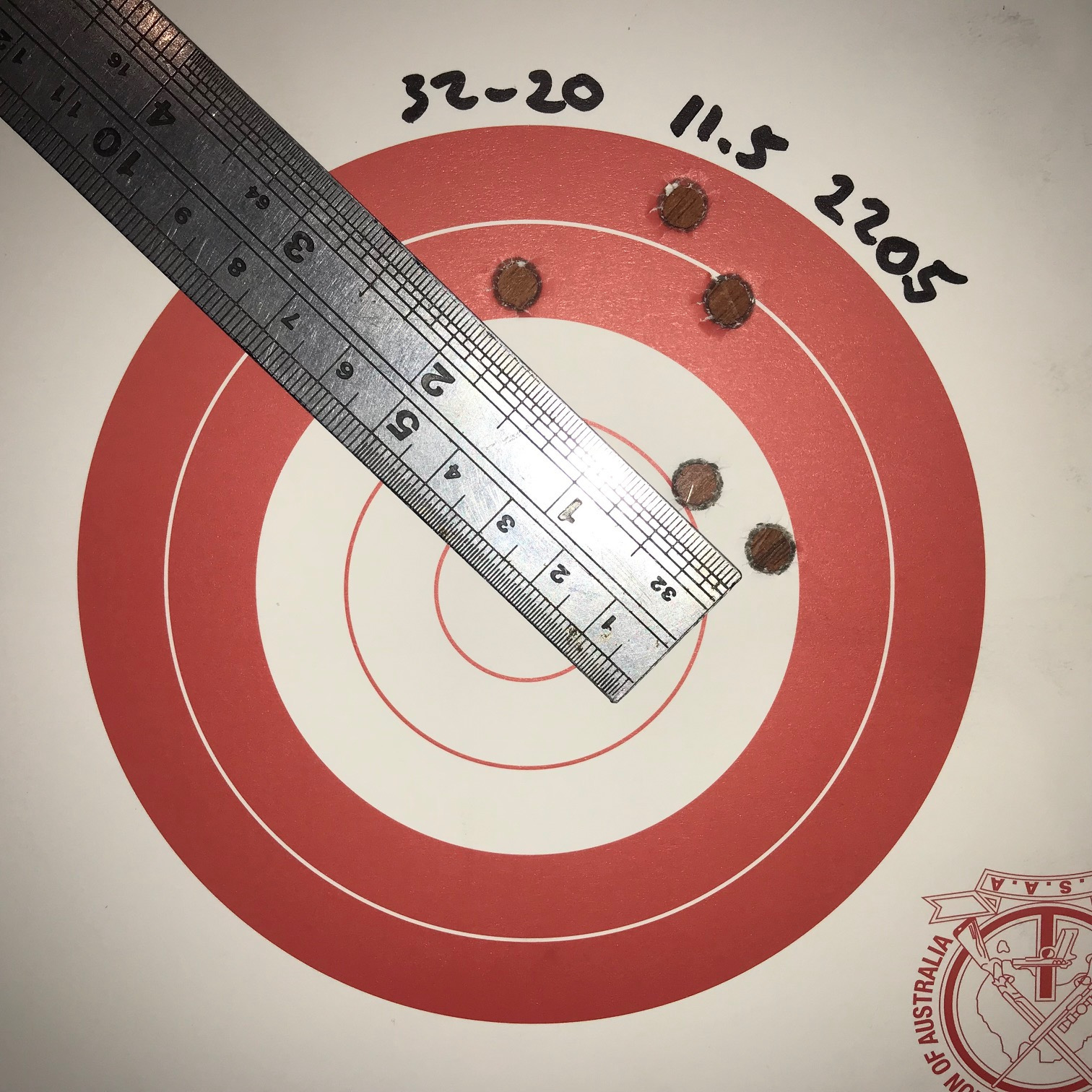

Not very impressive...
50m

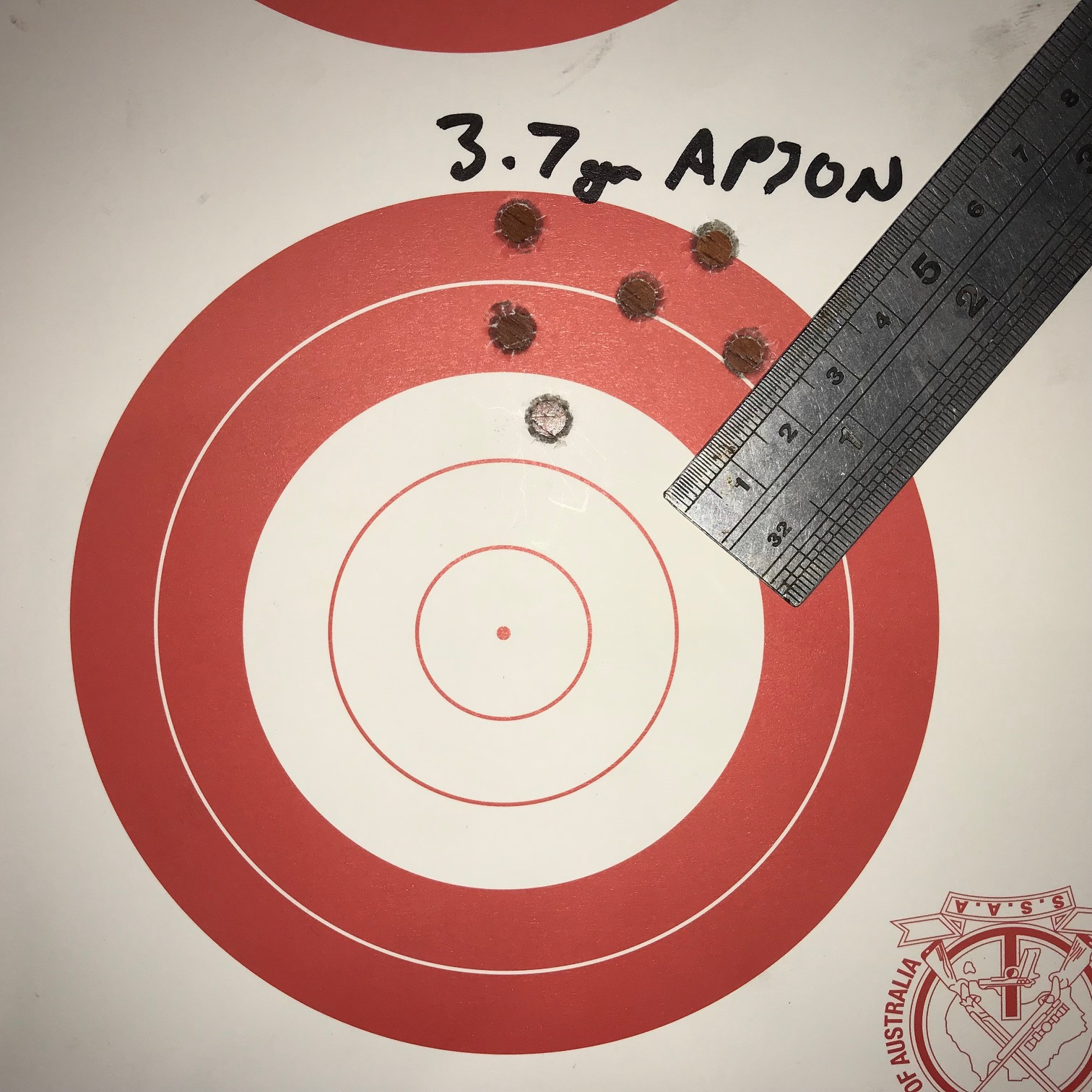

Then on to some promising AP70N loads; I could tell right away AP70N was shooting better than the AR2205...
50m

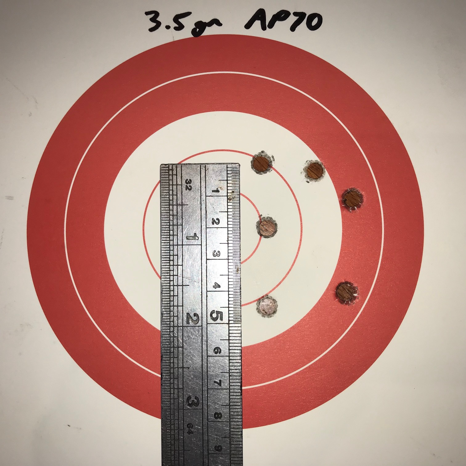

Best load of the day, a tad over 2moa - superb stabilization, negligible recoil. This will be my PC silhouette load.
50m, 2.2moa!

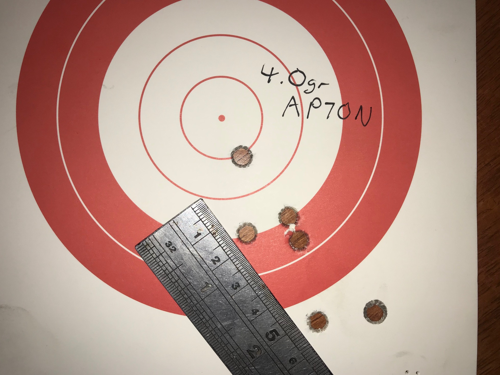

4.0gr opened up a little. In case you were wondering I adjust my sights a whisker to account for the hotter load.
50m, sights down a bit
In summary, I'm happy AP70N shoots better than the AR2205 for two main reasons 1)it's more economical than AR2205 2)it's cleaner that AR2205 (which is advantageous in a 92 action)
