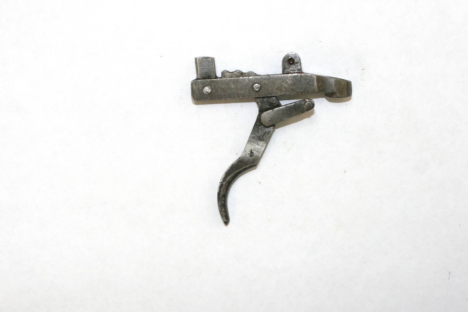

If you can post some good photos of your trigger group we could perhaps suggest some alternatives that might fit without too much work.

Post by bladeracer » 17 Feb 2019, 2:46 pm
BaronBoy wrote:OK, this looks like the only thread dealing with Mannlicher Schonauer rifles that I could find so I will tack my question here hoping someone out there may know the answer.
I have just bought a 1903 6.5 x 54 action (actually one of the Italian made under contract to the Greeks version) with the intention of building a sporting rifle. I am looking to replace the trigger and wonder whether anyone has had experience of doing that and what did they find? From my preliminary investigation, the trigger bears some similarity to a Mauser but I haven't one to compare precisely. Over to you.
Is this your trigger group?

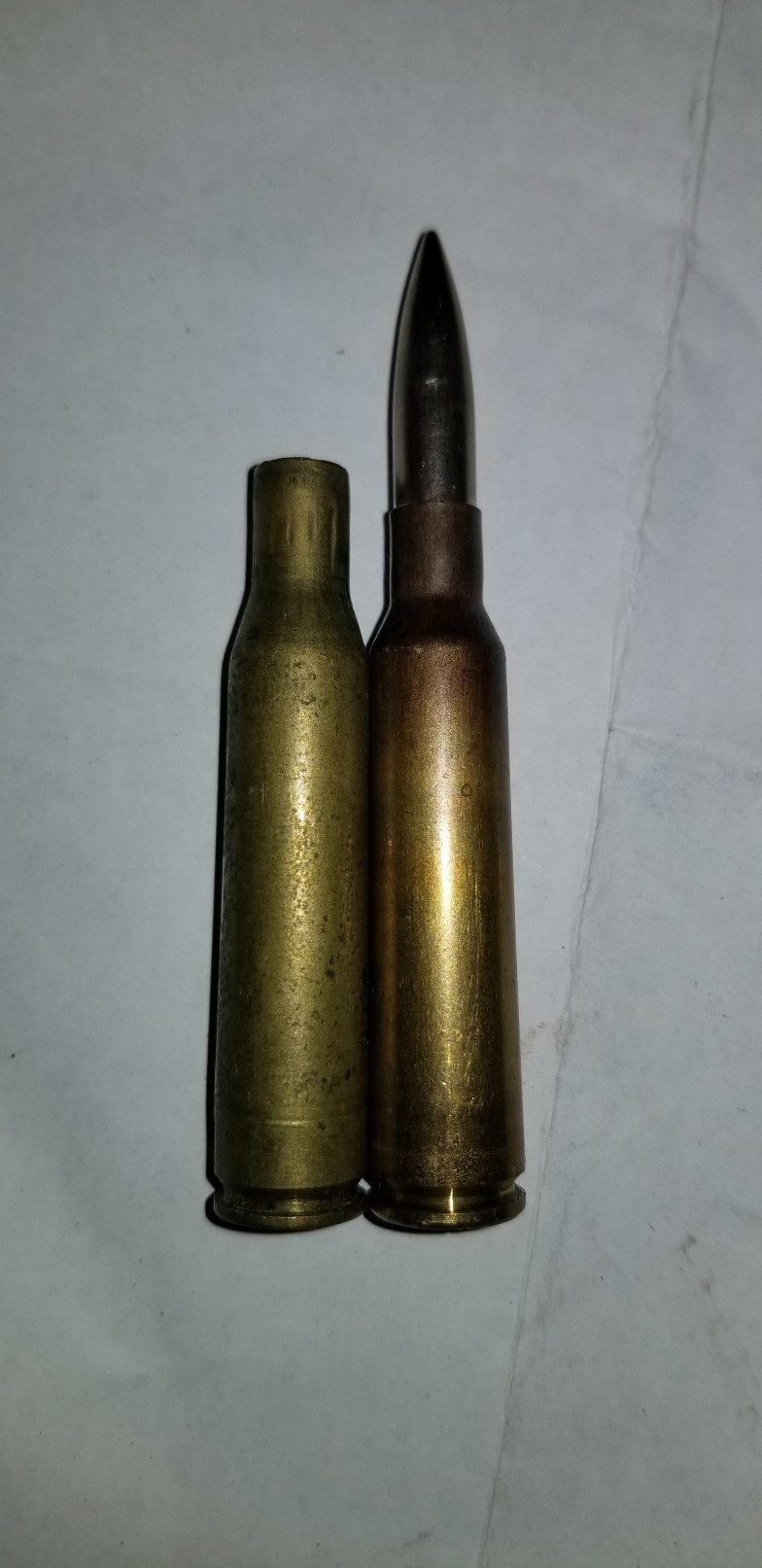

6.5x57mm brass is not so common down here. It's about $4 apiece, compared to .30-06 at 40-cents apiece.
I haven't tried it myself, but if you bump the shoulder of 6.5x55mm back about 50-thou that will probably run just fine. You'd have to run it into a x57mm die to swage the case head down about 10-thou.
This is a fireformed 6.5x58mm from .30-06, and a Norma factory 6.5x55mm.

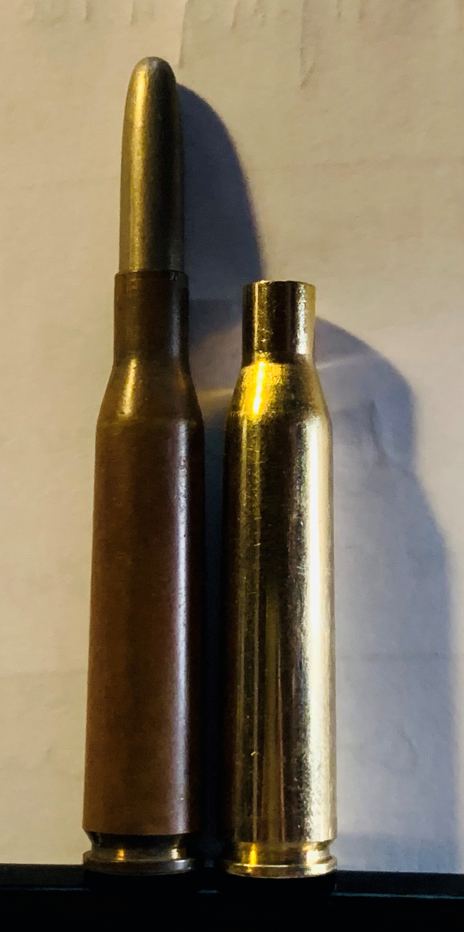

Post by Afmelo » 23 Sep 2021, 3:13 am
I understand that you do not have the 6.5x57 brass availble at a decent price.
Here it is about 57 cents of euro for S&B.
Photo of my brass after a simple passage of the 6.5x58 RCBS die compared to the original military cartridge attached
6.5x57 transformed to 6.5x58.jpg (719.29 KiB) Viewed 10035 times

However, yesterday I finally received 100 pieces of 6.5x58mm brass from DocAV!!!!!
Formed from Bosnian Igman Konjic .30-06 fired brass, primer pockets are crimped.
It doesn't look like the necks have been turned, but I haven't had to with mine either.

After a long wait finally received my new CH4D dies for the 6.5x58 Portuguese Vergueiro Mauser.
Used them to form using 6.5x57 PPU brass, after annealling and it turned perfect cartridges although evidently about 1mm shorter than the original 6.5x58mm.
Just reloaded a few cartridges to shoot tomorrow, should the weather allow.
Kindly find here some photos of my carbine and of the cartridges loaded today (the long cylindrical bullet is a 140gr Lapua Naturalis and the boat tail a 123 gr Lapua scenar).
