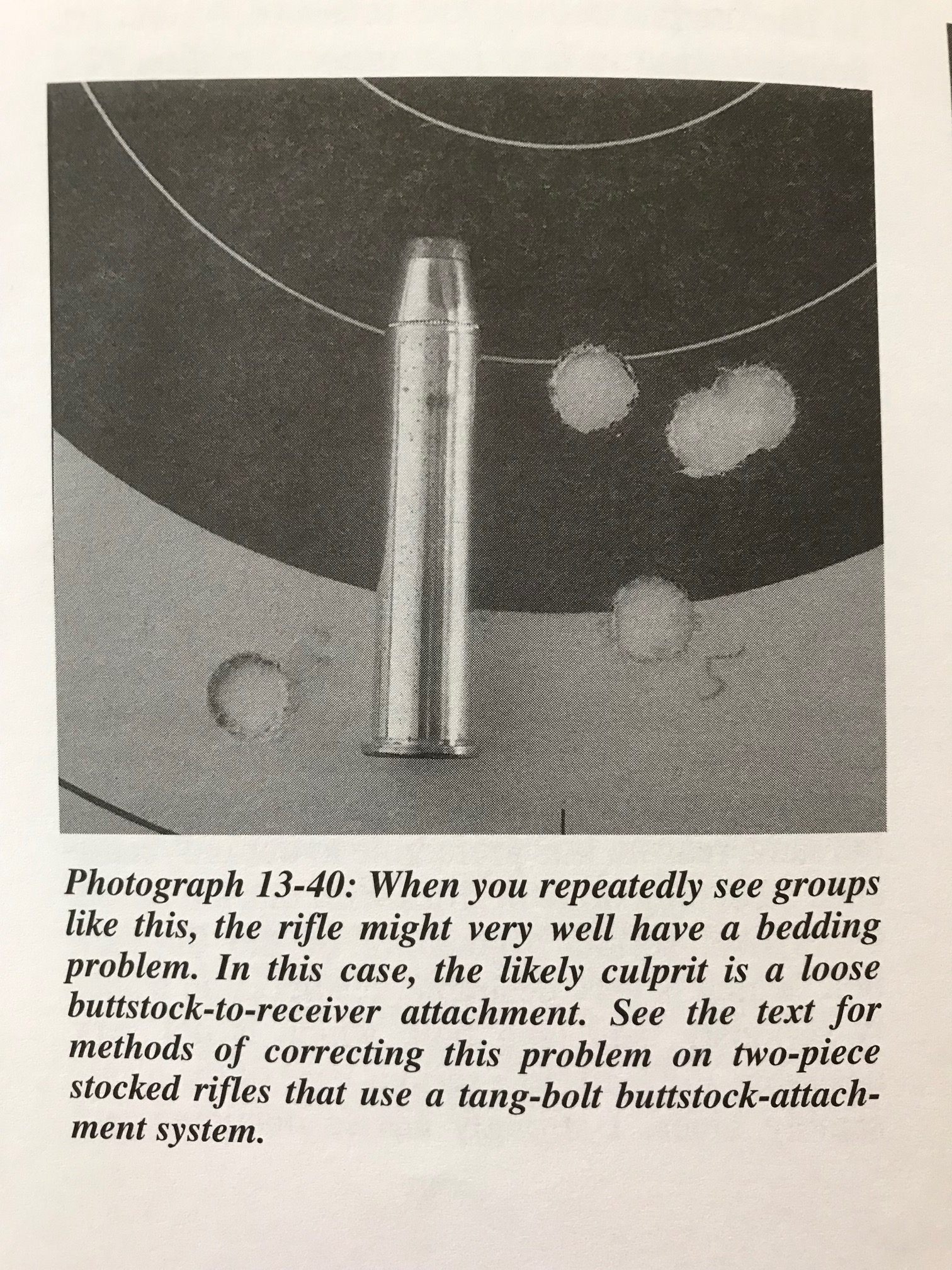

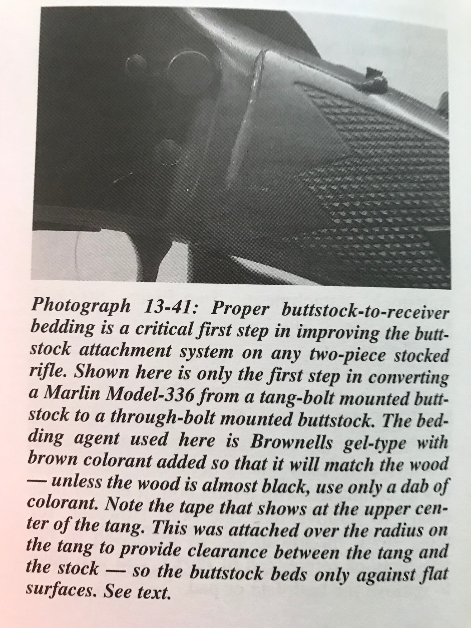

Might be of interest to some of you blokes:

That's interesting about how to fit the the long projections that straddle the tang.

Yw wm! - my understanding is you should not bed the entire length of the tang, more buttstock/receiver contact - the tang should be left alone at least behind and around the tang screw as there is normally a slight amount of clearance here to allow for a bit of give under recoil - otherwise energy will be transferred directly into the timber here and can cause splitting

That’s for sure br! And especially lever guns - they are complex little boogers. One tip I have - make sure you only use a gel-style bedding compound, the runny ones are rather problematic on vertical areas. You can get the acraglas gel kits on Brownells.
