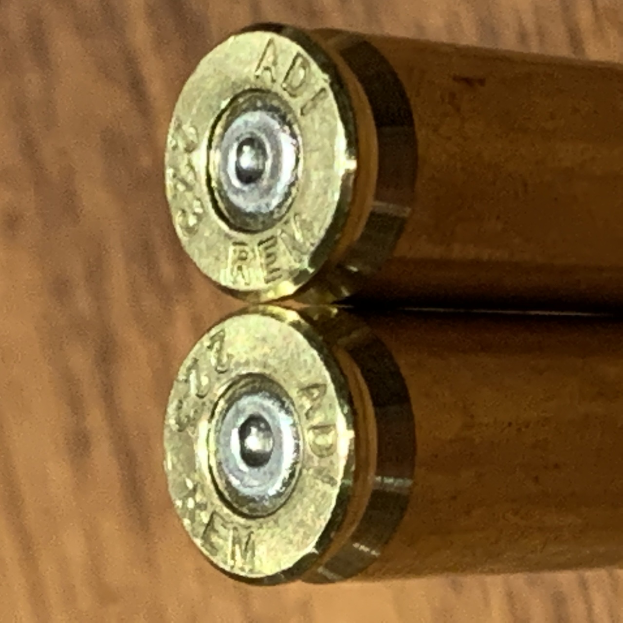

Post by straightshooter » 10 Dec 2019, 6:55 am
Posts such as yours get many responses so good luck sorting the wheat from the chaff. It is a simple fact that some very experienced gunsmiths are clueless as to the detailed intricacies of the ignition process so your average poster should not feel slighted in offering their suggestions.
Looking at the pictures of your fired rounds the primers still look to be reasonably well rounded so pressures don't seem to be excessive although the Sako rounds might be a little hotter than the ADI.
So the cratering and blanking aren't an exclusive consequence of over pressure.
The explanation for the cratering is rather simple. That is that there is sufficient striker impact to ignite the primer but insufficient momentum or energy to support the primer during the ongoing combustion process to prevent extrusion of the primer cup into the firing pin hole. The sharp edges of the hole are what leads to blanking.
Now your picture of the striker mechanism has a couple of telltales one of which you have noted. The other is the rub marks on the cocking piece.
The culprit could be as simple as a spring coil catching on a burr inside the bolt.
Of the may other possibilities the worst would include a crooked firing pin or a crooked bore inside the bolt. But there are other reasons for misalignment dissipating striker energy.

Post by in2anity » 10 Dec 2019, 7:15 am
straightshooter wrote:in2anity
Thanks SS. I'll shoot the harder primers to start, and take it from there. I've got a new FP spring coming, so I might plop that in also (can't hurt). Beyond that, my GS is a can-do kind of guy and a perfectionist - we've been talking he seams eager to take a look

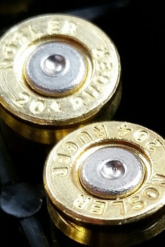

Stix wrote:Hey In2...i hope y'all dont mind if i quietly poke my head in here...
I have a similar problem (not as bad) with a new rifle i shot for first time on weekend...
Figured id throw my pic up here rather than start another thread for the same thing--i hope thats ok... :)
(Need an emoji of a meerkat peering over a rise... :lol: )...
So...these are just Federal primers--it's all ive really ever used...
Shot in a Sako 85 VLS...26.9gr of 8208...Hdy 40gr Vmax.
Had one do this & not fire...but rechambered it & it fired ok second time... ( :unknown: )
Same case-different angle...
Dont feel hot loads, & they are not hot according to ADI-well they're getting up near the top of their list--although some of the cases were getting on their way to full as they are new & were FL sized down a fair way so they were all the same...
I shot 34gr Nos shots & 40gr Vmax, & its only the low end of ADI list that dont crater like these...
My other 204 doesnt do it but is only shooting a mild load of 2208...
So...should i just try these CCI primers...or do i need to get this bolt/firing pin assembly checked...?
Again, sorry to butt in...dont want to hijack...i just see it pointless to ask the same thing in a different thread...

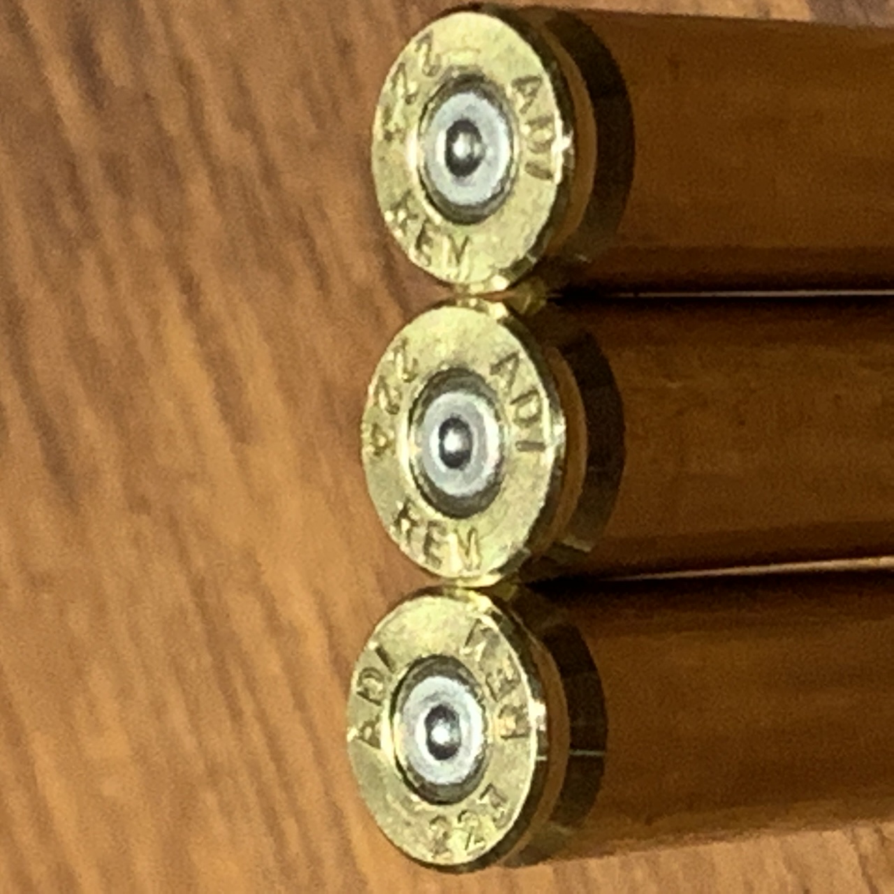

Re: Cratering Primers - Used HOWA 1500
Post by in2anity » 10 Dec 2019, 9:40 pm
BR4 + 24gr 2206H
CCI450 + 24gr 2206H
As you can see, certainly a harder primer made a difference. However l I installed a replacement FP spring (which btw seemed slightly larger and thicker) yet the 25.5gr loads + CCI400 loads still cratered exactly the same, indicating a sloppy FP hole (not the mainspring). Now I have to decide if I should go to the trouble of re-bushing to better facilitate a softer primer...

Post by sungazer » 10 Dec 2019, 10:19 pm
My opinion is, that it would seem a firing pin of 0.080 is not suitable to use on SR primers. The bolt face profile and hole size may also be contributing factors. In general a firing pin 0.062 seems to be better suited to SR primers.
As a side note the ADI brass seems to be a bit different around the primer pocket area as opposed to the Hornady.
As we know primers are not a great indication of pressure however they when they do show the right signs you know they are over pressure. In the top picture 3rd case down those edges are starting to flatten out. The bottom case in the second picture between the 223 and Rem looks like an ejector mark. Need to know history of brass to say much about that or what it really looks like in the flesh.
I would stick with these primers all day long much less concerning than those flow back pictures that look like they are on the point of failure. It would be interesting to look at the cup from the other side once removed.

Post by Stix » 11 Dec 2019, 9:02 am
marksman wrote:quote="Stix"]Hey In2...i hope y'all dont mind if i quietly poke my head in here...
dont want to hijack neither but are these rounds fireformed and neck sized or flsed Stix :unknown:[/quote]
They are formed now marksman
They were new virgin brass fl sized & fired in a virgin rifle.
Most were sized so shoulder was around .002-.0025" short of the chamber...but a few were up to .004" & maybe one or 2 to .005"...so maybe the one misfire was one of them...??...
Maybe i should've made a seperate thread--thought mite be a quick simple answer... :oops:

Post by Stix » 11 Dec 2019, 1:53 pm
marksman wrote:and ps l think you are onto it Stix :thumbsup:
Can i ask again...what is your opinion of the cratering in my instance though...?
Something to worry about...?... (cases re-chamber fine--primer was definately recessed to case head before firing, now flush)
Should i just try those cci primers...?
Here is the pic again to save going back...
Cratering...204/40grVmax/26.9gr 8208/new brass first firing...
2019-12-09 18.16.31.jpg (137.18 KiB) Viewed 8468 times
Post by Strikey » 11 Dec 2019, 3:03 pm
[/quote]
Federal primers are known to be " softer " than most other brands, try the CCI BR4's or Remington 7 1/2 primers if you are concerned about that bit of cratering.
Strikey

Post by flutch » 11 Dec 2019, 5:28 pm
I use CCI in my howa, none of these issues are present. so give what strikey says a go.

Post by Stix » 11 Dec 2019, 6:06 pm
Strikey wrote:Federal primers are known to be " softer " than most other brands, try the CCI BR4's or Remington 7 1/2 primers if you are concerned about that bit of cratering.
Thanks Strikey...
To say im "concerned"--well i dont really know what i am really...lol...
It doesnt happen with any other rifle i have, even hot loads ive tried in my other 204--no cratering at all...however there dont seem to be any other signs these are hot other than this cratering.
I got a box each of both the CCI BR4's, & a box of Federal Gold primers today--someone at the shop said those Federal Gold are also a harder cup & worth a try.
So, unless someone here can tell me different &/or share their experience with these Fed Gold primers, i thought id repeat the same test this weekend with the Fed Gold Primers & if no cratering just buy 100 of them...
Those CCI primers sure are expensive...bloody hell...in comparison to the Federalones theyre some 30-40% more expensive--thats the equivalent of getting a free cheap mixer bottle of Scotch thrown in with the Federals... :lol: ...(& cash is very non-existant for me at the moment)...
:unknown:
