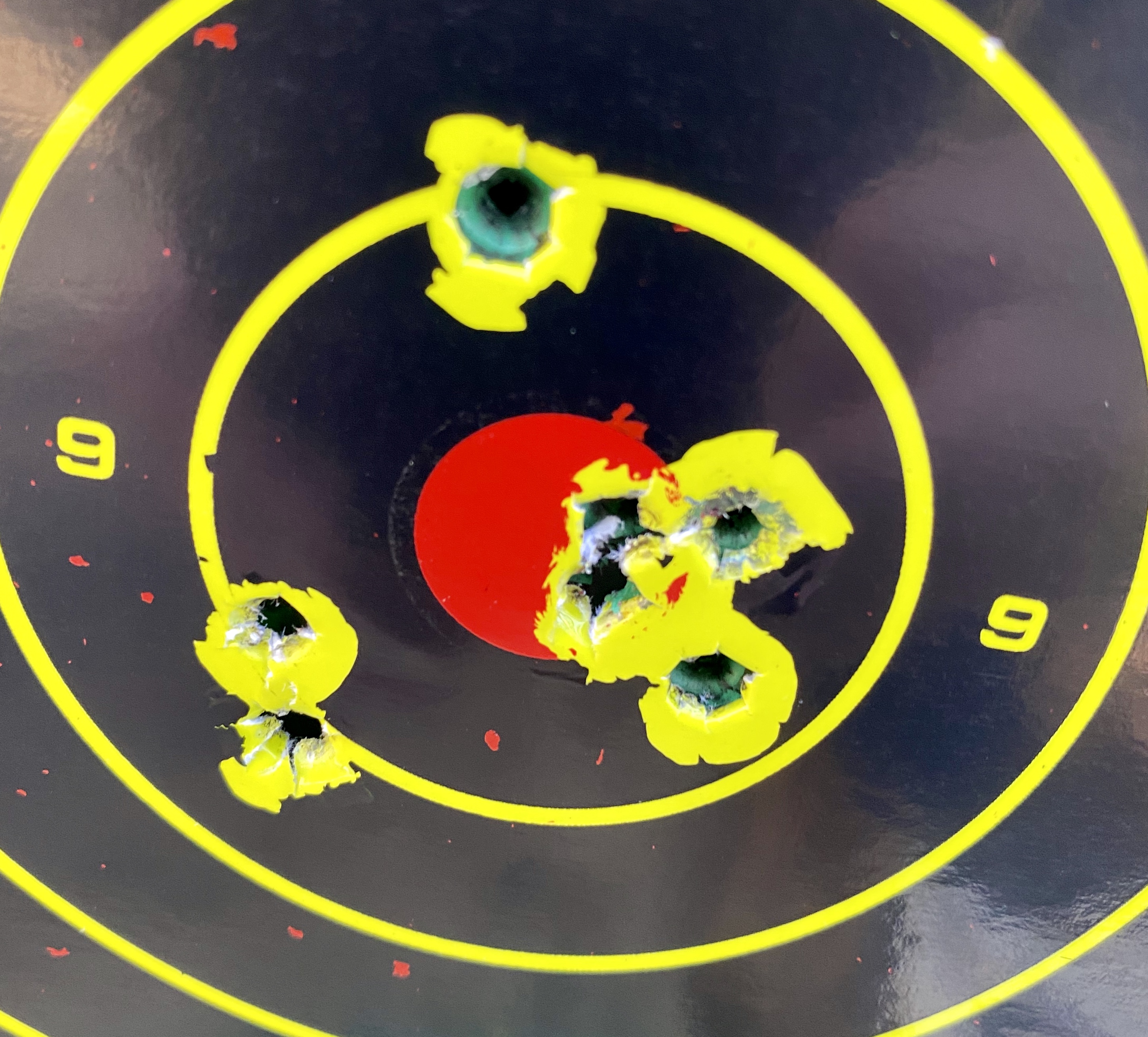

I didn’t take stills Bill but it’s not a bad idea to show the difference in bores - I might see if I can get some time later tonight or tomorrow to showcase, it’s pretty remarkable.
Managed to get the tikka 260 out today for a few sight in shots with my new z5 scope. Was shooting into the bloody sun - even swarvo was making it hard. This was just on 200 yards, 120gn bt noslers, 48gns of 2209 pushing over 3000fps. Didn’t have a proper rest which might account for some shots (key excuses here!)
The red dot is 15mm across for reference.

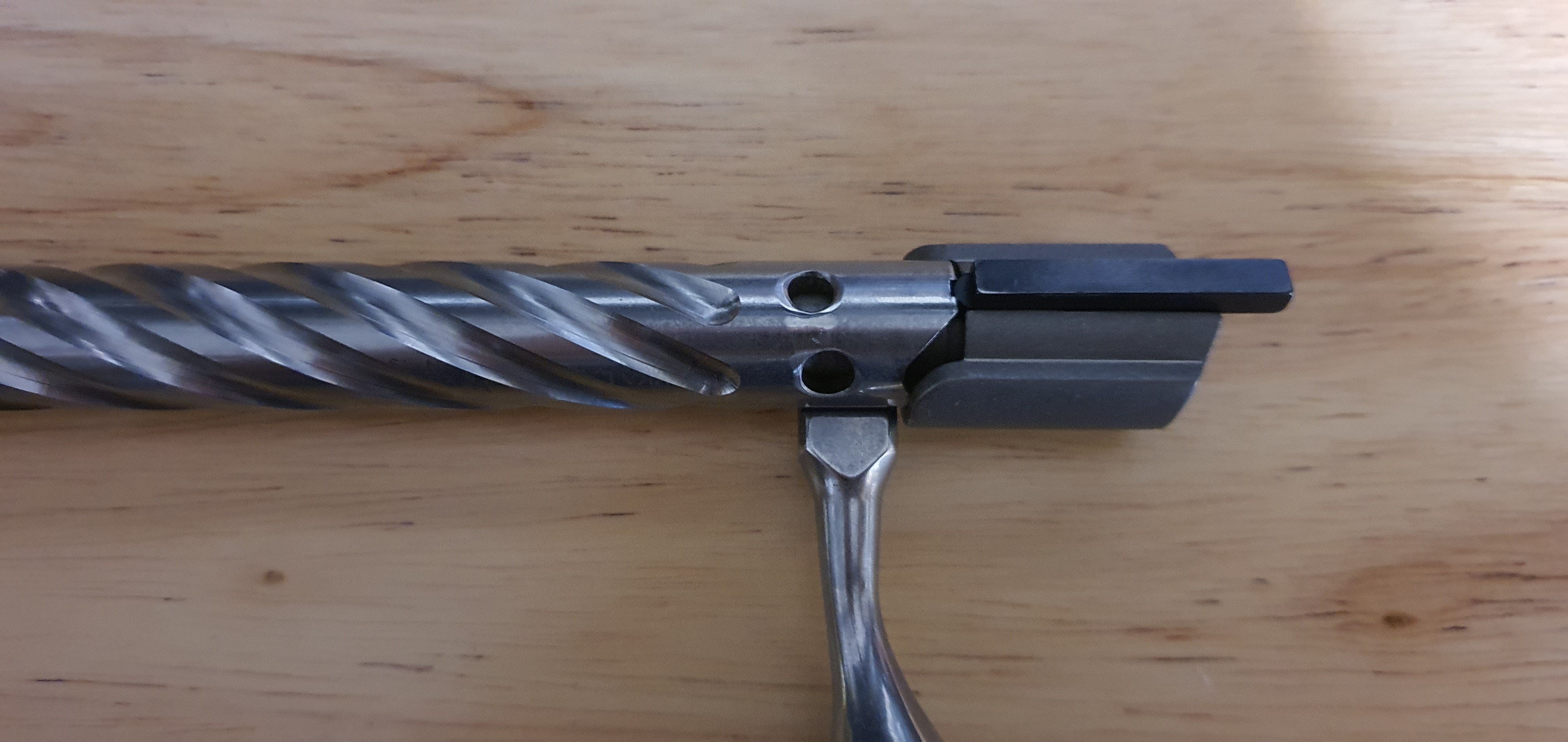

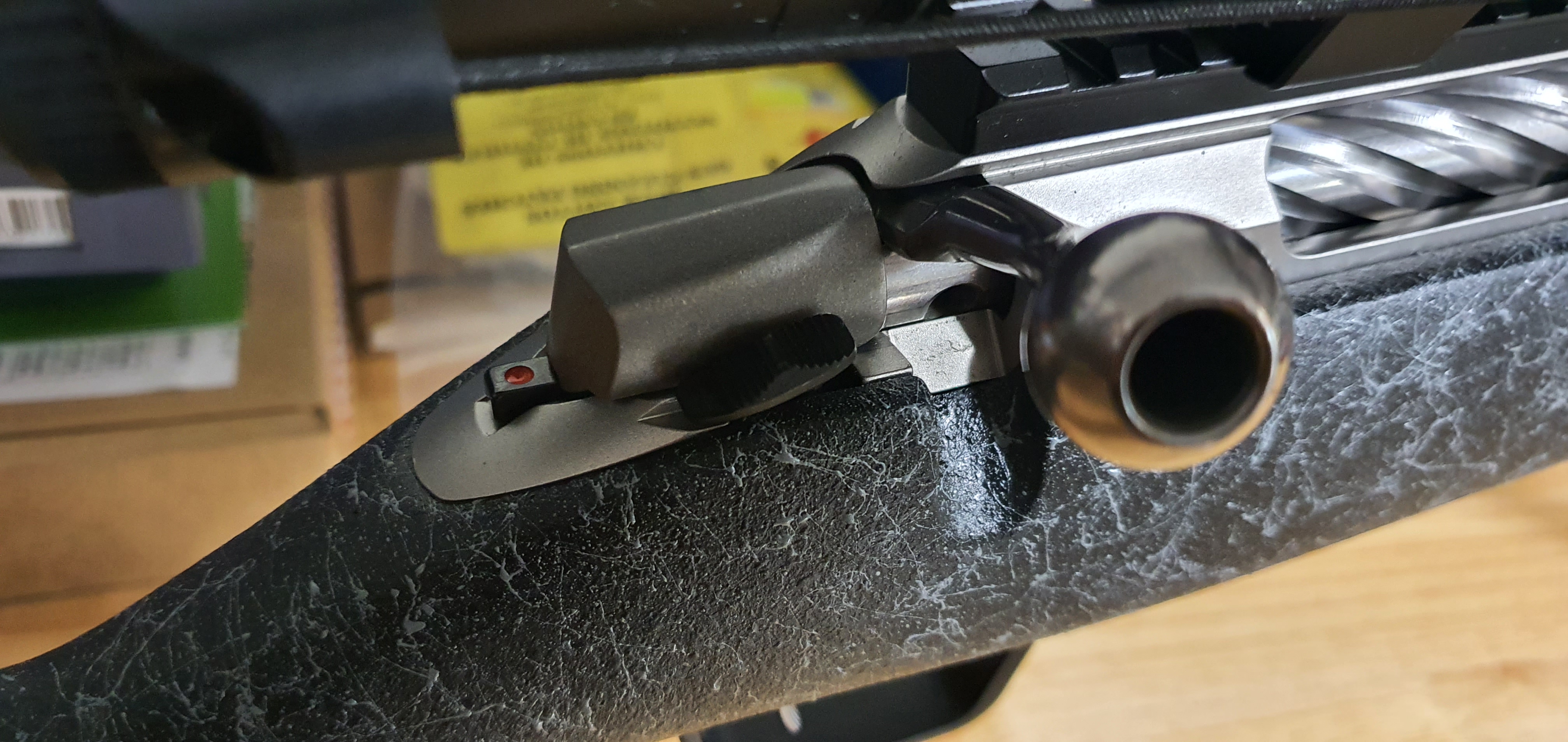

Post by tomtom889 » 18 May 2020, 11:24 am
Hi!
As a person that hunts with a Tikka chambered in .338 Win Mag, I find a small upgrade to the bolt can actually improve the safety of the firearm. The safety switch on the Tikka only allows you to engage it with the bolt fully forwards and locked down, this also prevents you from moving the bolt. sure you can argue that you don't have a round chambered and that you "know" it won't go off because there isn't a round chambered and the safety is on. But just for piece of mind I had my smith drill an extra hole in my bolt so that the safety can be flicked on with the bolt fully forward but not locked down and in battery, this also locks the bolt in place... pictures attached to show!
Edit: Another bonus is you don't need to leave your bolt open and you can prevent dirt and grit getting into the chamber!
Safety on with bolt fully forwards but not locked down

Post by TassieTiger » 18 May 2020, 12:29 pm
That’s pretty darn cool and showing initiative Tom. Does dirt / dust get into the hole in bolt ? Is it weakened as a result?
Re: Tikka upgrades?
Post by tomtom889 » 18 May 2020, 2:02 pm
TassieTiger wrote:That’s pretty darn cool and showing initiative Tom. Does dirt / dust get into the hole in bolt ? Is it weakened as a result?
Hey Tassie, so far it seems like there's no drawbacks to this, dust and dirt might get into the hole but it can be easily cleaned out as the firing pin assembly on the inside is tight enough so that dirt can't get further than the holes that you can see in the bolt. as war as weakening is concerned I'd assume it's just like the other hole in the bolt the rifle initially comes with and any weakening that may occur would be negligible. :D

Post by SCJ429 » 18 May 2020, 3:58 pm
Nice bolt fluting.

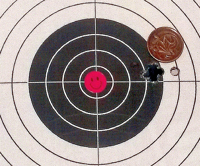

Post by RoginaJack » 10 Oct 2020, 1:56 pm
This is an early 5 shot group shot over 100yds at Belmont. - Rifle 243 Tikka lite with a 4-12x44 Vortex Scope in Tikka mounts. I've got no complaints. :D
PS. polled the 5th shot, got a bit excited.

Post by JimTom » 10 Oct 2020, 2:19 pm
Nice group mate

Post by marksman » 10 Oct 2020, 4:06 pm
JimTom wrote:Nice group mate
+1 :drinks:
still a head shot though
Re: Tikka upgrades?
Post by in2anity » 10 Oct 2020, 5:13 pm
Best factory barrel
Re: Tikka upgrades?
Post by RoginaJack » 11 Oct 2020, 11:56 am
Thanks, Yep rifle is "as issued"...
