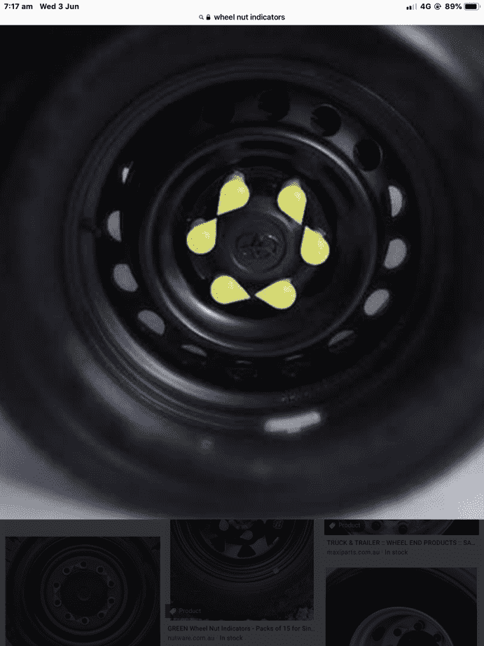

On 4 wd or trucks that travel rough ground you often see coloured indicators on the wheel nuts to alert us when one might be working it’s way loose. Perhaps I could put a little scratch or marker on the surrounds of my action screws lining up with slot of my action screws. So a quick glimpse can determine if anything has changed ...my god I’m so clever. I could be the next president of the United States

Post by marksman » 02 Jun 2020, 8:49 pm
Blr243 wrote:On 4 wd or trucks that travel rough ground you often see coloured indicators on the wheel nuts to alert us when one might be working it’s way loose. Perhaps I could put a little scratch or marker on the surrounds of my action screws lining up with slot of my action screws. So a quick glimpse can determine if anything has changed ...my god I’m so clever. I could be the next president of the United States
got a photo Blr :unknown:
Re: Removing stock when cleaning
Post by Stix » 02 Jun 2020, 11:12 pm
Not sure what you want a pic of marksman...but if its those wheel nut thingos theyre common on mine spec vehicles...little orange triangles behind the nuts...
Just to add...if thats what youre chasing search. "wheel nut indicators"...
--sorry cant do a pic...
Post by Blr243 » 03 Jun 2020, 7:16 am
He wants a photo of me standing on the turret of a tank with a bible in my hand in front of a church

Post by in2anity » 03 Jun 2020, 9:19 am
On the subject of indicators - you can dab the sides of your dovetail and front sight with coloured nail polish - if either of them get knocked in transit, you'll see the paint is cracked.
Not a bad idea. Or a dob of nail polish/paint.
Post by marksman » 03 Jun 2020, 10:16 am
never seen that before :unknown:
cheers Blr :drinks:
Post by TassieTiger » 03 Jun 2020, 12:54 pm
Would be cruel and ironic if those indicators became “stuck in place”.... not likely on our roads but still, a casual glance, all good...bang...wtf was that lol.
