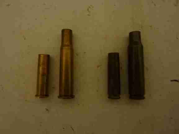

I still have a 300 BO but rarely use it these days. It came about by collecting dumped brass from the range, having and action and barrel lying about and a reamer acquired during a horse trade some years back.
More recently I converted a Howa mini to 30 Apache by simply running the AAC reamer in to 223 length. From there a single pass in the Hornady AAC dies, wound up of course, expands the neck and forms the brass. A single one pass process like a normal decapping session of fired brass.
From there loading is comparable to a 7.62x39 using 30 grains of CFE BLK for 2650 fps with either a 125 TNT or SST. The barrel i used is an old 30 BR match barrel at 1 in 17 twist from my days in Hunterclass. Accuracy is in the sub half MOA with the TNTs and around 3/4 MOA with the SST. Lighter pills see no gain in velocity, actually a loss as pressure cannot be attained as the case cannot hold enough powder and maintain magazine length and the short bearing length does not allow enough resistance to build pressure.
This is not a new thing as the Apache has been around for a long time now. The HAMM'R more recently is between the two but the ease of one pass with an elliptical expander using 223 surplus brass makes for a very cheap and better performing cartridge that cycles in any 223 based action.
I have two very accurate 7.62x39s that never get used because of the brass being less easily attainable and expensive being Lapua. Both have 308 bores in either 14 or 17 twist and both have now been sidelined because the Apache is as efficient in cost and performance.
I have since advised any who are disappointed with their 300 AAC's performance to do the conversion. Though doing it with a 7 twist barrel will most likely exacerbate any accuracy issues. These rifles and cartridge were specifically designed for suppression using 200 plus grain bullets.
