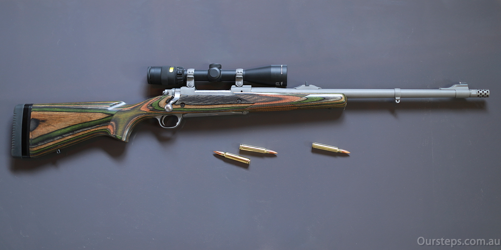

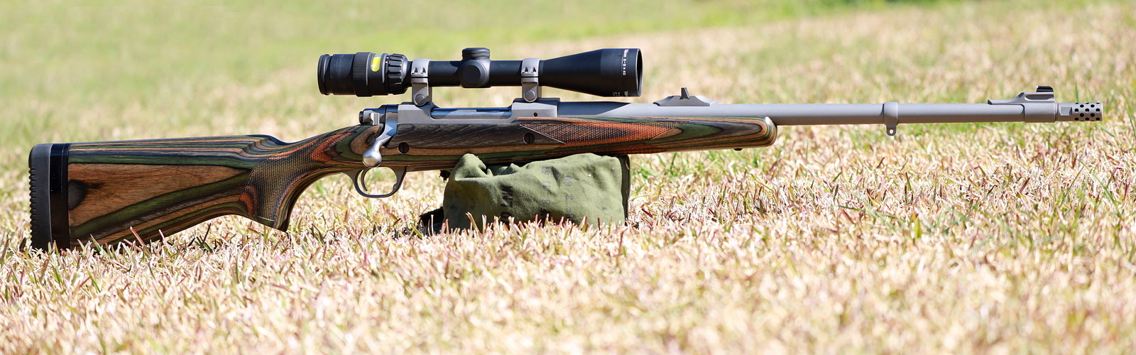

What’s the go with the sling stud on th barrel instead of the stock?
Posts: 4808
Re: RUGER M77 GUIDE GUN 300 WIN MAG
Post by Ziege » 25 Oct 2020, 1:45 pm
its a preference thing BLR243 a lot of safari stuff has it on the barrel because shooting shorter distances and so isnt an accuracy issue but mostly to stop recoil eating your hand with the swivel stud

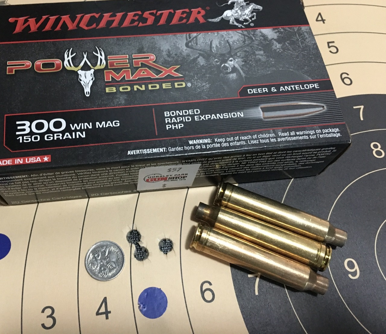

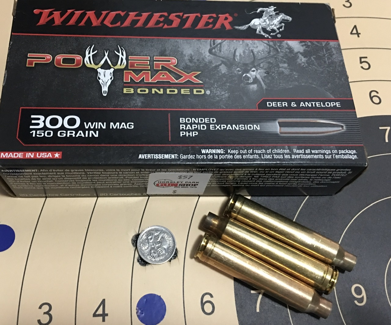

First time shot this evening
Factory ammo 150 grain

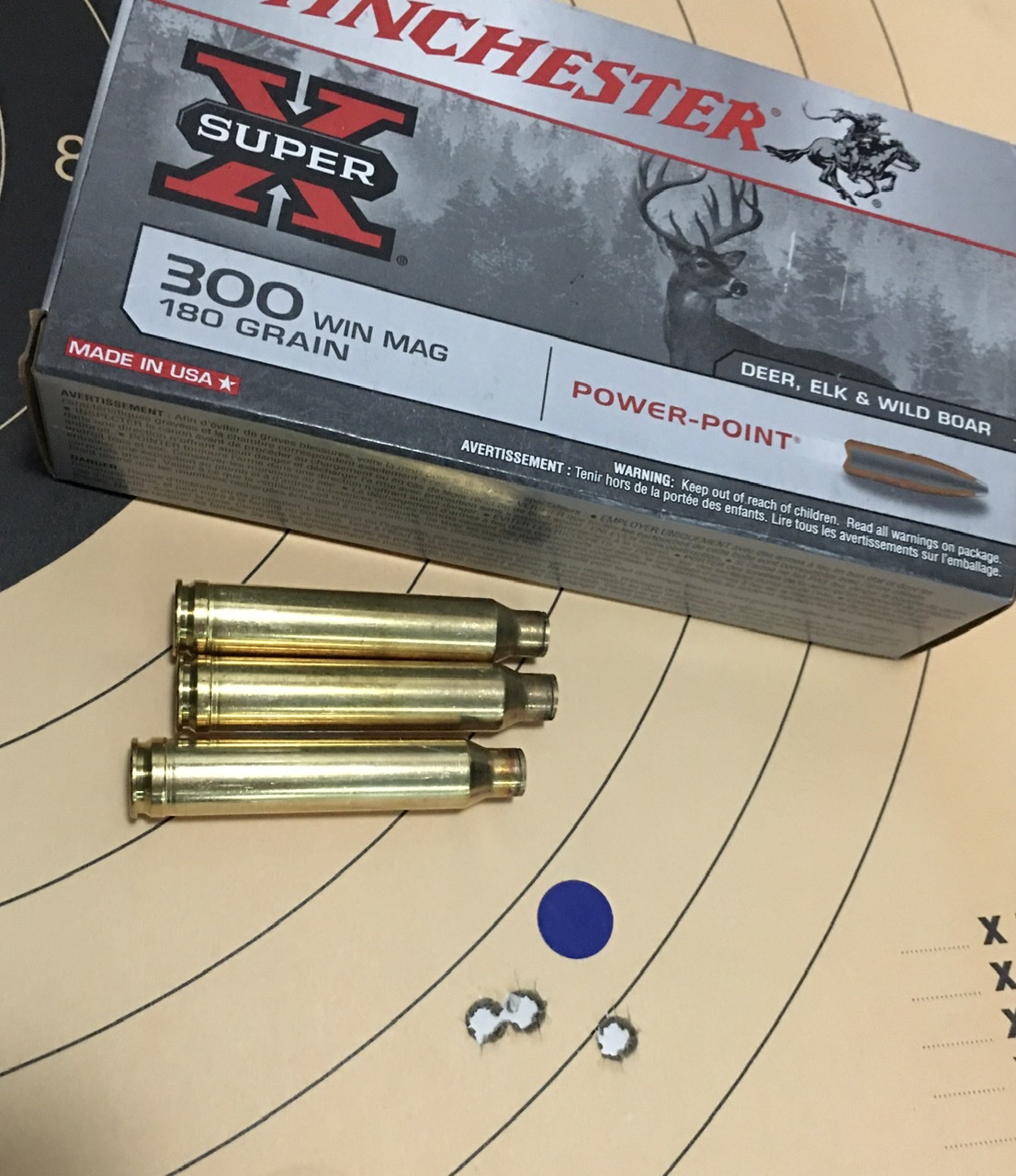

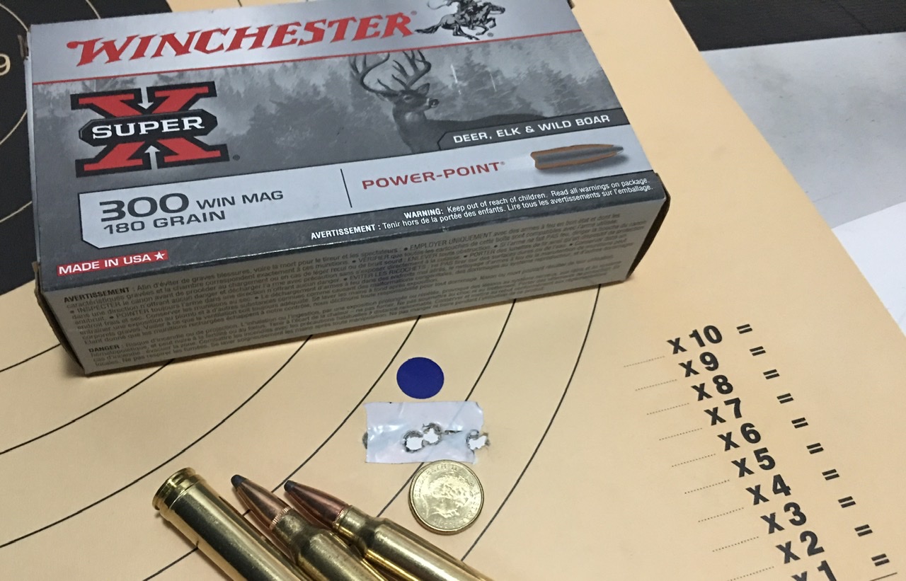

Factory 180 gr ammo first 3 shot
SHV
Posts: 1780
Post by SHV » 31 Oct 2020, 8:35 pm
180 gr second 3 shot

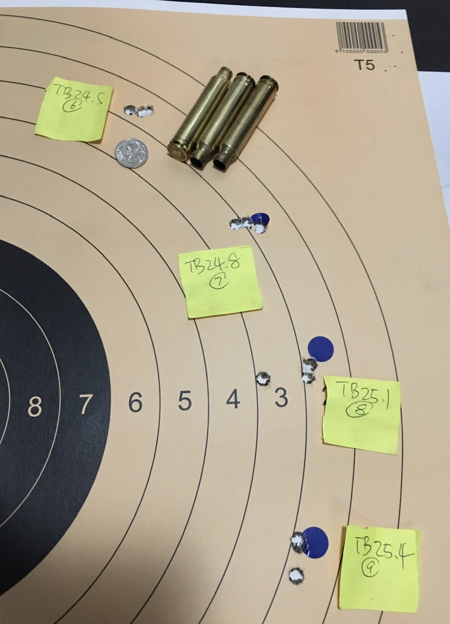

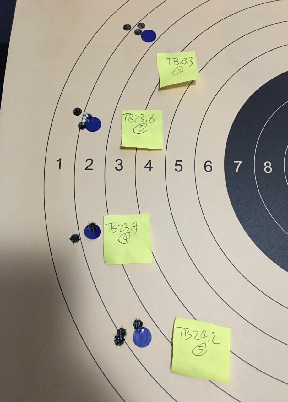

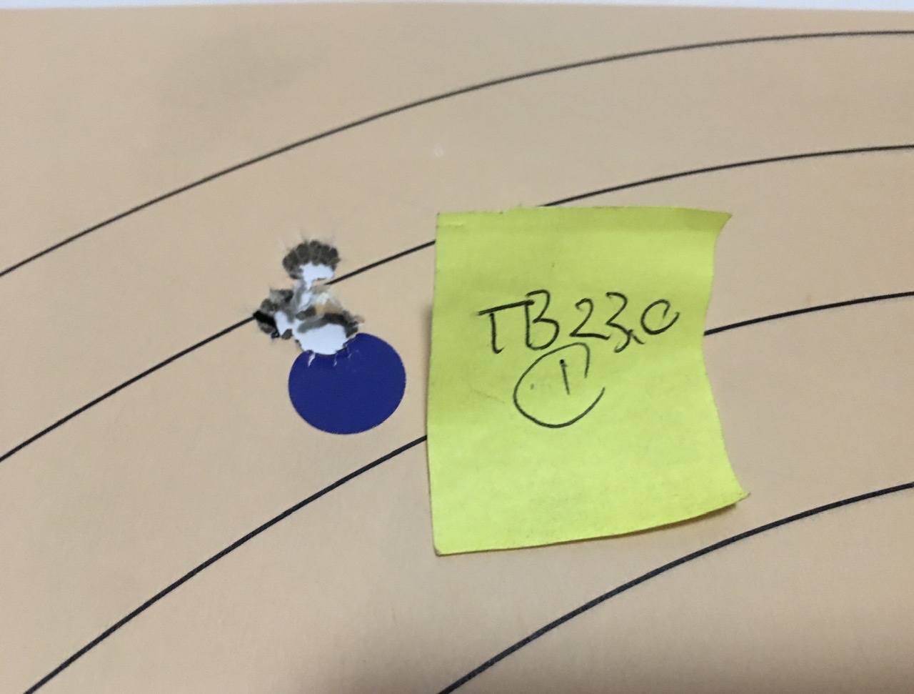

125 gr Speer tnt projectile with TB reload test

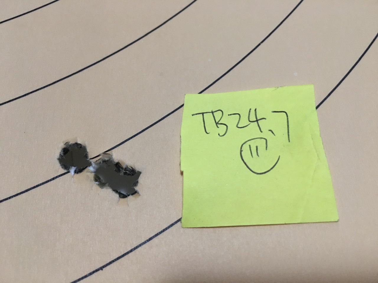

So looks like 24.6 24.7 are good
POI doesn’t change to much even compare with factory ammo although 150 gr fly high and 180 gr fly low a little bit
