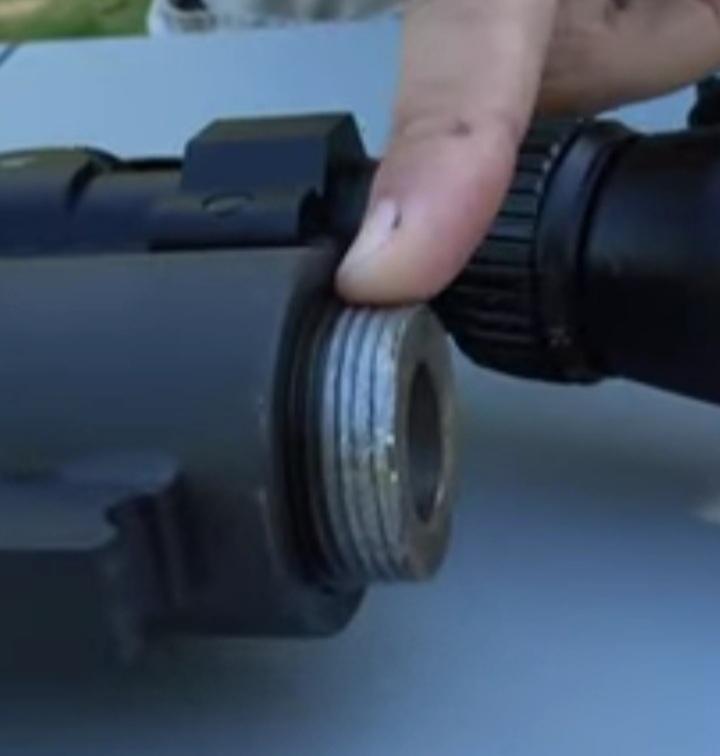

InisBineest wrote:While I'm sure those making such assertions about the poor design of the RN-50 are highly qualified gunsmiths and engineers.... May I suggest folks watch an analysis from a well known firearms expert on the incident that they might find interesting/educating.
https://youtu.be/bBNHI1_urWs
A well known expert whos looking a tad wet behind the ears on his YouTube channel "backyard ballistics"
Containing 55,000 psi blast on 4 of 5 turns (less than ⅓ of the threads total diameter) of what looks to be a 1½ to 1¾" thread thats somewhere around 12 TPI is a massive ask let alone asking it to hold additional force from over pressure.
Second to that, the firearms inherent design makes mo allowance for user safety in the event of a catastrophic failure, sending the breach cap and little locating lugs straight at the user ....no thought has been put into its design with regard to engineered failing points.
Definitely a very poorly conceived design.

on_one_wheel wrote:Pretty nasty looking action, screw on cap with 2 pissy lugs behind it. I guess its a budget 50cal rig?
My first thought as well when I saw it.

Blr243 wrote:I tend to agree one wheel. Looks like the sort of thing a backyard jamacain gangster might do with pipe And fittings from mitre ten
demolition ranch owns the same model. bet that wont be making any appearances in his videos anytime soon.

InisBineest wrote: I would have thought (in my puny non engineering/gunsmith mind) that a set of well designed threads would be just as, if not more reliable in holding pressure than one or two lugs in a break action, that have been known wear over time and in some cases give (in a less dangerous manner than threads, granted).
Threads can hold more pressure than a couple of bolt lugs PROVIDED they are of sufficient size, have enough thread engagement, enough thread length and as mentioned enough thread preload.
The thread on that firearm had poor engagement which can be seen by how easily it was screwed on, very little thread length of only about 4 or 5 threads which is evident in the screen shot earlier in this thread, and the cap is not shouldered (zero preload)
Its a recipe for disaster.

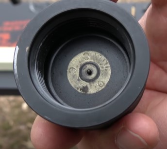

Scott's latest attempt to blow another RN50.
https://www.youtube.com/watch?v=hsw70VfSFFw
This is after firing another of the dodgy SLAP round, the case head is imprinted into the breech face!

Good watching, and interesting result. Won't spoil it here but its worth a watch, even if you just go to near the end.
All the experts commenting on threads being insufficient - you realise threads are how are rifles are put together, right?
And that for containment purposes most thread strength (roughly 80%) is in the first 4 rows? Very little gain is made by going to 5 or 6 threads over four, and anything over that is virtually useless.
This comes down to a massive overpressure situation. I wouldn't want to be behind the butt of any firearm where there is a potentially destructive overpressure. There's all sorts of risks, stories and anecdotes. I;ve seen pictures of rifle bolts leaving rearward, revolver top straps and cylinders breaking, containment lugs sheared... all nasty sorts of injuries and quite usually causing savage injuries to the hands, limbs and face of the user at the time.
Would I trust a threaded cap? I would, and so do you, every time we fire a rifle. Would I ever want to go into an overpressure situation? JH Christ, no!
To quote a member here 'I see no utility in pushing a catridge to the limits. Its fatiguing on both shooter and rifle, and ultimately dangerous. Just go to another caliber.'

In the US it appears to be fairly common practice to buy bulk surplus ammo for bugger all, pull them apart for the brass and bullets, and sell the powder cheap. People are always asking for load data "for this powder I saved from some 5.56 NATO ammo".
My guess is somebody unscrupulous bought a bunch of salvaged powder for nothing, found some brass, and fabricated some dummy saboted bullets - maybe they even found a source of genuine penetrators and sabots and saw a way to make some good money. It would be very easy to 3D-print the sabot to replicate an original. It's probably very easy to turn replicas of the 7.62mm penetrator out of brass or steel and paint them to match. Filled the brass with a mixture of old powders from different sources, and seated the bullets on top. When your profit margin is something like US$90 per round people will make the effort. That would explain why some fire just fine, some lock the rifle up, and some explode.
This was certainly not a result of any deficiencies in the design of the rifle.

After the last video, I would suggest that it puts to bed the idea of it being an inherit fault of the rifle.
It is a cheap 50cal, and cheap often equals poor quality.
But this wasn't a cheap 50 cal on equal footing to other semi automatics. It is basically a rifle at its simplest. Any simpler and you have a matchlock. I'd still be happy to own an RN-50 (if only I could afford to shoot it in Aus!) But I would be inclined to load my own ammo, as I am for all my rifles (less the .22 that is:).
That way any blow up is my own responsibility. I'm generally not one to trust milsurp ammo.
InisBineest
Posts: 253
Re: .50BMG explodes with serious injuries.
Post by on_one_wheel » 21 Feb 2022, 10:27 pm
My opinion of the plug thread length engagement, shouldering and preloading hasn't changed.
That's not a great place to have the point of failure, it's just plain deadly.
I personally think that no thought has been put into engineering the rifle in such a way that in the event of failure the user is kept from almost certain death.
Having the breach plug and lugs fired at the user isn't ideal. Having a destroyed shoulder and a barrel sent down range would be a better option.
If I were to redesign that rifle, I'd be making sure that the weakest point was a point on the chamber area of the barrel, milled down to a flat on the top, allowing the chamber to to explode upwards sending the energy and shrapnel in a safer and more controlled direction. I'd definitely be making the breach plug thread and lugs a point of no failure.
Even a groove machined on the od just behind where the shoulder would be sitting inside, engineered blow the barrel forward.

I think the design is bad. The cartridge is put in and then back ends screwed in, ofcourse people are impatient so the designers probably thought having less threads would be good enough. In this case likely not
cz515
Posts: 1028
Post by bladeracer » 21 Feb 2022, 10:55 pm
cz515 wrote:Pay peanuts get monkeys.
It wouldn't matter how many threads there were, it still would've blown with that charge. If the threads had held it would've blown the cap apart. It would not have contained the pressure.
