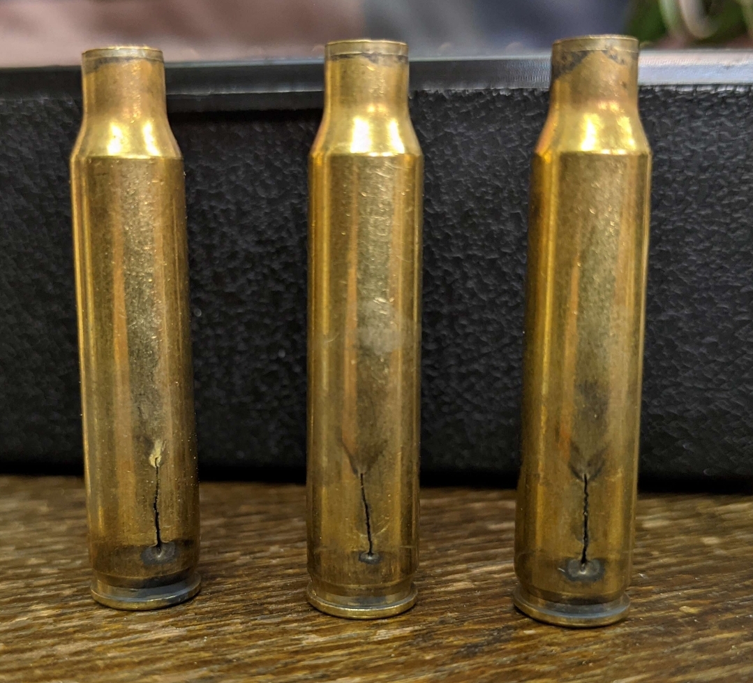

I spoke to Lithgow and they weren't too worried about it. They said "I would only start to be mildy concerned if it does it on another brand of ammuntion."
Said it could easily be poor annealing on the brass in that batch of ammo since the splits are all identical. They said if there was an issue with the chamber they would expect to see splits at the opposite end (shoulder or case mouth.)

Medb wrote:I spoke to Lithgow and they weren't too worried about it. They said "I would only start to be mildy concerned if it does it on another brand of ammuntion."
So Lithgow not interested in inspecting it . They are quiet willing to risk the integrity of the gun based on a guess .
I suspected that the cases are bad but the gun should still be inspected to see if the gas rupture harmed anything . That gels well with the way I was treated trying to talk about their designs when they first started .
You will never see a Lithgow in my safe .

The advice seems sensible to me. Cases in factory ammo splits all the time due to poor annealing. I am betting that you won't have this problem with some quality brass like Lapua.

I agree with Johnv. If for no aother reason it should be inspected for damage.
And I'm surprised that some think it's not unusual for factory ammo to split. If split cases are not very rare it tells me the industry doesn't give a fuk about our safety.
The attitude of Lithgow worries me.

I’ve really only seen cases split around the neck. Lithgow’s attitude is not what I would have expected. If it were mine, I would be getting the rifle checked by a smith regardless of what Lithgow says .

buddy of mine had one in 308 and it was a deathtrap, he noticed gas hitting him in the face and thought he was just being a bit precious, next one blasted red hot gasses into his face, needless to say he didn't fire it again, gunsmith says he's lucky that's all that happened, Likewise I will never own one.

Due to lockdowns etc... I won't be able to go shooting with it this week, or possibly longer anyway. In the meantime I'll see about getting a local smith or someone with a lot more knowledge and tools than me to give it a look over.

Personally, firstly I’d check the specs of the fired brass (both failed and unfailed), with the ratio of failures v rounds fired I’d expect to see more failures if it was a out of spec chamber, especially as it’s the same brand cartridges.
Carefully dissect a few case‘s for internal inspection looking for abnormalities in wall thickness etc
I wouldn’t fire the rifle until the issues been identified, live fire testing isn’t a good idea when there’s a Un diagnosed problem with a potential risk of injury.

This failure was NEW ammo. I think disassembling a few rounds for inspection is very sensible. But still think the rifle should be checked.
Rifles are built with a very significant safety margin, but best be sure IMO.
"It is just 55 grain Remington FMJ bulk ammo. I have fired maybe 1-200 rounds of this stuff through a different rifle and had no such issues so far, and I still have another 1500~ or so rounds of it left."
Have you contacted Remington?

Split necks are common and not worth mentioning. Splits nearer the case head are always unusual and need to be investigated as they allow gas blow-by. Case head separation can be common in some rifles and chamberings, but longitudinal splits in the body are more unusual.
I'm sure it's an issue with the brass, not the rifle, which can be tested by firing some in other rifles.

If the chamber is out of round, a simple check would be to rotate a fired case 180 degrees from the position it was fired in and chamber it. If it is tight to close the bolt on and shows a shiny mark down the side that is split, you may have found your problem.

That’s what alerted me to the problem with my rifle, neck sized brass wouldn’t feed because of a stuffed up chamber as you say GR . I would have to rotate the brass to find the spot where it would feed .
