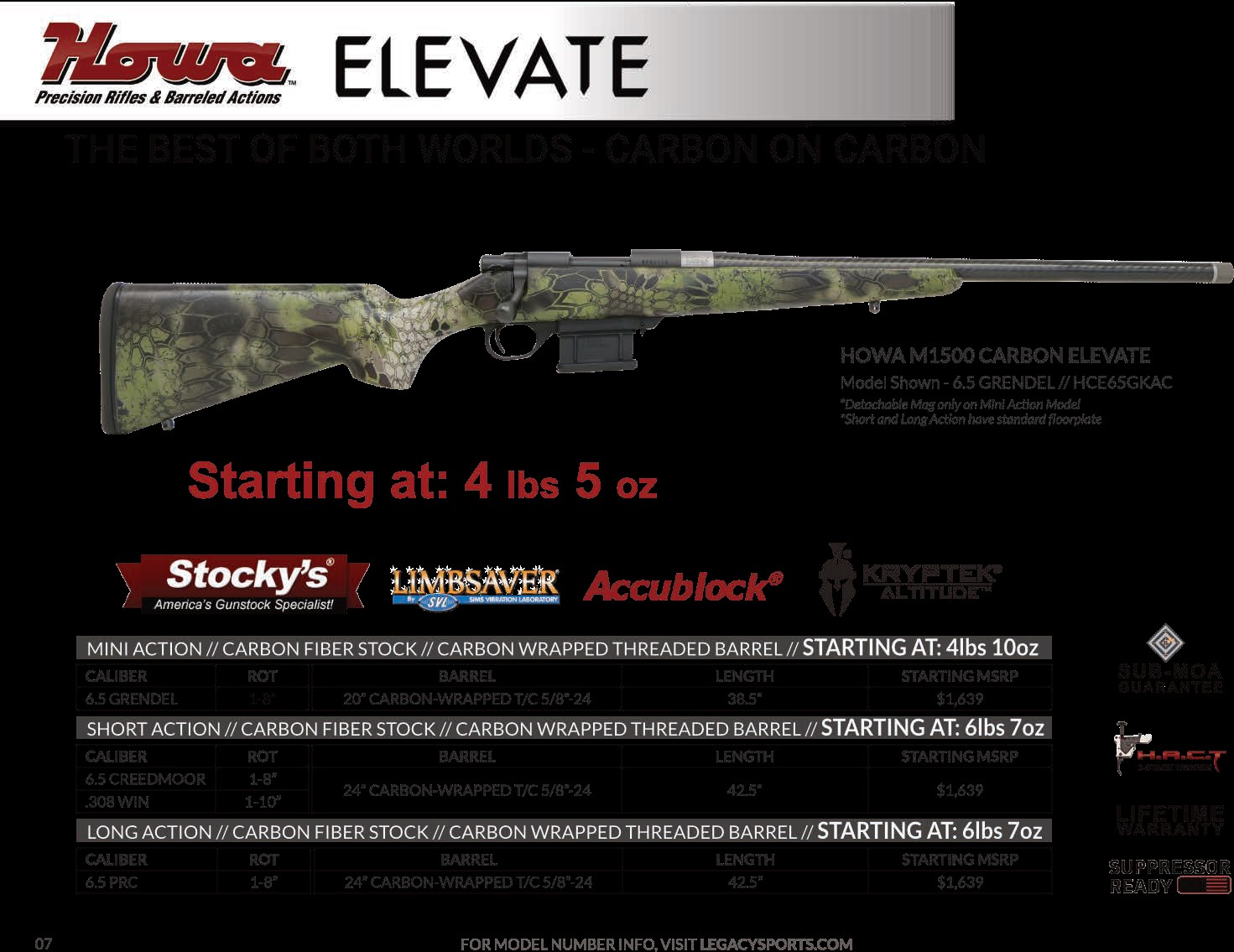

Bill wrote:Wow I was just checking out the new 2022 LSI Howa range of rifles when I noticed they have listed a new Super Lite rifle with a new Action in between the Howa Mini and the Standard Short Action with only a weight of 4lbs 7oz.
Way to go Legacy Sports International, Id love to see this sold as an action only, be a great donor for a few new builds :thumbsup: :drinks:
https://www.legacysports.com/super-lite/

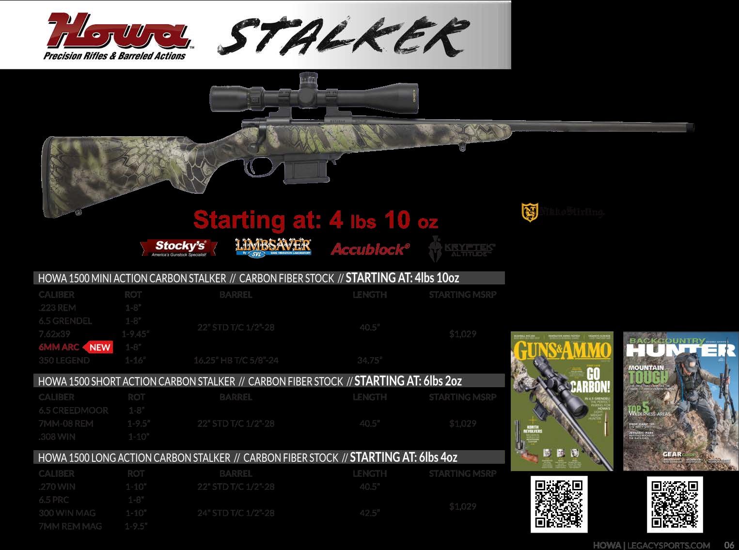

I'm not seeing anything about a "new" shorter action, this is the standard Mini-Action.
Looking at the Howa site though, the Carbon Stalker weighs 2100gm in the Mini Action, in the Short Action it's 2800gm, which is what this rifle appears to be in 6.5CM/.308.
The advertised "4lb 7oz" is for the Mini Action, it's 85gm lighter than the Carbon Stalker but still stuck with the lightweight chamberings.
Bladerace have another look at the Catalog, this isn't the standard mini action, I can tell by the photo its longer, I have had 3 Howa Mini action over the last 7 years and you can't fit anything longer than a Grendel case in em. You can see the receiver profile looks like the Howa mini so its clearly a slimmed down SA. 4 shot capacity in the flush fitting mag too. 4lbs 7oz is 2.01kg :thumbsup:
This is what LSI says of the new Super Lite ' This new offering has a unique Howa Action build that is in between the popular Howa Mini Action and standard Short Action platform ' :drinks:
https://shootingsurplus.com/legacy-spor ... yptek-obs/
Bill
Makes more sense to me. That is 800gr heavier. And much closer to the norm

If it's chambered in .308 or 6.5CM is _must_ be at least 2.800" to be able to feed the cartridges through it - a standard short-action, same as every other short-action.
The Mini-action is AR15 length, 2.260".

Yep! A "4lb 7oz short-action" would be decades ahead of the race, and every forum and website with anything to do with firearms would be front-paging it...

Post by bladeracer » 23 Jan 2022, 3:51 pm
Bill wrote:So I just did a quick check on current Ultralite Rifles that weigh less than 5lbs and come with a Carbon Fibre stock. I couldn't find anything from Sako, Tikka, Remington or Ruger that could make the grade. Prices I’ve listed for the Howa’s is what comes up with a quick search, the other makes generally don’t seem to be discounted. I’ve listed the receiver ring diameter where I could find it so you can see where the new Super lite SA will need to be around. :drinks:
Kimber receiver ring is 1.14 inches Mountain Ascent 4lb 13oz $2300 US
Howa Mini is 1.17 inches Carbon Stalker 4lb 10oz $999 US
Nula is 1.22 inches Model 20 4lb 12oz $4200 US
Weatherby Mark V ??? Backcountry Ti 4lb 11oz $3449 US
New Howa M1500 ??? Super Lite 4lb 7oz $1180 US
Kimber does claim 4lb 13oz (2.2kg) for the Mountain Ascent in .308, 6.5CM and 7mm-08, and that it is "the lightest production bolt action big game hunting rifle on the market today" - which I'm unable to dispute. It has an unfluted stainless 22" barrel though which makes it very difficult to believe - can anybody confirm this is correct? It has no sights or rail so will require some kind of optic, but it's still very impressive. With a red-dot the rifle is still lighter than a bare Howa 1500 barreled action.
Nula does offer the 4.75lb Model 20 Short, which they call their short-action even though it's a mini-action, they call their short-action an intermediate action, which starts at 5lb. They call their 5.5lb long-action "springfield-length". For a rifle builder to not understand what the action lengths are is a worry.
The weight I find for the Backcountry Ti starts at 5.3lb?
Weight for the "new" 1500 Mini Superlite starts at 4lb 7oz. The 1500 Superlite short-action is heavier.
Howa Page6.jpg (243.26 KiB) Viewed 11895 times
Howa Page7.jpg (247.04 KiB) Viewed 11895 times
I don't expect a response, but I have written to Legacy asking if they really do now have a 4lb 7oz .308 rifle for us.
