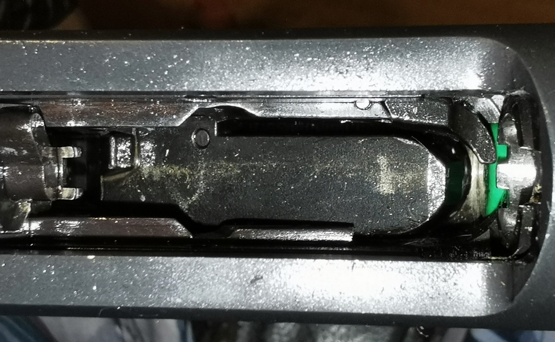

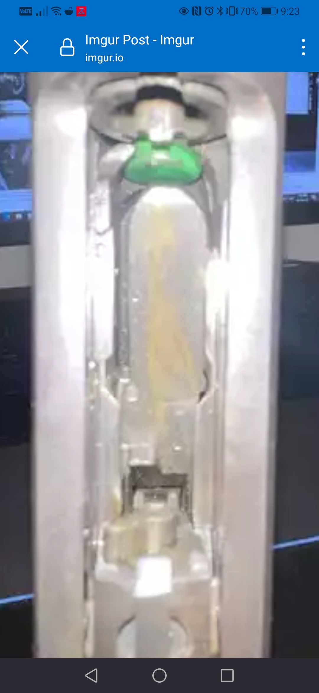

Post by Pighunter » 19 Sep 2022, 12:33 am
I've added two photos one of my "repaired" cartridge guides and one of a Reddit users cartridge guides. I'm not entirely sure but the channel cutout in the left guide on my rifle appears to be all sorts of messed up and wonky and the width of the entire guide doesn't even seem uniform... Don't really want to drive and hour and 20 to take it back to get sent away again so I guess I'll have to go to a gunsmith to see if they can fix it.

Post by Fionn » 19 Sep 2022, 4:54 pm
Someones filed (butchered) the left cartridge guide, it shouldn't look like that stock. Generally you modify the left cartridge guide to help get the correct angle for the cartridge to level and feed into the chamber well.
The feeding issue maybe related to this or maybe the cartridge rails are to close together at some point. When feeding does it look like the rails are squeezing the cartridge somewhere along the stroke?
The best way to look for issues with feeding, is cycle the action very slow, watching what is happening and what is causing the problem. If that doesn't help, try dykem or sooting the action. But as its a new rifle I would be sending it back for warranty pointing out the filed left cartridge guide and the feeding issues.

Post by Pighunter » 19 Sep 2022, 9:55 pm
Fionn wrote:Someones filed (butchered) the left cartridge guide, it shouldn't look like that stock. Generally you modify the left cartridge guide to help get the correct angle for the cartridge to level and feed into the chamber well.
I'll try some of that when I get a chance, thank you for your reply, Ive sent another email to Cleavers about the warranty, but I'm.more disappointed that my rifle that cycled beautifully now has a few issues that make it unsafe to use while pest controlling wild pigs
Edit: the supplier are going to swap my rifle for a brand new one. I wasn't expecting that level of customer service but I'm quite happy with the outcome.
