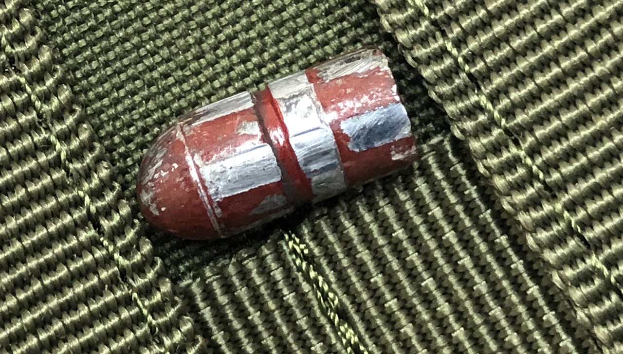

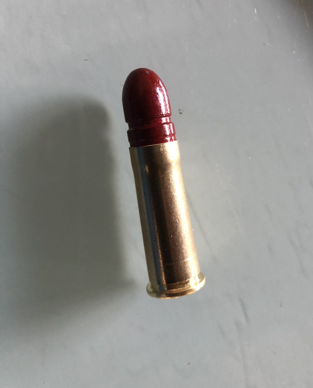

Can you post some nice clear photos of the cartridge and bullet you're trying to load?
Re: need help 310 CADET
Post by SHV » 24 May 2022, 5:01 pm
case length 1.18
SHV
Posts: 1780
Post by SHV » 24 May 2022, 5:03 pm
Put into the chamber stops here
SHV
Posts: 1780
Post by SHV » 24 May 2022, 5:08 pm
Case length 1.00 nearly get into the chamber if push hard enough can go in and close the chamber
SHV
Posts: 1780
Post by SHV » 24 May 2022, 5:13 pm
Once the case length is 0.98 or less
chamber nicely, this is the comparison 0.98 case and full length case
SHV
Posts: 1780
Post by No1_49er » 24 May 2022, 8:48 pm
That picture describing the case length 1.00 shows the problem.
How can a heal seat bullet expand the formed case that much. My experience is that the case will be a straight "taper" from the rim, right through to the projectile shoulder.
Your photo shows a clear expansion where the "heal seated" bullet is inserted into the case.
In my experience, that aint right.
No1_49er
Posts: 1024
Post by bladeracer » 24 May 2022, 9:25 pm
I think the issue must be your measurement of the heel, it can't be .314" OD if it expands the case which is at least .315" ID (if an 8mm drill bit bored it out). The bullet must be larger than that. If the bullet is .314" it should pop in and out of the .315" case with virtually no contact, it should not need to be forced in to expand the case neck.

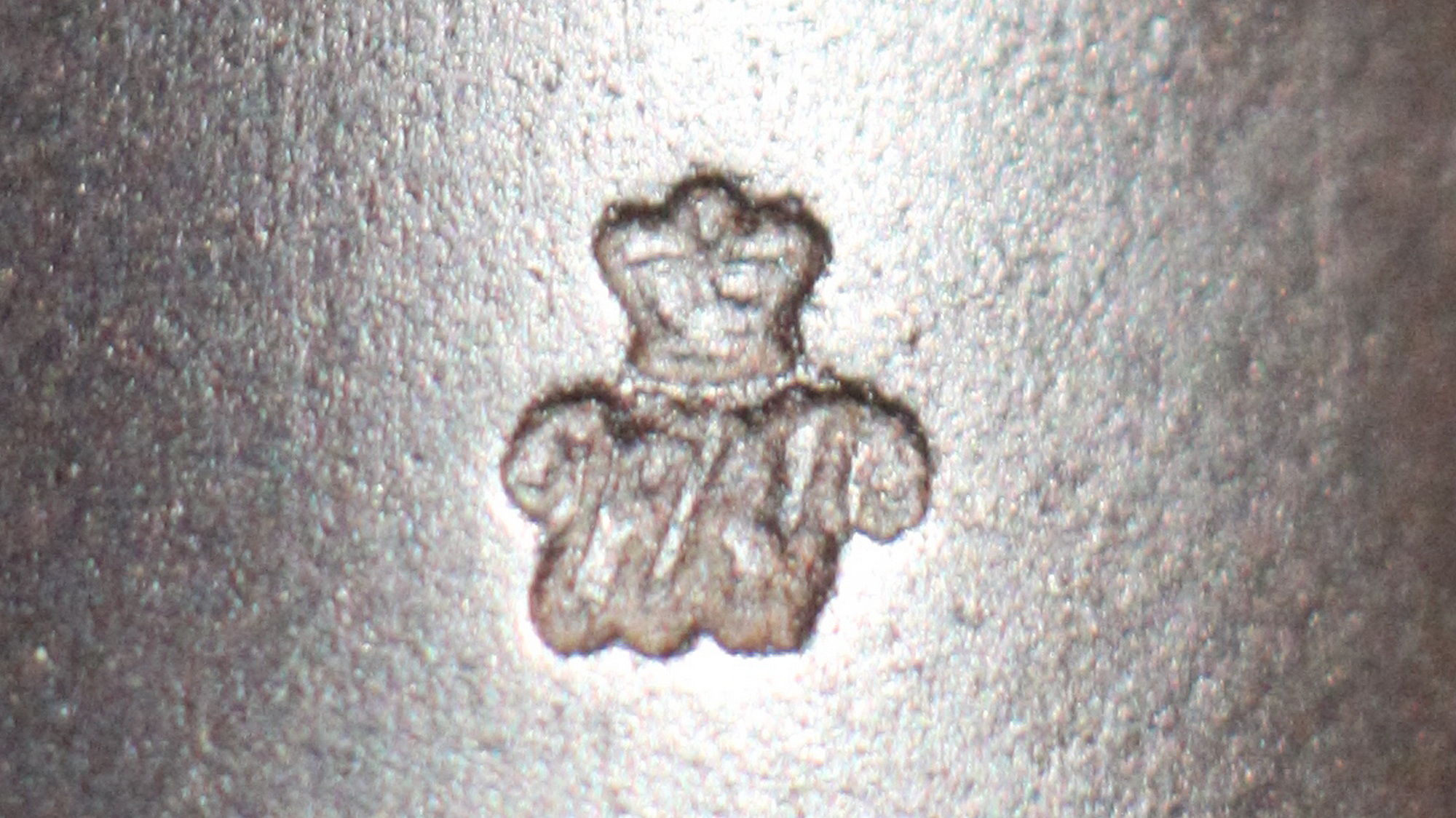

Post by SHV » 04 Jun 2022, 2:37 pm
SHV
Posts: 1780
Post by SHV » 04 Jun 2022, 2:50 pm
SHV
Posts: 1780
Post by SHV » 04 Jun 2022, 2:52 pm
what's this logo?
SHV
Posts: 1780
