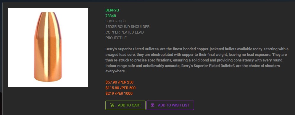

Try Berry's 150gn Copper-Plated bullets in the .30-30, cheap and shoot very well for me.

21gr 07 under that Berry’s 150gr plated bullet is a fine 30/30 100m target load. Very mild recoil and doesn’t generate near the heat a hunting load does. Accurate too - easy 3” long string groups at 100m, possibly better depending on your bedding arrangement
