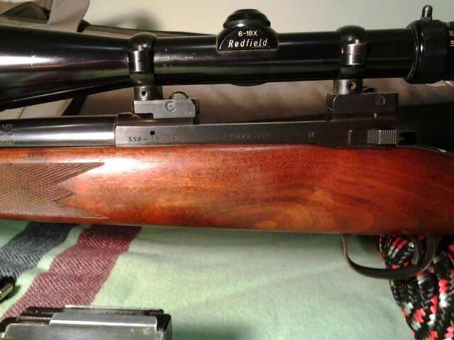

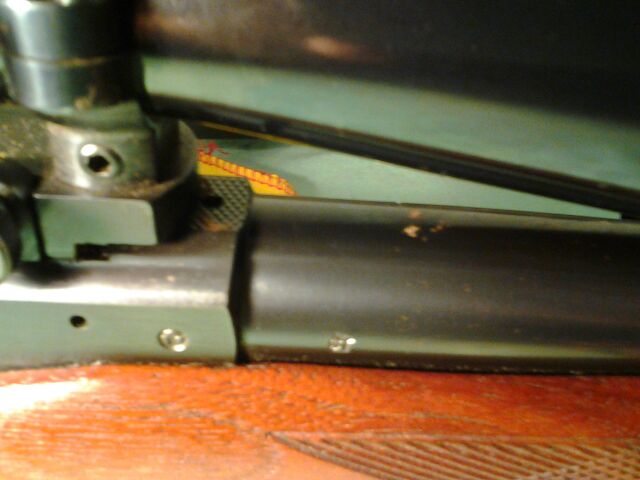

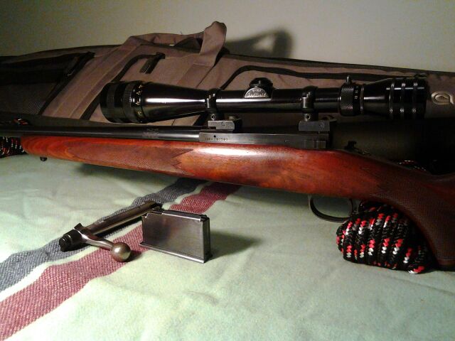

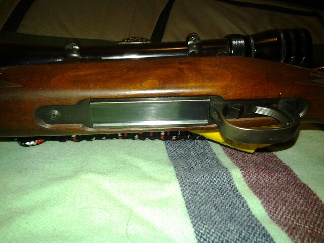

Post by KWhorenet » 08 Mar 2015, 9:38 pm
Nice one Chronos.
Is it time for a STICKY TIKKA thread for pre Sako/Beretta Tikka's only? :drinks:
Tikka M55 small rust on barrel and mount area.jpg (37.08 KiB) Viewed 14218 times
Tikka M55 left side view.jpg (49.45 KiB) Viewed 14218 times
Tikka M55 butt.jpg (42.54 KiB) Viewed 14218 times
Tikka M55 bottom.jpg (51.04 KiB) Viewed 14218 times

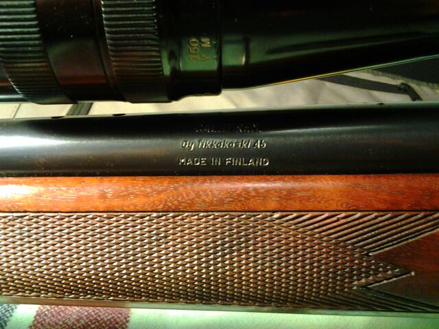

Tikka M55 barrel stamp.jpg (67.01 KiB) Viewed 14218 times

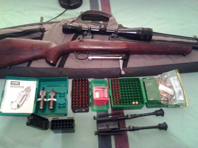

Tikka M55 package deal.jpg (47.77 KiB) Viewed 14218 times

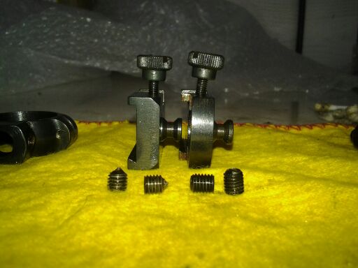

Will see if I can get used to the old Redfield that's on it. If not it will be swapped out for a Zeiss HD5 3-15x42
I had a play with the Redfield and if I adjust the focus the objective bell has wobble in it which moves the reticle around until the locking ring is retightened. Don't like that much but once set and sighted in I wont be moving it I guess. Not for 22lr or 22 hornet ranges anyway.
Hey Chronos you don't have any spare UK SportsMatch Tikka mounts do you :lol:

I'd say so yeah. Has a few little blemishes but I didn't want a safe queen anyway.
A good wash, bit of make up, some fresh lube and she will be good to go. Will mostly take her out at night anyway :lol:

Post by bigfellascott » 08 Mar 2015, 10:40 pm
That doesn't look to bloody shabby at all mate, I wouldn't worry too much about the rust etc, a good clean up and oil and it shouldn't present any real issues at all then, the stock looks in pretty good condition too going by the pics I can see, metalwork looks like its still in good nic too. I'd give the scope a run and see how it goes and if need be swap it out but its on there might as well give it a crack and see if its worth keeping or not hey. :thumbsup:
I look forward to hearing how she shoots next.

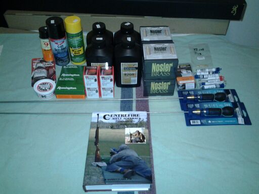

Post by KWhorenet » 11 Mar 2015, 3:39 pm
The Tikka M55 17 Rem is booked in to get re-crowned (+ maybe remove worn rifling). Quoted $50 so wont be haggling or doing it myself.
Anyone want to buy a kidney?
Spendy couple of days, but I wont be needing brass, powder, primers, pills or cleaning gear for a while. Lucky I don't have kids I guess 8-)
Sticking with Benchmark 8208 for 17Rem (20 Prac when the barrel dies) and 30-30win. With LilGun for 22Hornet, I'm trying to stick to 2 powders that shouldn't disappear in a hurry fingers x'd
The book 'Centrefire Rifle Accuracy' by W. Hambly-Clark JNR. Got the last available copy of his last print run. Got speaking with him about a rifle I was looking at that had been re barrelled by him. Should be a good read from all accounts. I might even learn something too :)

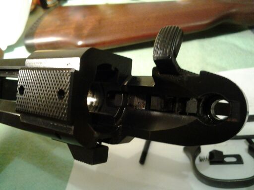

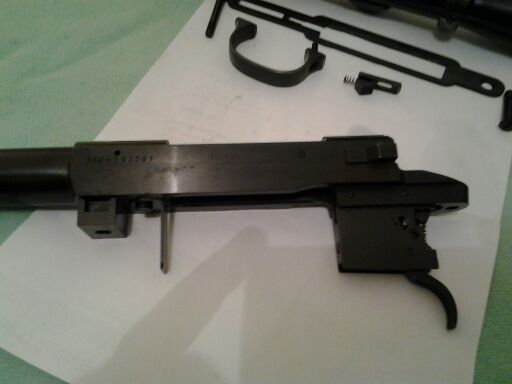

Stripping for clean recrown and tidy up
Post by KWhorenet » 12 Mar 2015, 7:08 pm

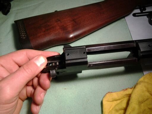

Used up the 78 rounds it came with and decided to strip and inspect before getting the barrel recrowned.
Looks pretty good with only the few minor rust spots to clean off and treat. None that I hadn't already seen which is good.
Cleaning tonight although not as bad as I expected :thumbsup:
Tikka M55 stripped 1.jpg (25.44 KiB) Viewed 12497 times

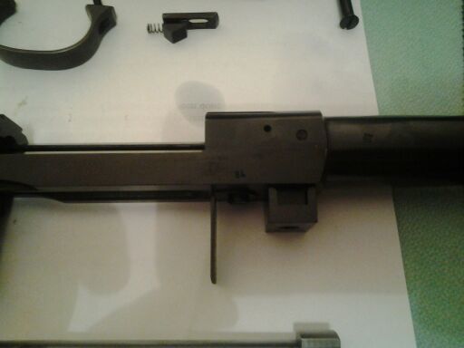

I'm guessing 84 is the year stamp. Being a fairly late S/No for this model it makes sense.
Tikka M55 stripped receiver RH stamped 84.jpg (17.56 KiB) Viewed 12497 times
Tikka M55 stripped rear of receiver.jpg (26.63 KiB) Viewed 12497 times

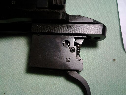

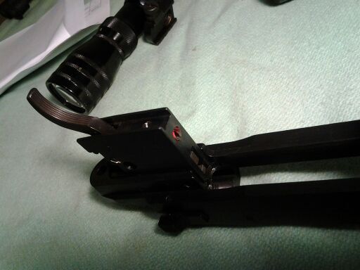

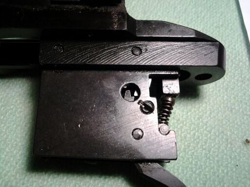

Tikka M55 stripped trigger mech safe disengaged.jpg (35.87 KiB) Viewed 12497 times
Trigger mech seems sound. No noticeable wear or butchering.
Tikka M55 stripped trigger mech safe engaged.jpg (32.13 KiB) Viewed 12497 times

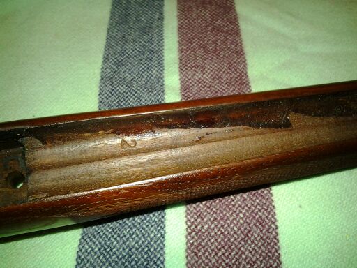

Looks ok. No cracks. Not butchered. Looks like it was coated with a stain of some sort as seen by the splash down the inside. Wouldn't mind chemically stripping and just oiling it one day. Not sure what the stamped number 2 represents: Grade#? Production line #?

Found something odd with the mounts. One had two pointed grub screws, the other used longer flatter tipped grub screws? Either two were replaced or they are meant have one of each fitted, not paired like they were.
One mount also has a bent tensioner stud. Just straightening it gently.

I've never stripped and played this deep on any of my previous toys. It needed some TLC. Glad I persisted with the barrel. It looks like a different beast now with deep grooves and clear defined lands all of a sudden. Well two days on n off deep cleaning :shock:
Fixed the bent stud no worries. Still not sure about these grub screws. Not something google is good at helping me with :O
Two pointed and two flat (look like an after thought or lost replacements).
They are meant to push in against an angled post knob to lock the rings down to the bases and they can be adjusted for 'windage' / alignment. I'm thinking a laser bore sighter would help with aligning all this up with the scope dials both set to neutral.
If anyone has this type set up or seen it any advice on the grub screws in the above pic would be appreciated.
