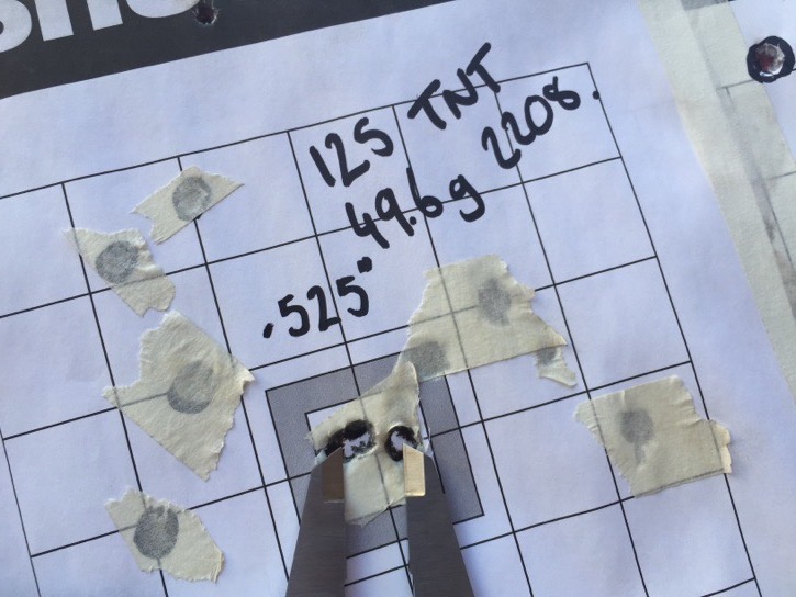

Post by MalleeFarmer » 27 Apr 2016, 8:06 pm
This was a good group for the 125tnt always shot about .5moa I've just worked up a load for 168gr Amax and on my first three test loads I got 1 load at under moa and 2 at under .5moa both had 2 bullets touching and the third about 1/3" away from the other 2. This could be my poor shooting or just need more development. Howa Heavybarrel Varmint .308

Post by bigfellascott » 27 Apr 2016, 11:19 pm
Nothing wrong with that result MF - that will certainly put holes in fur no worries at all.

Post by Gwion » 27 Apr 2016, 11:58 pm
Gotta be happy with that, Mallee!

Post by MalleeFarmer » 28 Apr 2016, 9:59 am
That's what I thought. It's my most accurate factory rifle. Wish I'd bought my .22-250 in the same instead of the M70. Anyway back to the OP I've used both Howas and Tikkas. Howas are cheaper and in my opinion have a better action than the tikka. Perhaps not as pretty but they're a strong action. I don't like the plastic bolt shroud or magazine on the tikka not do I like the 2 piece bolt but they have a lot of lovers. Both will out shoot me and I'd say take the one YOU like best. Probably 2 of the best value rifles available.
